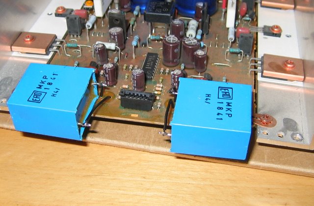

I have a PM17mk2KI and it has a lot of electrolytic caps same as the PM66.
Do these caps need to be bypassed if in the signal path?
auriches said:I have a PM17mk2KI and it has a lot of electrolytic caps same as the PM66.
You don't want electrolytic caps in the signal path. Replace with film caps.
Simon
Try swapping the input signal cap for a Black Gate N or even better a Mundorf MKP. This little mod makes a nice difference.

the input cap is an electroyltic, right?
Thanks AVR
I always make sure the uF of the cap on the amp input is a higher uF than the uF output of the cd player (assuming the cd cap has been changed for a non electrolytic).
Brent
Brent
I have some 3.3uF MKV (polypropylene in oil) I bought from Lee. They're great! Much better than the Black Gate AC I was previously enjoying in that amp.

I was going to change my BG N to Mundorf Supreme Silver/Gold same as the cd player but with moving house thats going to have to wait. I am tempted to swap the BG N for some Mundorf M Cap MKP as I fitted a pair in a Marantz CD6002 and they offered that little bit more everthing over the BG N.

would the mundorf silver/oil type work just as well?

isn't there some dc across those caps?
The caps are for stopping potential dc entering the amps input stage. As standard most devices use 2 electrolytic caps in series and reverse polarity to each other making it the same as a non polar.
