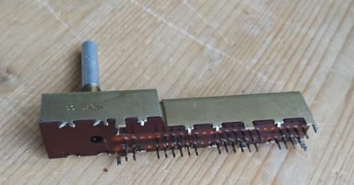

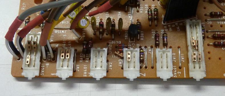

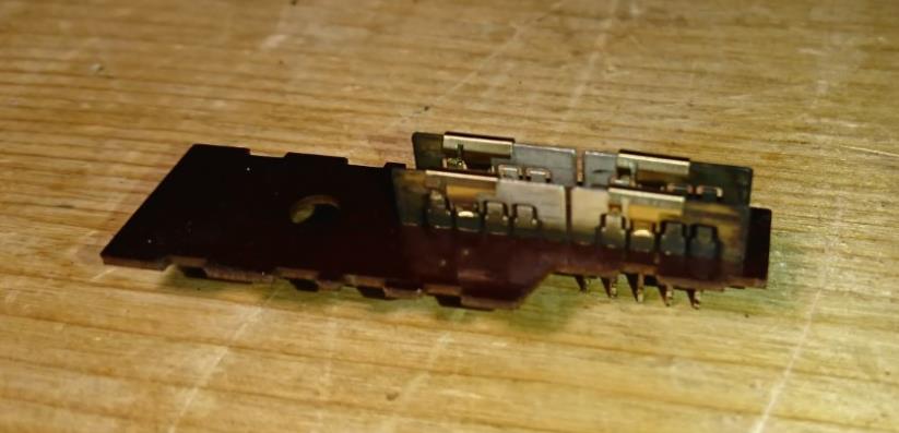

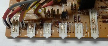

I comment back on this. I sprayed contact cleaner on both slide switches this afternoon. All problems gone! Those sprays are really magical. Thanks for everyone's help and suggestions!
I comment back on this. I sprayed contact cleaner this afternoon on both slide switches.
All problems gone! Those sprays are really magical. Thanks for everyone's help!
Silver tarnishes - most people know that - good silverware does, silver bowls, pitchers etc.
Same goes for those blasted silver plated contacts.
Almost any metal, exposed to the air does.
Better to use something non-tarnishing like gold or rhodium - less problems.
