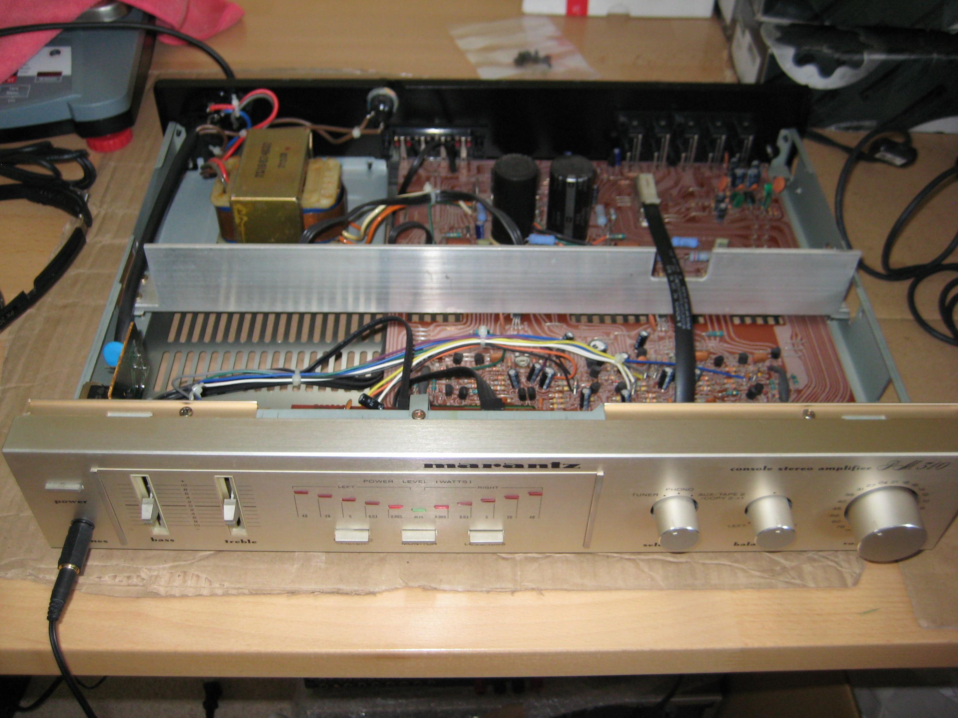

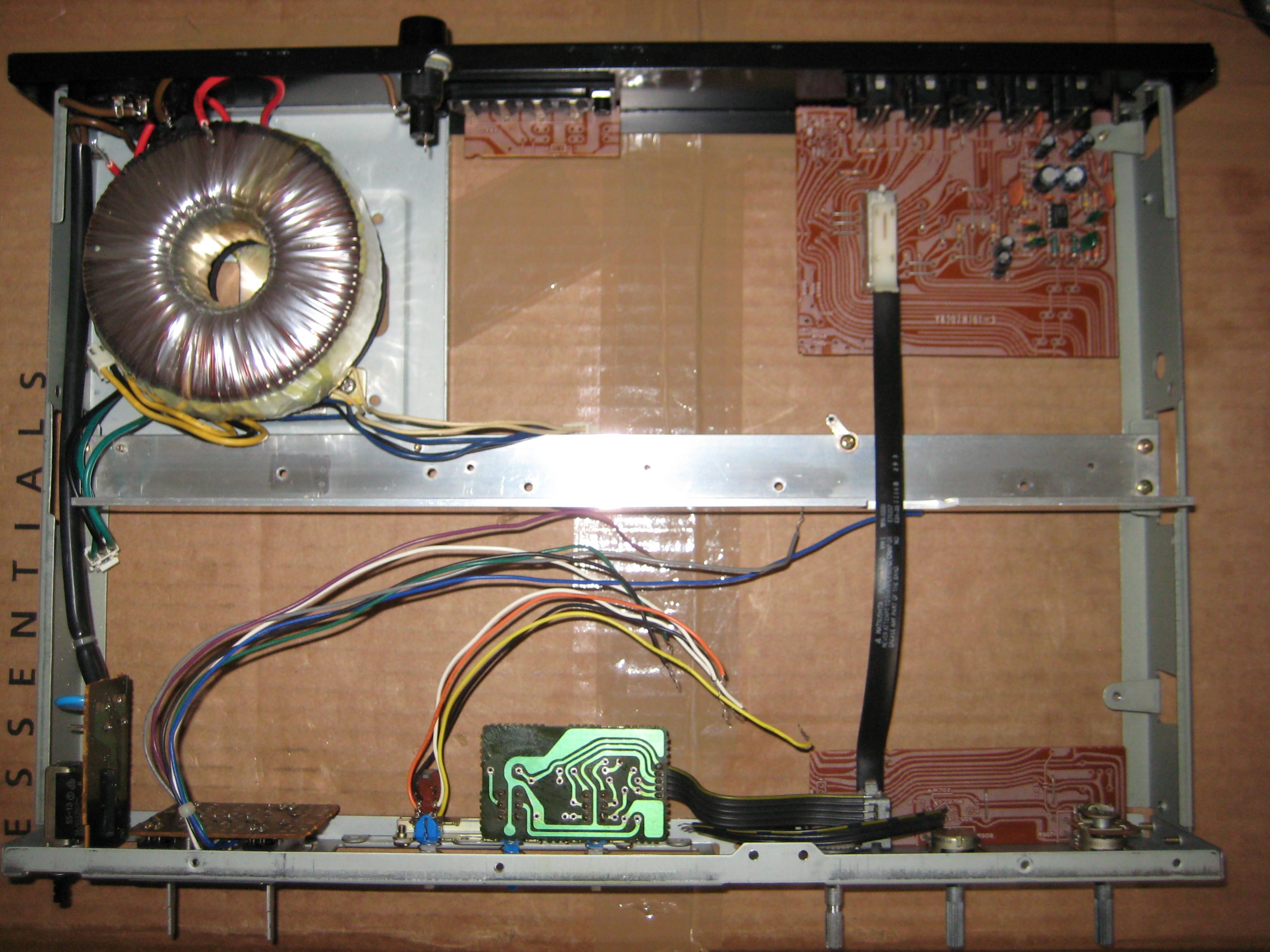

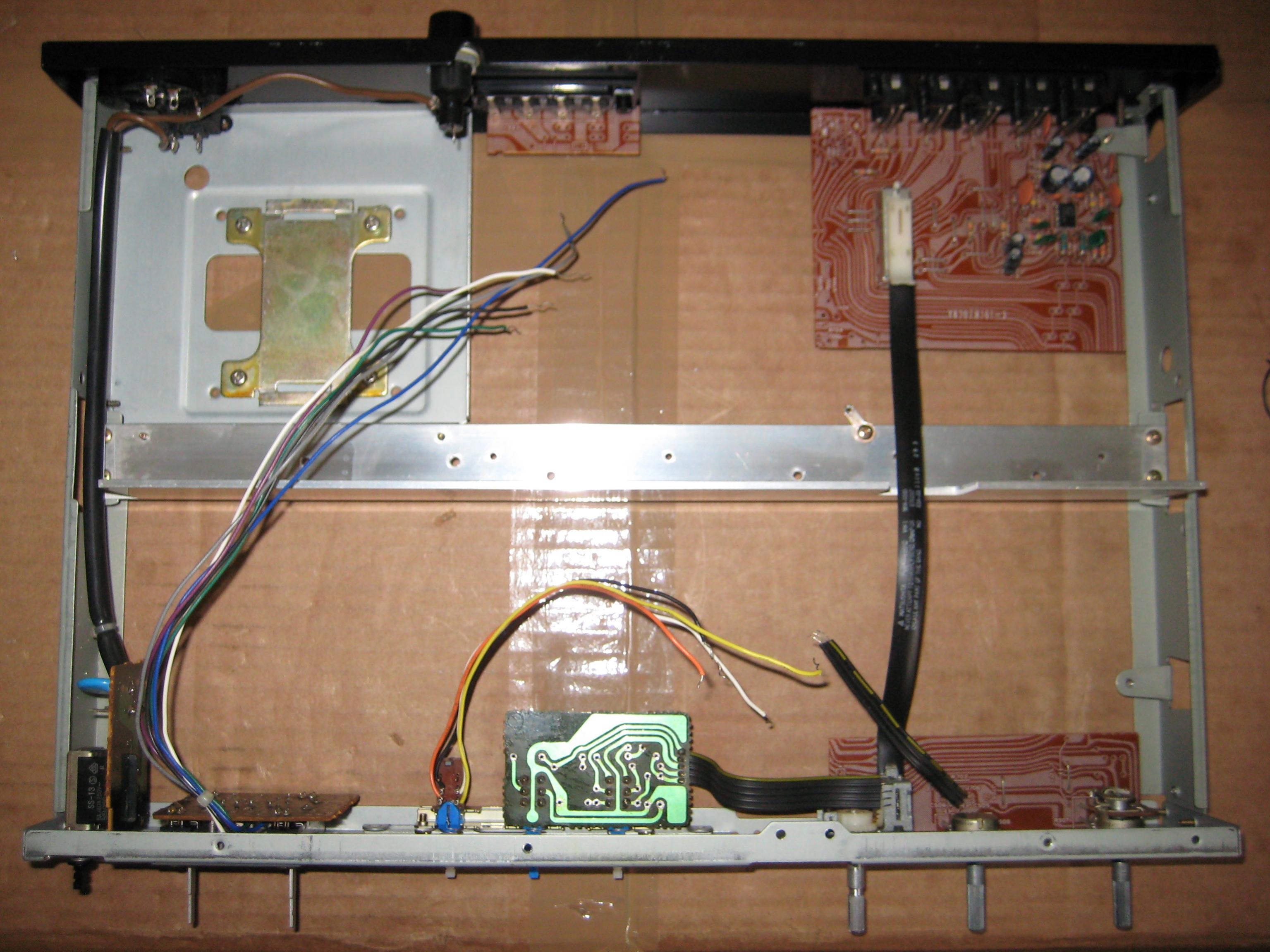

The main power supply is in place - smoke tested, all fine. No turn-on thump at all.
I've also upgraded some of the components in the phono stage. Need to get a few more resistors as I didn't have those values.
Next step is to design the DSP board and the analog power supply board. I've already made a good start on it, some schematics to follow in due course...
The small USB input board has now been mounted at the rear. It's based upon an SA9023.
