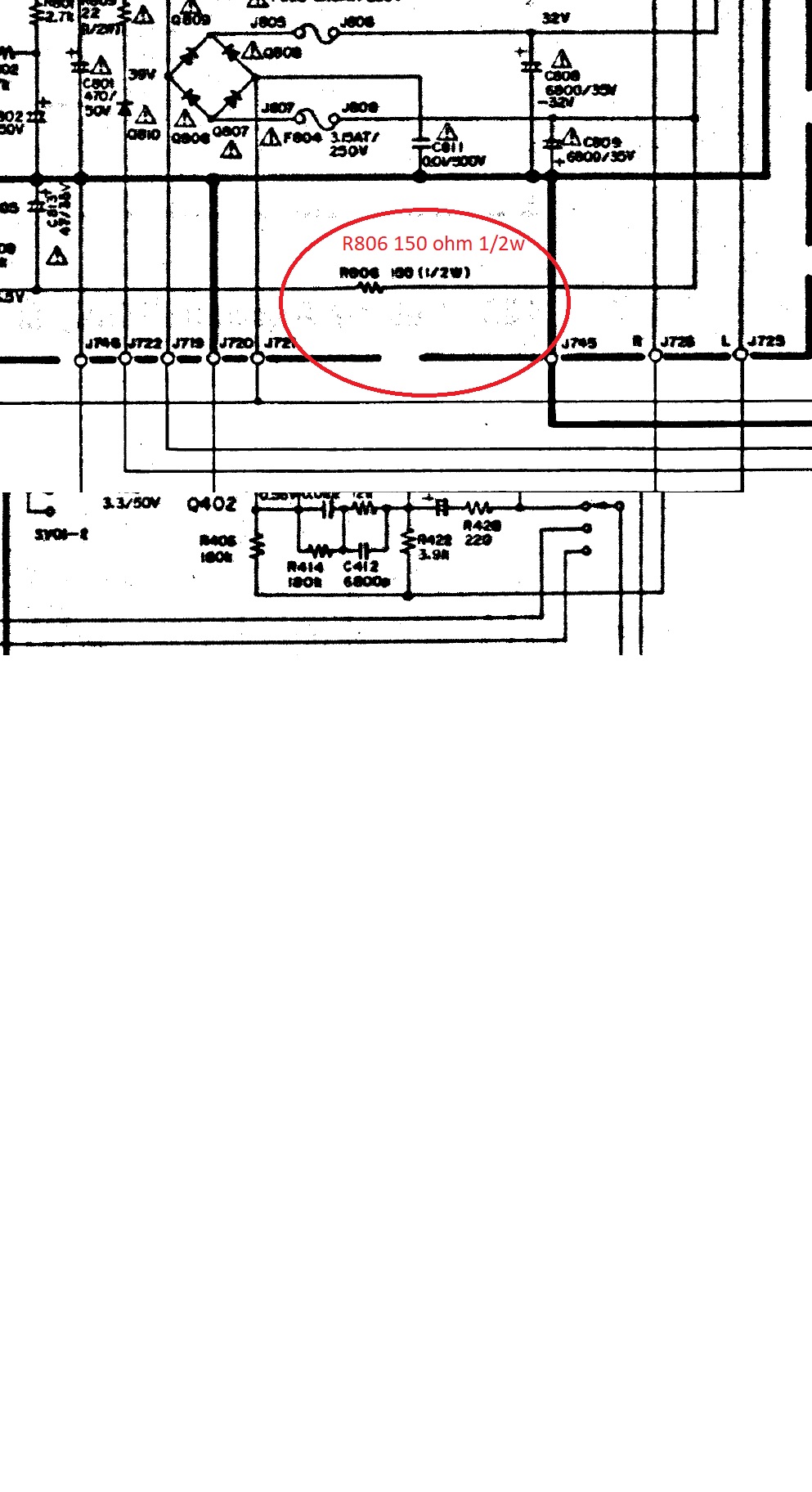

I have a working unit im looking at and it has a couple of items i am going to look at but havent come across yet and thought i would see if you guys had any ideas before i started.
sound is generaly ok, and not distorted at all, but the levels are lower than what i would expect.
tone controls appear to be ok.
loudness doesnt seem to have any effect.
when volume is turned right down you can still hear the slightest of sound.
when you turn balance left to right and visa versa you still have sound coming out of the opposite one, not fully, but noticible.
There isnt any problem with the phono/aux/tuner switch so thats ok
im thinking it might be something to do with the fact it has mic/source mixing
when you turn that down to source only with the tape/source switch in 'source' it seems ok, but if you turn it to tape and leave the switch as it was, you can still hear it,but at a reduced volume(unless its supposed to be like this)
im just starting to go through the schematic, but the quality isnt brilliant
the amp is pretty dirty inside and i will clean all the switches and pots as this may be having some effect.
could this just be poor/failing caps??

Your description sounds like what is called crosstalk, and it is pretty common in older amplifiers and amplifiers in the lower price ranges. Expensive high end amplifiers use a number of strategies to reduce or illuminate crosstalk.
Crosstalk generally has two sources:
  1. Capacitive coupling between two sections of the amplifier, like one input to another input. This is reduced or eliminated by screened cables in wiring and by guard tracks on PCBs (a guard track is a ground track between two signal tracks, to shunt stray capacitive signals to ground).
  2. Common ground wires or tracks, like between the input connectors of two different inputs to the circuit board or selector switch. Common grounds will have the return currents for all of the signals going through them, and current cannot flow without some voltage drop, so these common grounds introduce a small voltage from one circuit into the other one that shares the ground.
This can be corrected sometimes, but if the common grounds are on the circuit board it may mean cutting and rewiring the tracks on the circuit board. Often hum and ripple noise gets into the audio if any of the supply currents flow in tracks used for signal ground, and can be fixed the same way.
The balance control is a slightly different problem. Each end of the control needs to be a very low resistance to a good clean audio ground. Even a tiny resistance here will stop the panned out channel going to complete attenuation. It's probably possible to fix this too. One thing to try first is just to clean the control with DeOxit. A small amount of contact resistance at the wiper of the balance control will also cause this fault.
I just had a look at the service manual and there are common signal earths everywhere, including to the balance control. Sadly I think the crosstalk in this amplifier is not going to be easily sorted out. The manual quotes "intersource crosstalk" as -55dB, which is really quite a poor specification. I decent figure would be >80dB.

not having alot of luck with this, but only just started again today looking at it.
grounding seems good, there is good continuity to the chassis from the board in all the places i have checked
not too sure where to start with this one TBH
the drawing is quite hard to read because of its poor quality, but this is the resistor that failed and i replaced/solved the whole problem.
