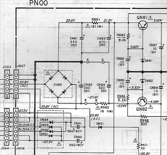

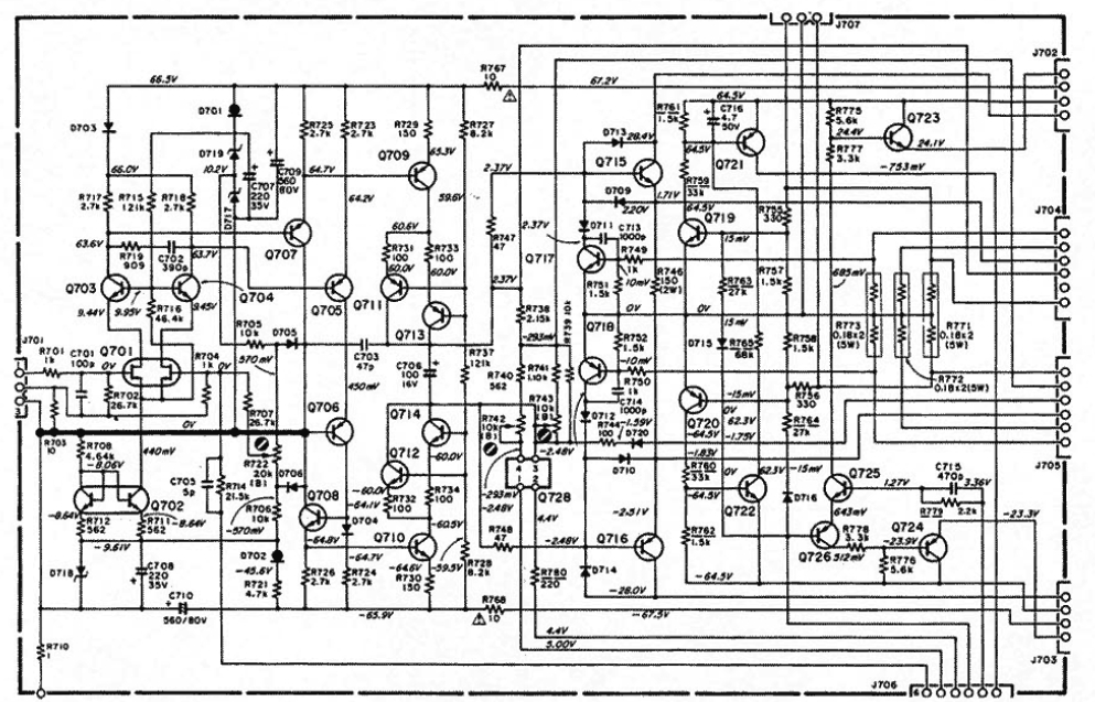

I've comared the two side of the power amp.
I realised, that the D701, D717 and D719 is wrong. The two zener don't stabilize the voltage, but I don't know, what is the other diode. The revere and the forward voltage is about 300mV in the good side. In the parts list, this diode is a 10YD4.5c, but I didn't find that device on the net.
Could You help me, what is this dide?

Here is:
Constant current diode - Wikipedia, the free encyclopedia
4.5mA such as semitec e-452 or centralsemi 1n5313 (4.3mA) ... maybe work?
