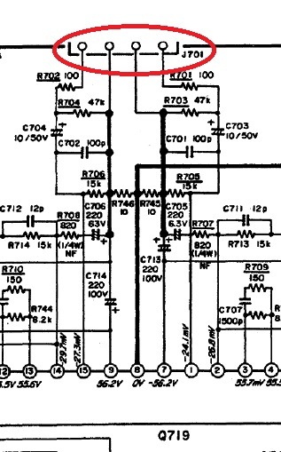

Pin 6 is the left output and is good. Pin 10 is the right output and you can not measure something decent.

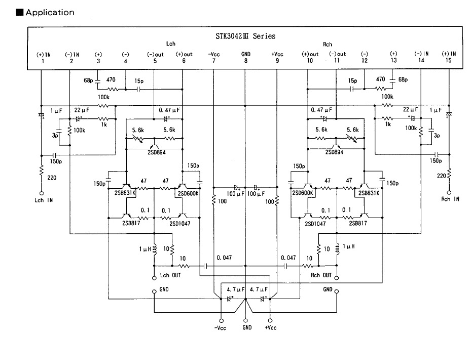

They only thing left is to take out the STK and see if pin 1 & 15 give the same readings.
If they do, I think the STK is broken. Refer to the schematic in post #2.
Pin 1 - 6 is for the left channel and pin 10 - 15 is for the right (bad) channel.

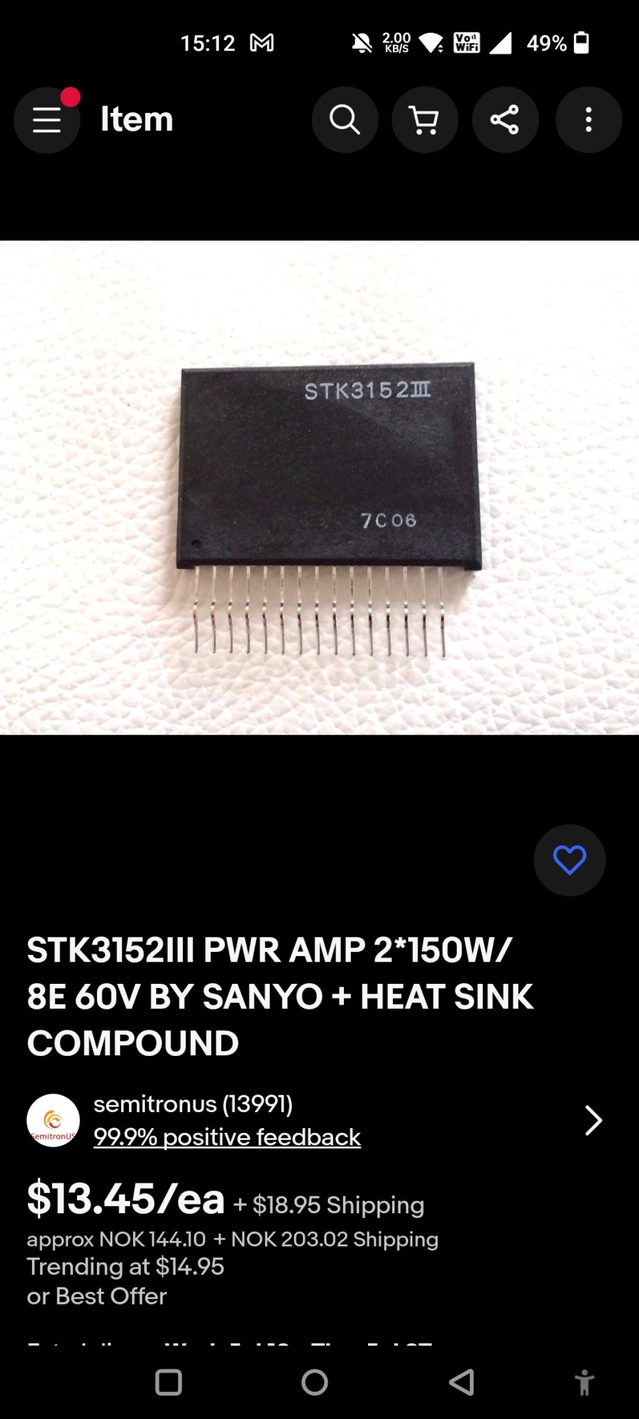

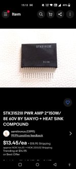

I ordered from ebay stk 3152 III

Little update.
The stk i ordered first was returned to sender , for some odd reason and i was refunded.
I did find stk 3102 iii from a closed tech shop , and my Marantz is up and running.
