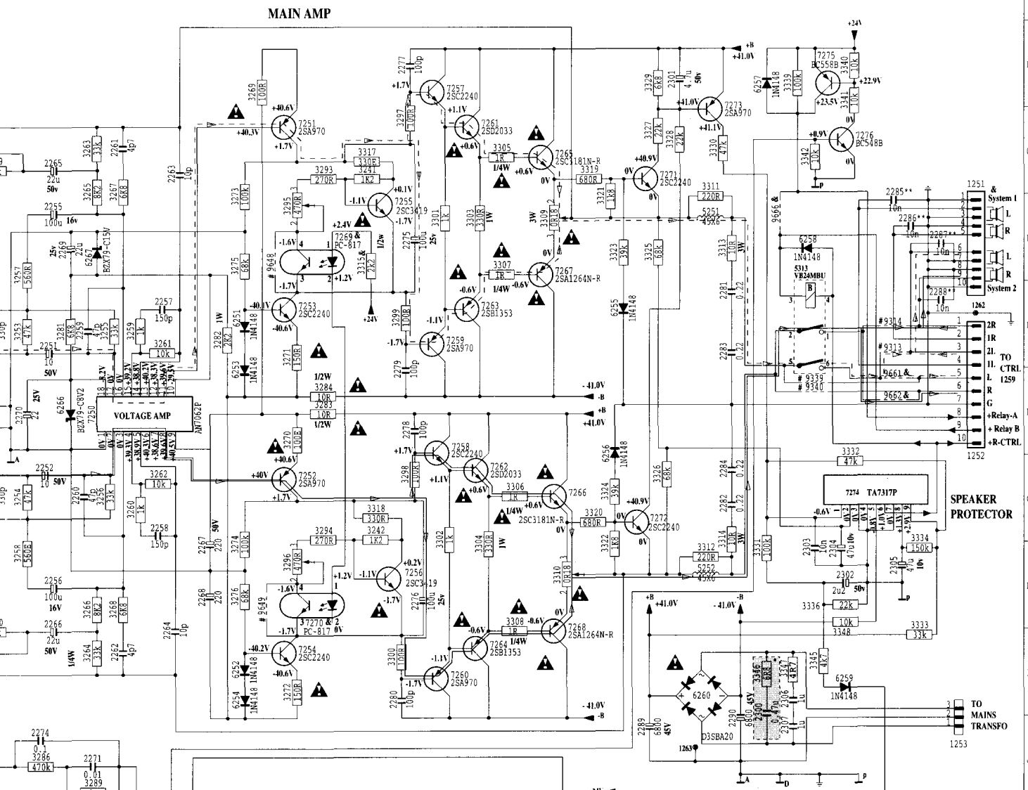

Hey all, I was wondering if someone could help me diagnose a broken PM-57 amplifier.
the power light comes on but its stopped working, no relay click, no nothing, I opened it up and using a thermal camera I noticed that the 2SB1353 transistor was very hot and then that resistors 3302(1k) and 3304(330R) had burned out, I also noticed that the two caps were bulging so i replaced these components (except the transistor) and powered it back up to see smoke coming off the board.
can anyone recomend the best procedure for fault finding this amp without damaging it further, I have a scope, frequency generator and multimeters but haven't had much experience with amplifier repairs.
Thanks in advance,
Tim
I can't help with troubleshooting, but schematic is attached that includes expected voltages. The components you mention are associated with the output driver transistors. I have one of these that it still working well after more than 20 years.
attachment.php
