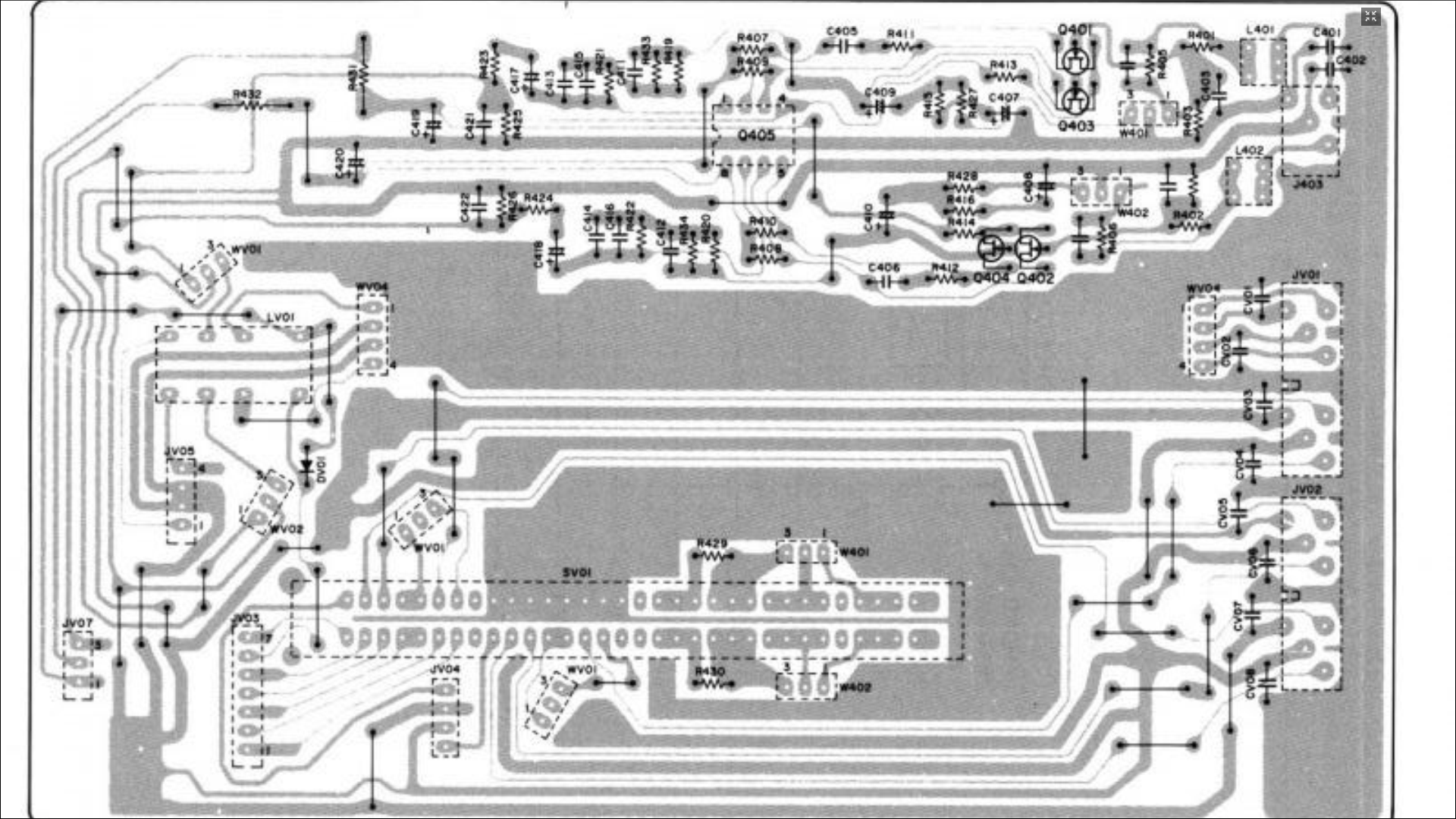

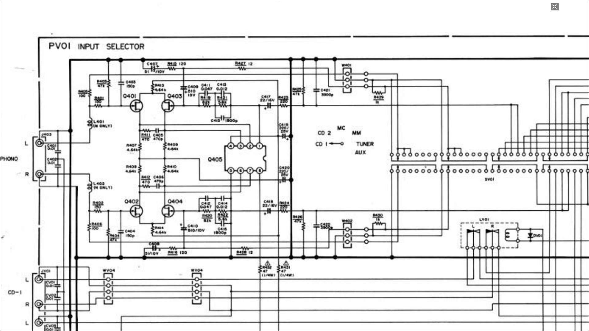

I've had problem with non-working phono amplifier. Capacitor C409 and C410 were swollen and there was cold joint near transistor Q401 - I replaced Q401 and Q402 with place.
Phono is working now, but there is problem with MC hum very similar to Brown noise on left channel (upper track on schema where Q401 is). On MM there is very little noise, but where volume knob is near 80-90%, so it's acceptable.
What I have done to this moment?
I replaced resistors R431 and R432
Solder again all joints for this channel from schematic
Replacing with the places all transistors Q401,Q402,Q403,Q404 left to right etc.
RCA terminal is ok.
Recap all others electrolytic capacitors.
Could it be problem with opamp NJM2068DD? Other resistors may generate noise? I have no idea and any others clue what it might be.

If the problem is hum, the opamp or resistors won't be the problem. Try exchanging left and right phono inputs to confirm hum problem is within the amp. Inspect wiring, soldering between board and RCA jacks.
NJM2068DD is the opamp in the phono preamp (Q405)?

As a test to identify path, try removing L401. Any improvement? Maybe a second experiment would install short jumper from junction of L401 to resistors ? and ? (too fuzzy to read) to heavy ground trace.
I should have asked at the beginning--- were you hearing good audio but with added hum? Or no audio at all but only hum?
On opamp Q405, would you measure output voltage on pin 5 (working channel) and pin 1 (bad channel)?

I've got new (from my friend) opamp NJM2068DD. We resolder it to my board and there is no hum. One more check with my old opamp and humming started again in left channel.
In summary, I have to order a new opamp. Do you recommend another one or better to stay with NJM2068DD?
Excellent! I surmise original must have failed and must have passed power supply hum into signal path. I erred in claiming opamp would't be at fault. 😕 Interesting that other half still worked.
Data sheet says that original NJM2068DD is very fast and has very low distortion. Your post seems to suggest you were given same type from your friend--- am I missing something? I'd stick with original part, though the friend's part might be fine. Can you clarify?
