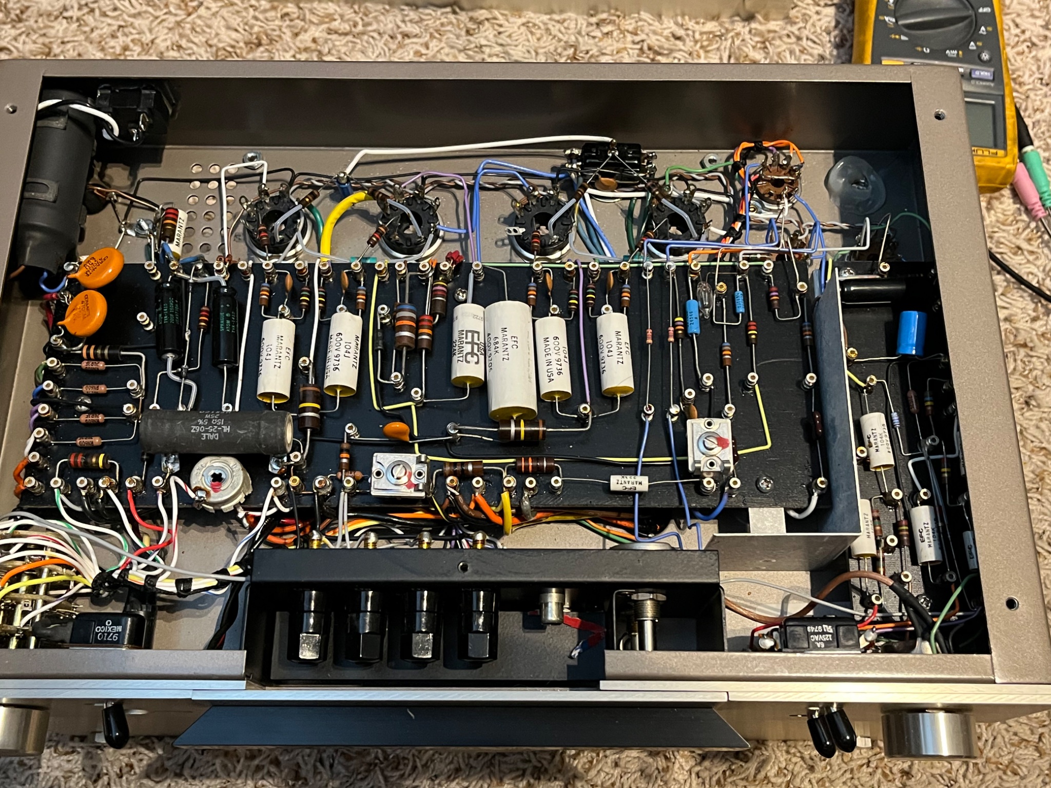

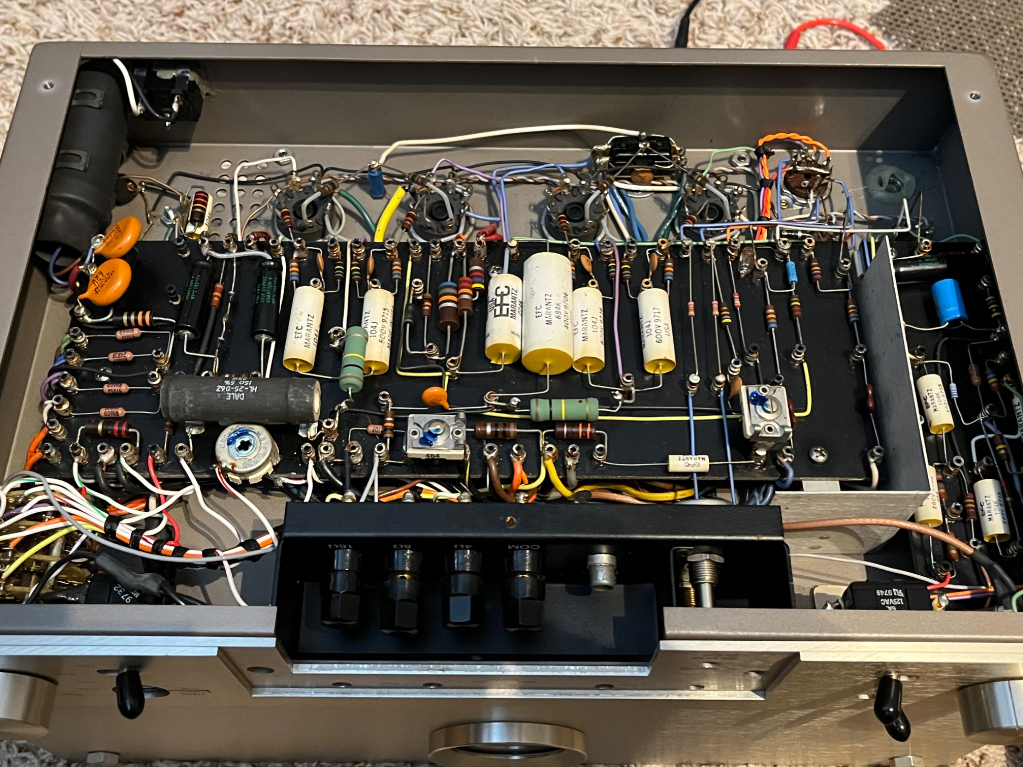

I noticed something odd. In the never-used Marantz Model 9, I found a capacitor of unknown value in place of the R23 39K resistor. Everything else in all three Marantz Model 9 amplifiers is identical. The soldering and component positioning are so neat that it appears this modification was done at the factory by VAC.
Otherwise, the Marantz Model 9 units all seem to have the following capacitors: C6 (250µF), C25 (10µF), C29 (20µF), and C30 (20µF). I assume C26, C27, and C28 are the filter capacitors. What is the tiny blue capacitor shown in the attached pictures? The capacitor appears to be attached to a 220K resistor which would be R15 or R95. I assume this electrolytic is C8 0.22uF 400V which is a Mylar capacitor in the service manual. Can someone check me on this?
The writing on the tiny blue electrolytic capacitor is just a code that yields no useful information in a Google search. Unfortunately, I cannot find my Fluke 289 multimeter, which could have measured the capacitor's value.
Additionally, in the two Marantz amplifiers that are in use, someone has definitely replaced the two 100-ohm resistors. However, everything else appears stock, and all resistors measure within their tolerance.

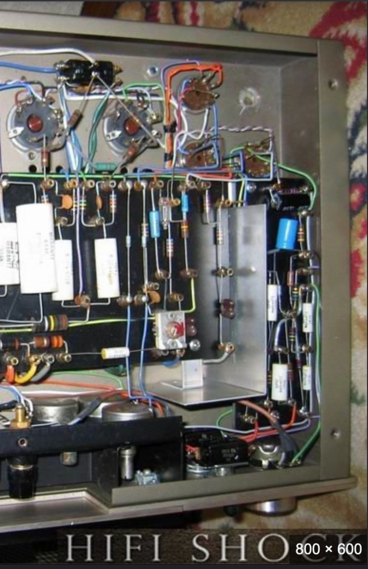

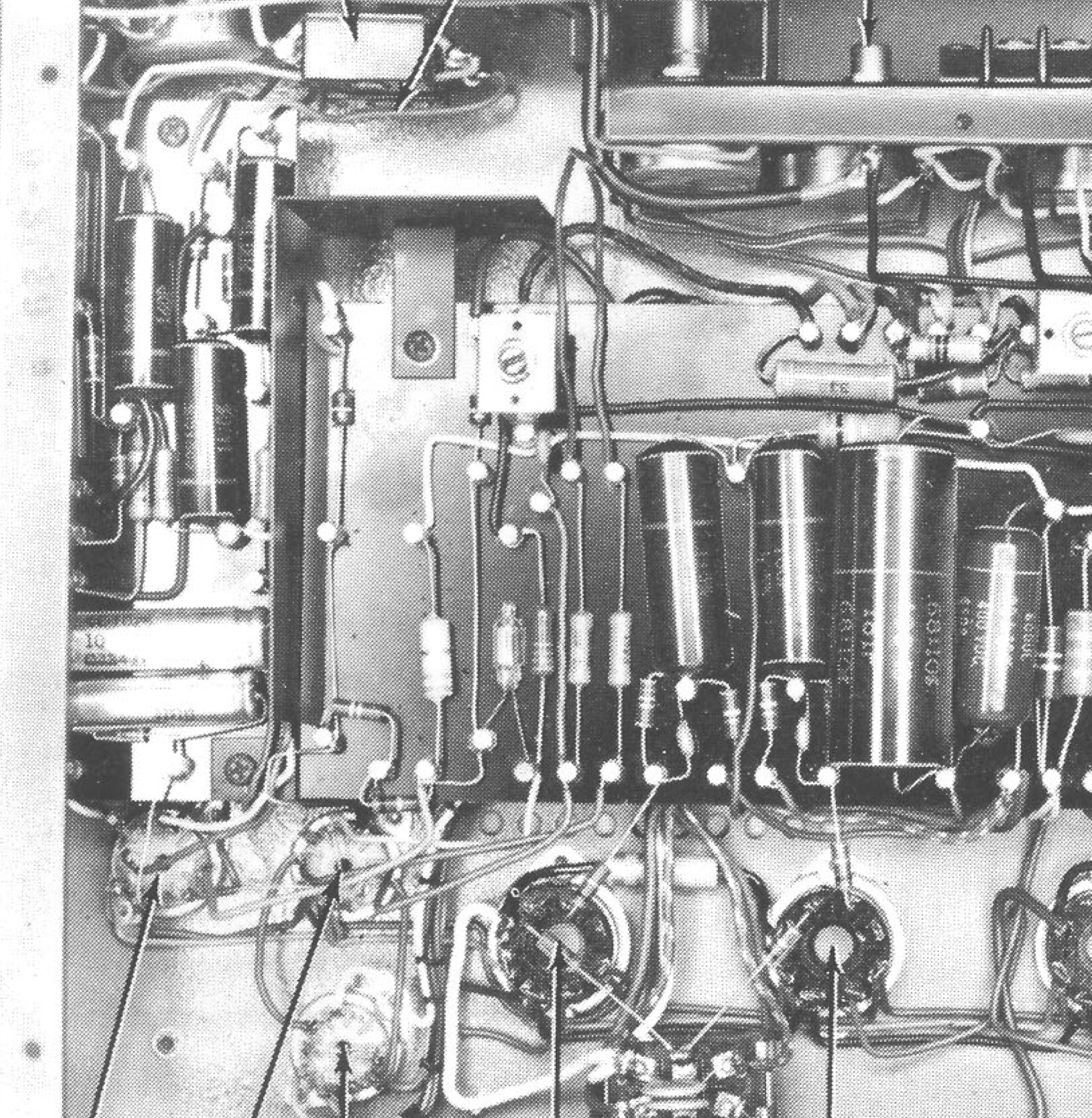

Actually looking at the photo in the service manual that tiny blue capacitor did not exist in the original. It was just straight wire, so VAC must have added it for a reason.

Must have been running changes. I see variance in the original Model 9's too browsing images online. Also, this is clearly not a mistake, found another reissue online with the same capacitor setup.
Don't really need any additional help then. This was by design and someone else wasn't in there making wild modifications. I'll just need to figure out what's in there or reach out to VAC.

So I have known for quite some time that those blue "capacitors" are actually resistors and they are all per the schematic. First time I have ever seen a resistor look exactly like the small blue capacitors so often found in 80's gear.
