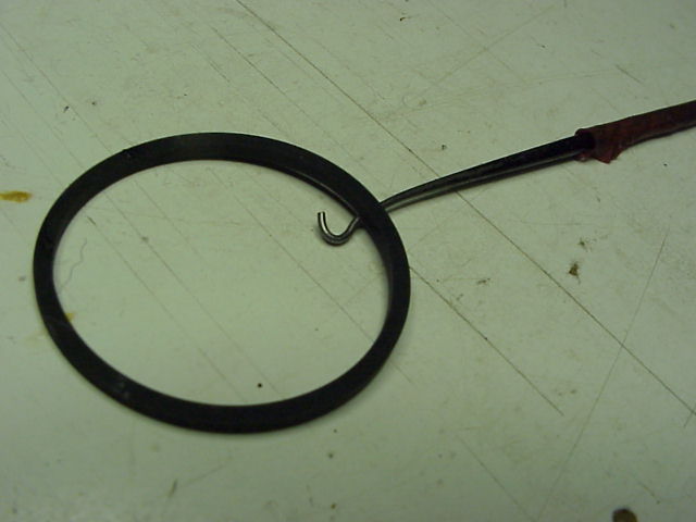

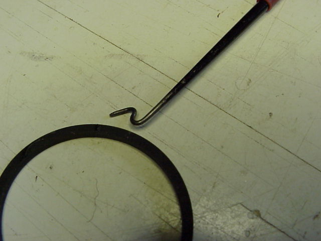

Can you provide a few pictures?
Here's a little incredible nifty tool to replace belts.
/Hugo 🙂

Hi Netlist,
That looks ideal for the job. Where do 1 get one of those?
