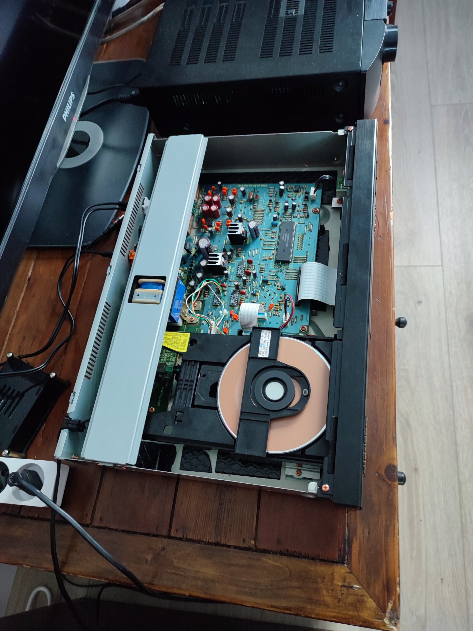

Then I will name mine "Sleeping Beauty" as it seems to have been forgotten in its box totally clean and virgin until last year when I found it.

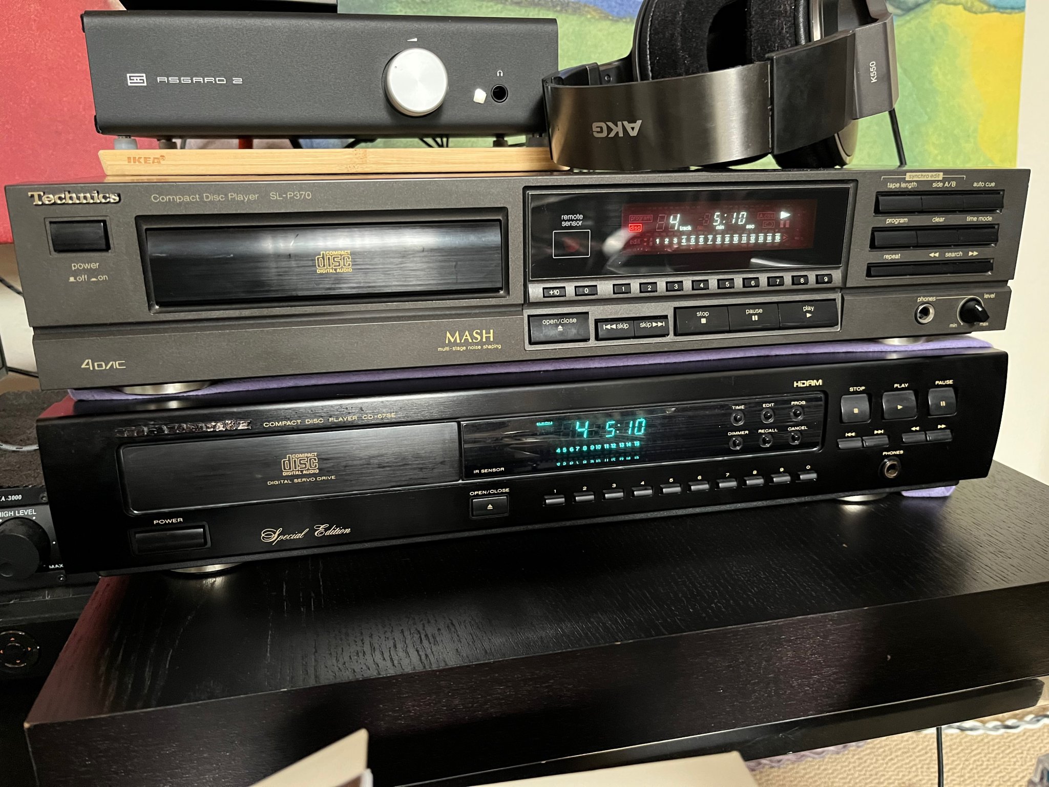

I had pretty low expectations for my 1994 SL-P370, and it sounds a bit splashy while tolerable. The 1997 Marantz CD-67SE is obviously nicer in every way. I bought them both only last year for their good track displays and headphone outputs, but I expect to use them with a DAC. Pretty sure I can add a Toslink output to the Technics in the empty spaces.

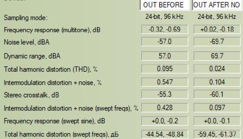

Sometimes changes are measurable - RMAA results of one amplifier form 70-ies after replacing all electrolytic capacitors (except the big ones):
RMAA can also be used for measuring cd-players output signal.

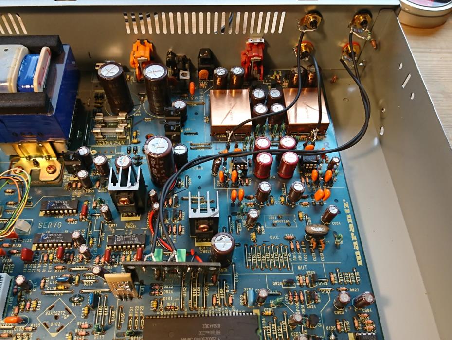

But when changes are small then these measurements show no difference and one way of doing a comparison is to put out both the initial and modded signal(s) and swap between them during live play. This test rig of mine (I used it also for testing different opamps) has 3 signals out: HDAM, pre-HDAM (like CD-63) and NOS-DAC (added):
