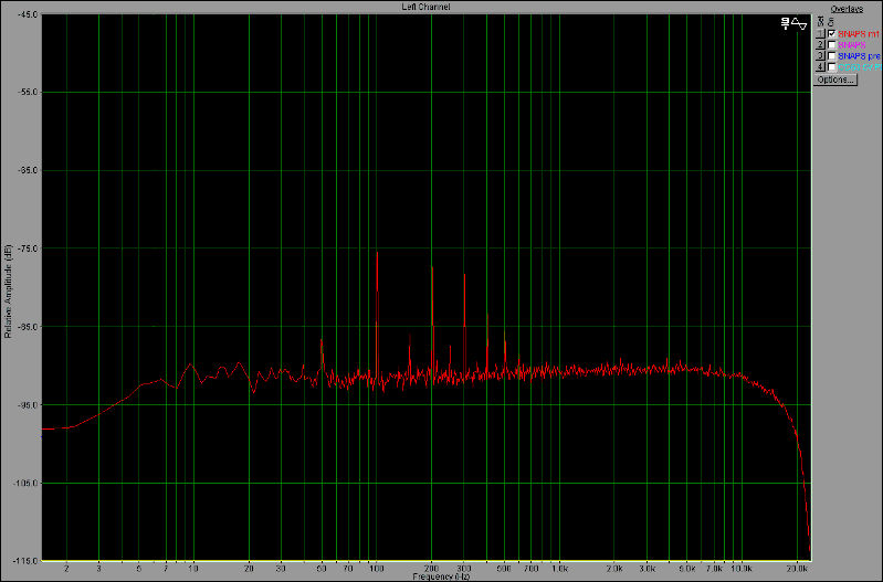

Ground planes are an interesting question - the clock supply wasn't quite as quiet as I'd have liked, and I suspect this was due to the ground plane being used for all 0v returns. At these levels everything has finite impedance, even a big ground plane. Current flows in this can give rise to noise, but are beneficial to many devices, particularly digital.
What I'd do in a new design is use the ground plane as the return for all decoupling, but have a seperate Kelvin sense ground, configured as above - consider the ground plane as a star point, but keep 'GNDA' seperate and close to the device it's connected to.
I'm not kidding w.r.t. sensitivity of regulator noise - just 1mm (!) away from the Kelvin sense point on a track with current flowing in it is measurably noisier than at the GNDA point. On a mains-based PSU it manifests itself as harmonics of the charging pulses flowing in the smoothing capacitors (50 / 100Hz in the UK, depending on 1/2 or full wave rectification).

Imperfect Kelvin sensing
Here's what you get, from a mains-based PSU with the Kelvin sensing of an LM317 all wrong.
In this example it's returned to the 0V of the smoothing capacitor after the rectifier.

Improved Kelvin sensing
Here's an improved wiring scheme ,on exactly the same PSU - not quite perfect, but dramatically better.
The Kelvin sense point is now returned to a clean 'audio' 0V star point at the o/p socket of the PSU (where the connected equipment 'sees' the PSU).
It still has a return back to the main 0V star point at the smoothing cap, but the noise change is obvious.
The regulator is now regulating at the point of interest, i.e. where we are connecting to it - the connected device doesn't care what goes on inside the box!
