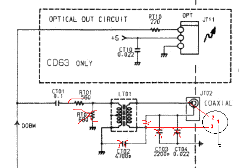

I'm wanting to perform this mod to my player so that I can interface it with my DCX2496 using AES/EBU digital interface.
On the current digital output stage of my player, I'm having this thought.
RT01 and RT02 seems like a voltage divider to lower down the voltage suitable for spdif. Since this is AESEBU which requires full +/- 2.5V pp, I would think to bypass RT01 and remove RT02.
Output from the LT01 goes to pin 2 and pin3 of balanced output with pin1 to ground.
Remove all other unnecesary caps of CT02,03,04.
What do you think? Will it work?

Thanks for your response. I was intending to connect to the DEQ2496 first, only then DCX2496.
To mod the DEQ to input and output coaxial SPDIF, I don't have the knowledge, and I try not to use toslink from the cdp to the DEQ.
cheers.
simply make the rca to xlr adaptor suggested in the hand book ....
rca signal to pin 2 xlr ...pin 1 and 3 to rca ground.
this works very well and I use it to feed my deq from a quad99cdp2...but I hear you say thats not got a digital coax output ...well I fitted one of those too....[dead easy!]
