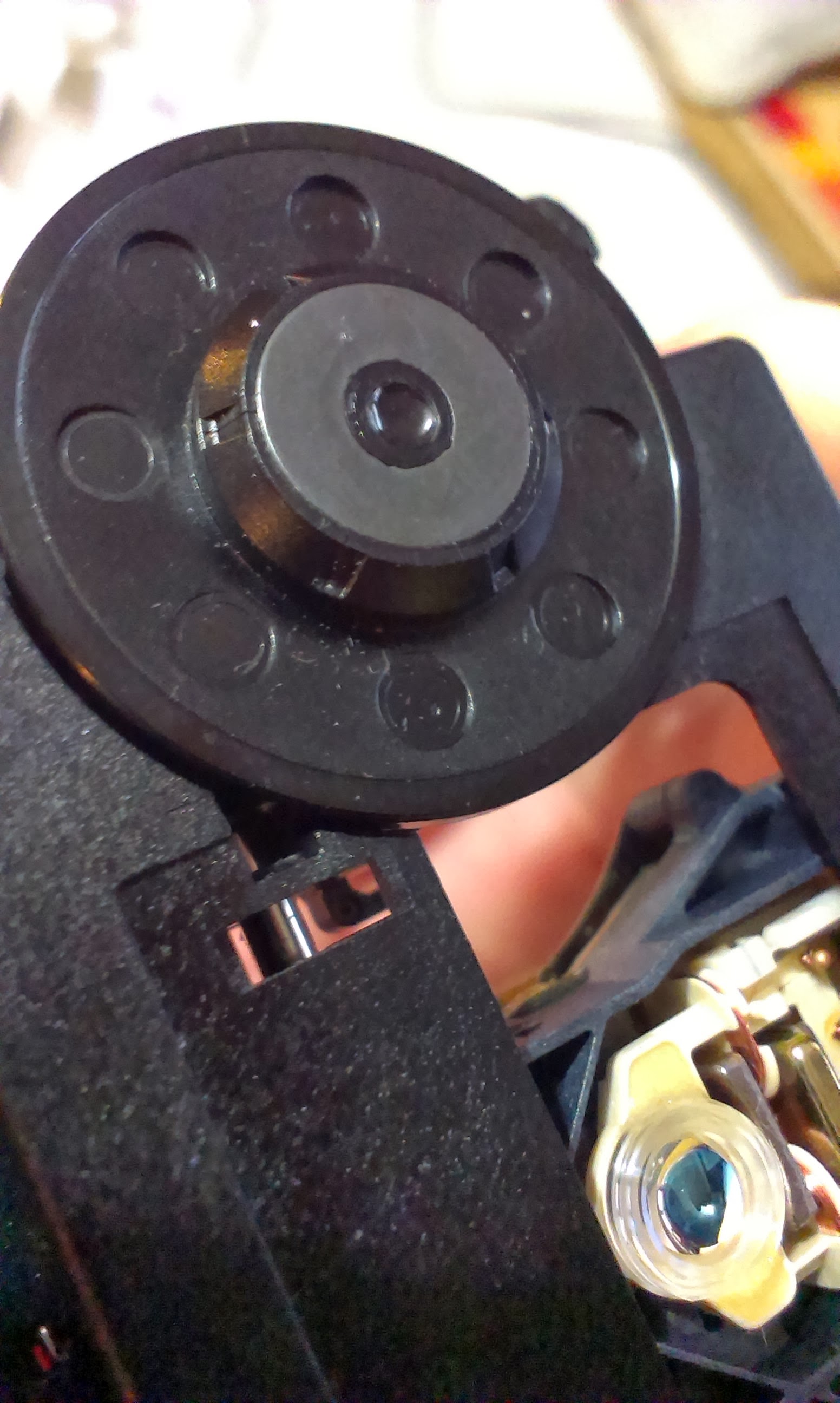

It is "fixed" by a blob of "glue" which you can see on the top of the cone. I have had one where the glue was missing and the cone pushed right down (binding).
The cone just looks like this (attachment). Just a black indented bit in the centre.
I still suspect mechanical problems - I seem to get skipping at the same point around 10 minutes into the disk, as if the laser is getting a little bit stuck on the metal rod. Still I don't really know enough about how it works, just that initially lubrication was required for the unit to even work at all.

The cone is slide fit onto the motor spindle. It is a bit tight. What you need to do is to use a small screw driver inserting into the cone's gap and force the cone out a bit. If it is too much press the cone down by your finger.
If your CDP skips always on the same position it appears to me that something has blocked the laser head's slide smooth movement. It is most likely caused by hardening of the grease on the gears or along the sliding rod. I also encountered similar problem before and I just disassembled the sliding mechanisms and the gears out, clean them with highly evaporated solvents (like contact cleaners) and re-grease the moving parts. Problem solved.

That black blob in your picture is the glue.
Its worth looking at, and cleaning all the teeth on the gears. The large gear is a "clip fit" on the spindle so should come off easily. Also clean the worm gear on the sled motor. The only lubricant I would use is a special plastics grease like this,

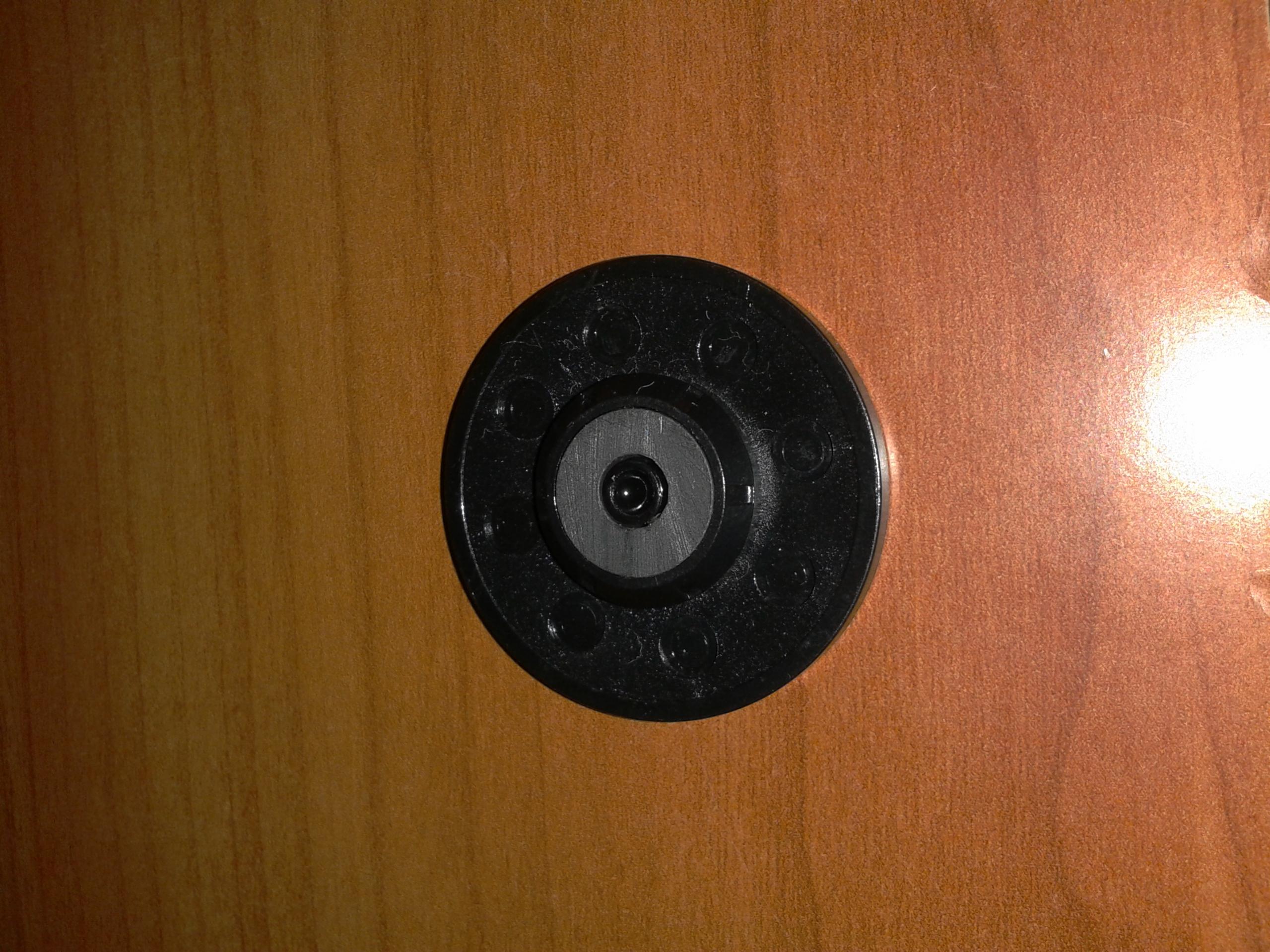

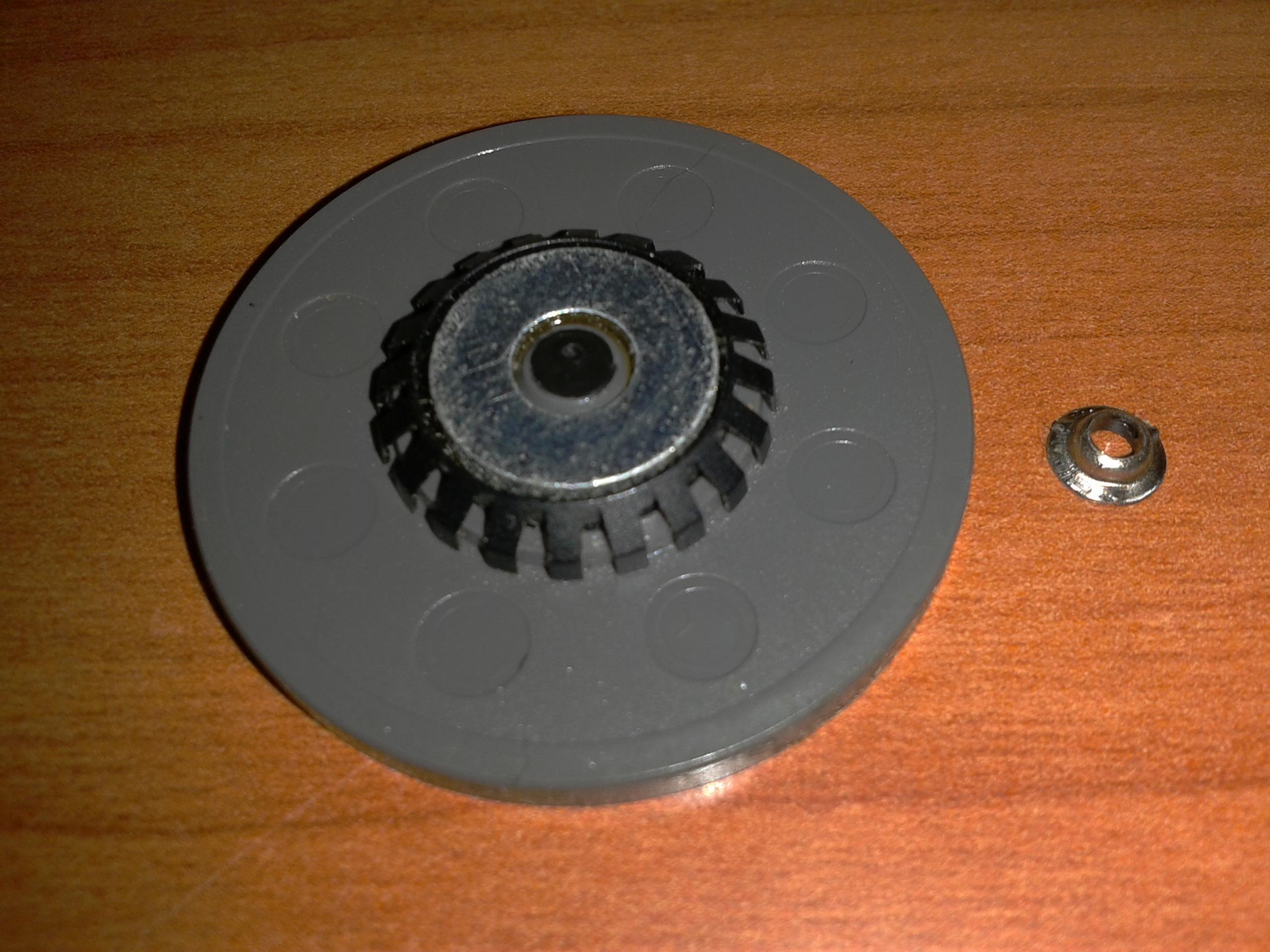

20131015_221200.jpg This is the clamp off an original Phillips laser mech. 🙂
20131015_221042 (2).jpg This is off a Chinese copy. :sigh:
The small collar next to the original goes onto the spindle first, stopping it going on too far. It fits upside down to way shown. Fat part uppermost. Chinese laser doesn't have one.
I had trouble with discs not reading and wobbling so much that you could hear them scraping. 😱
The magnet in the original is also much stronger. :spin:
Swapping them over made a big difference. 😉

It is not only the magnet that differs, the taper angle of the top part of the cone is also different making the new one not fit onto the top rotating disc. If you try the service mod and make the cone rotate forward and backward you will find the new one slips when rotating !!
I normally remove the old cone and put it onto the new VAM. This will grip the rotating disc firmly without slipping.
