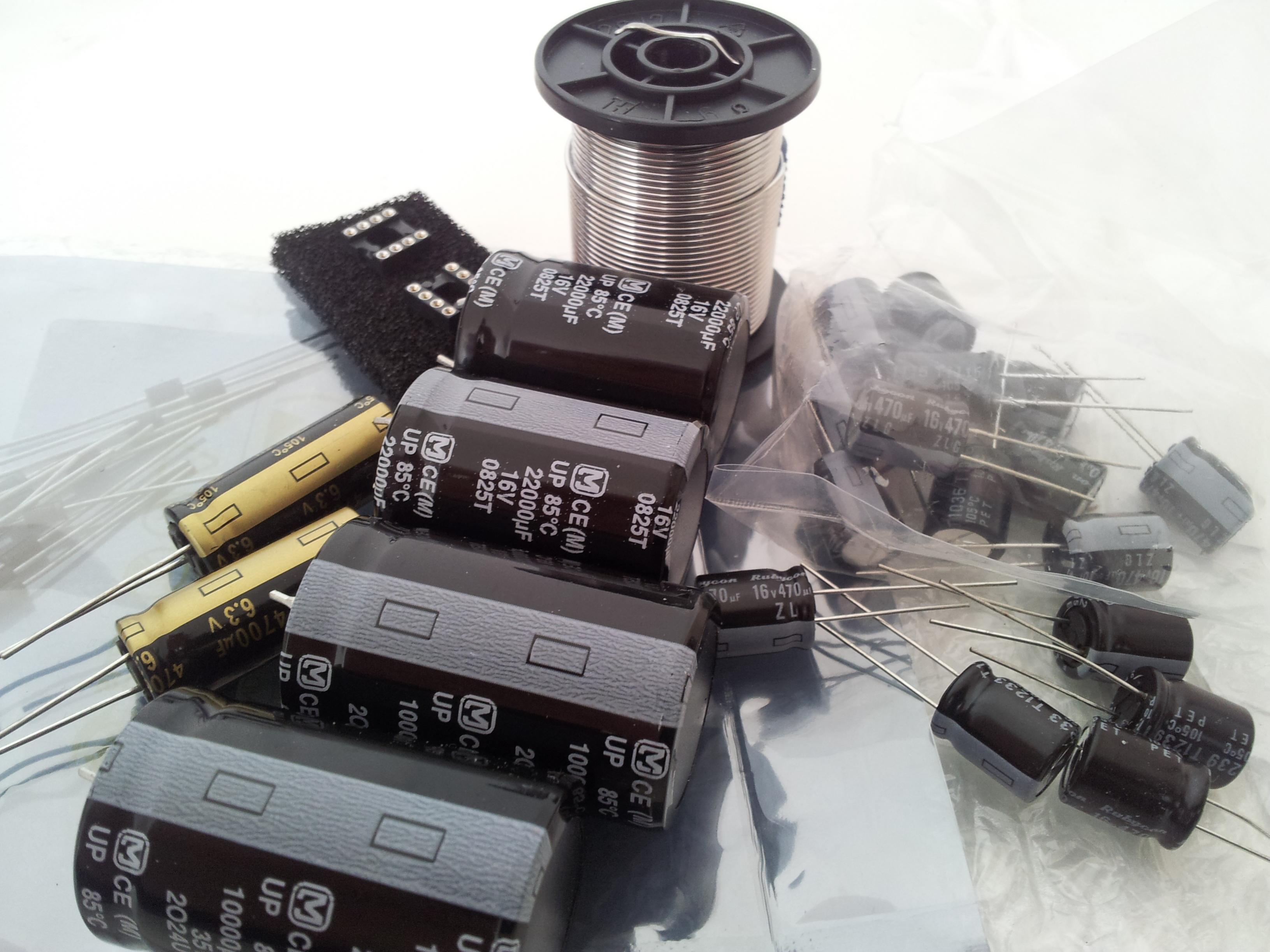

Upgraded the PSU today. What I did was:
- replaced rectifiers with schottkys
- C803/C804.................Panasonic TSUP 10000uF/35v
- C805/C806.................Rubycon ZLG 470uF/16v
- C813/C814.................Panasonic TSUP 22000uF/16v
- C815.........................Panasonic FM 4700uF/6.3v
Forgot to bypass the fuses. I'll do that next time I open the player.
First impressions: No revelation but slight improvement in sound and the player seems to run and respond better. The sound is a bit cleaner and more depth to the soundstage.
I will let this burn in and settle for the next few days, before I upgrade more caps.
