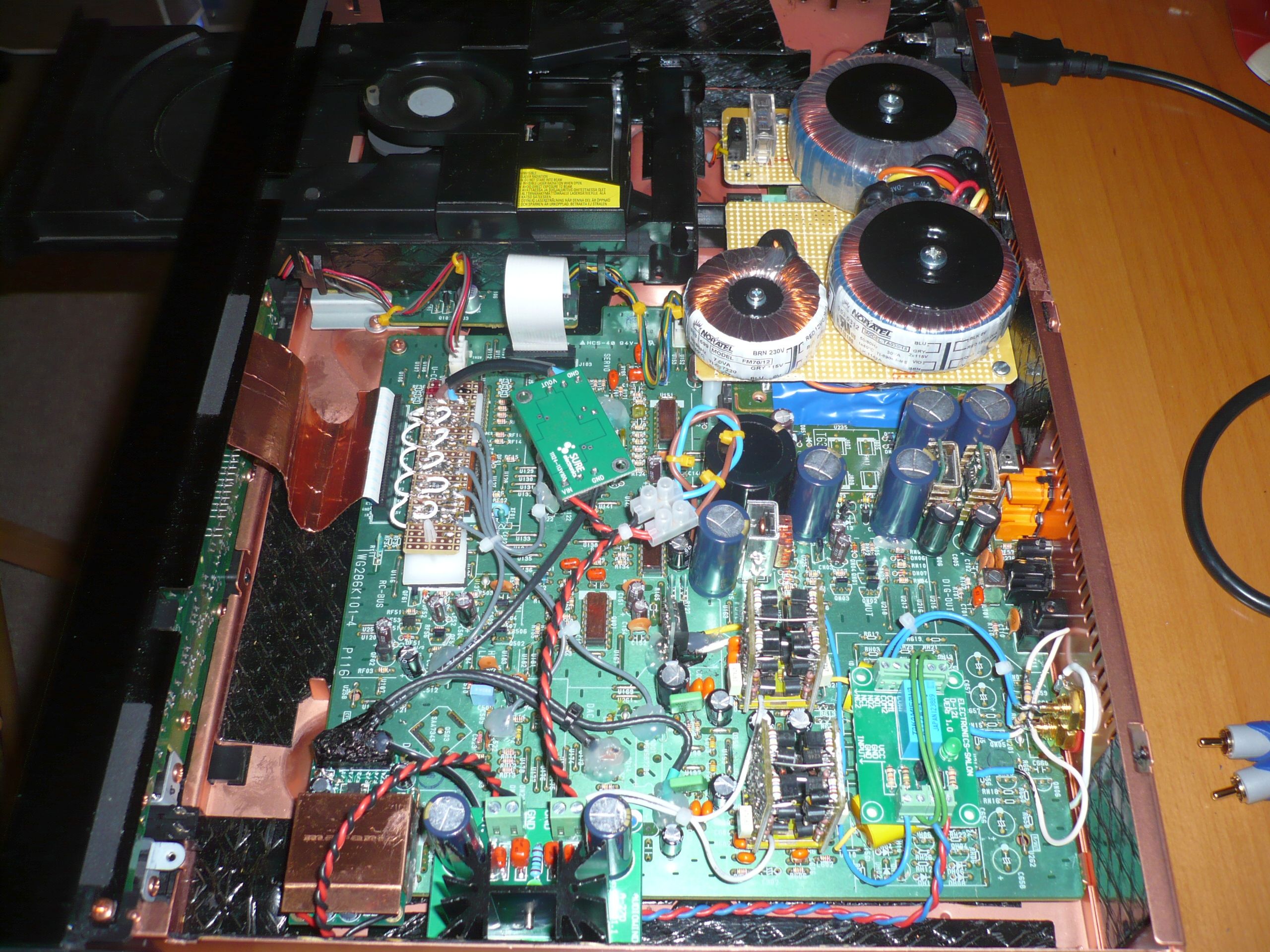

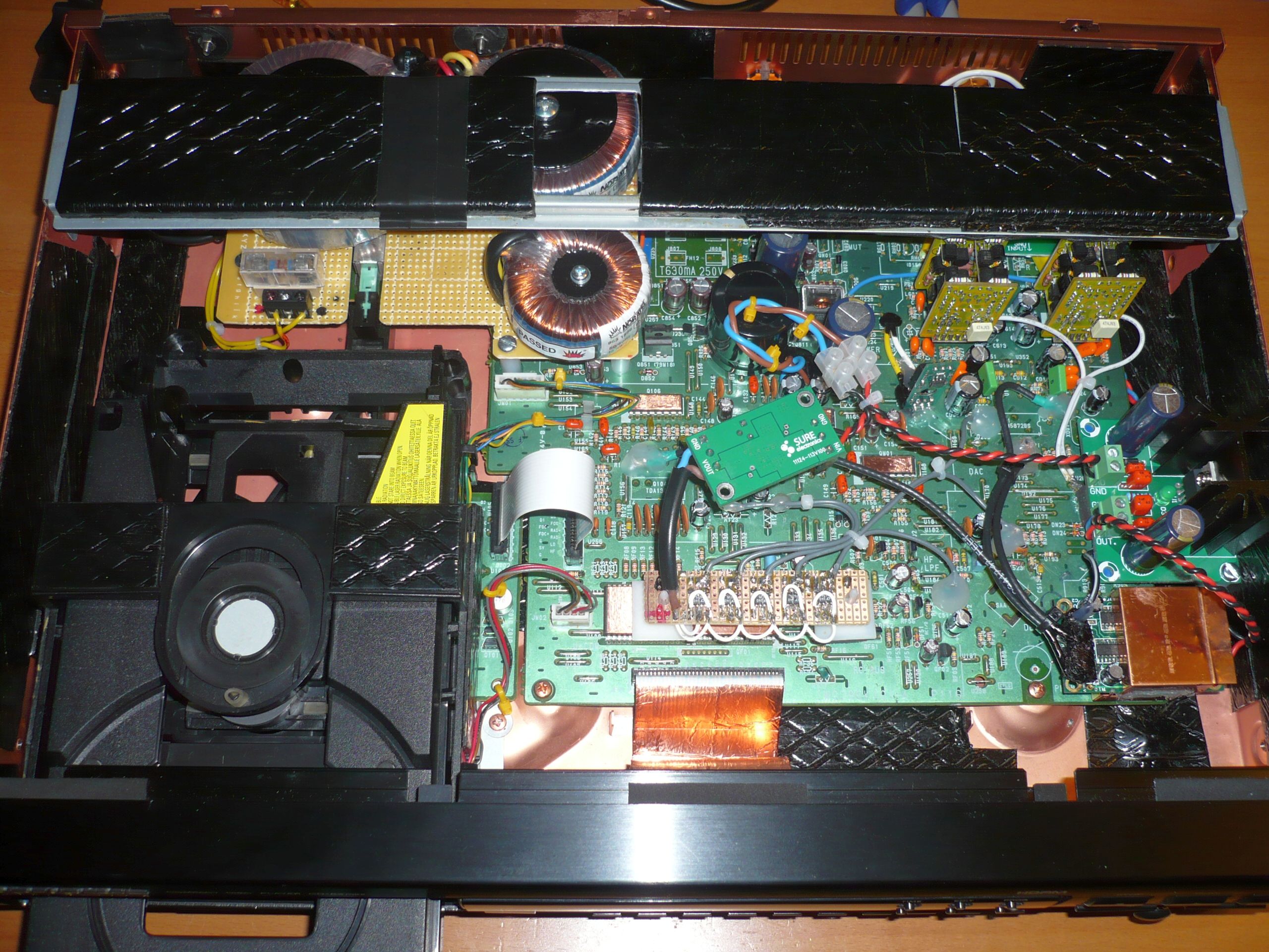

3rd modding project completed
I have completed my 3rd modding project which my good friend had requested me to carry out for him after listening to my modded CD63KI.
Actually a few of my friends have also asked me to do the same but I have refused all of them as I don't have the time to carry out the work at the moment 🙁
This will be the last modding project for the time being and I will carry out new project again may be after 3 months time.

I have just set up a 50 V tx (in a separate case) feeding 2 daughter boards, each carrying diodes, a big cap, 12 v power regulator and a further big cap. I will use this to power the servo.
I have been collaborating with my electrical guru on this, and he has worked out where to wire the 4 connectors down to the main pcb by examining the circuit diagram for the CD 63SE. However, my player is the KIS. I have physically checked the circuit diagram to my player's pcb, and as far as I can see, the circuit boards for the SE and KIS are the same in and around the servo area. I thought I would check first on here that the 2 are the same before making the connections.
Could someone please let me know? Thank you in advance.
They are EXACTLY the same player without the gold badge, copper paint and toroidal transformer. Now you've upgraded that you may as well sell the KI for £180 and buy an SE for £60! I've sold every KI to upgrade to modded SE's 🙂
