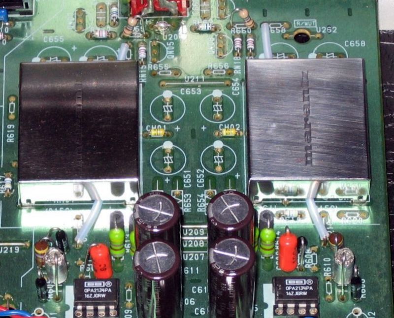

Thanks RAY. As shown in my uploaded photo I used LM4562HA opamps in my CD63 SE and there is a blocking cap to get rid of the DCs. I don't have the 47R in series and it seems to me that there is no problem to the opamps 😛 But to play safe I think I better insert a 47R 🙂

Hi Ray ... look your web for CD 63 KI Mods
then go to mods list
i feel my mods a little bit harsh now and looks
like i didnt finish some works
1
Disable muting circuit: remove QN24/25/91/92 and RN27/28
(cuts analog -12V to muting circuit)
i forgot did i desolder RN 27 & 28
2
Remove U207, U211 and U262 (and cut trace) to disable traces running to
headphone section. Decouple each muting line to GND with two 100n/X7R
at junctions U222/223 and output side to remove noise, coupled-in to analog
section from digital-out trace that runs in parallel with muting lines for several inches!!
looks like i didnt do this too, solder 100n to u222 & u223 ?
or u222 to u223 ? can you show me the picture ?

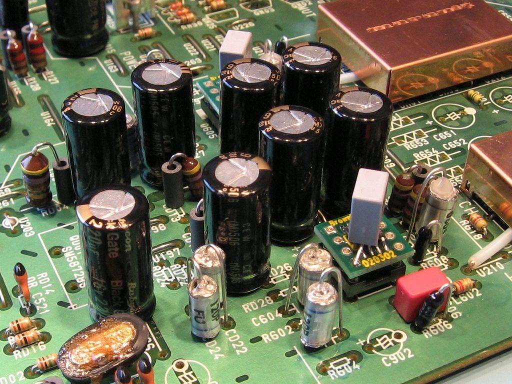

Please look the picture
where this 2 jumper cable from and goes ? ( one is u210 to c657 ? )
you didnt jumper c655 and c658 ?

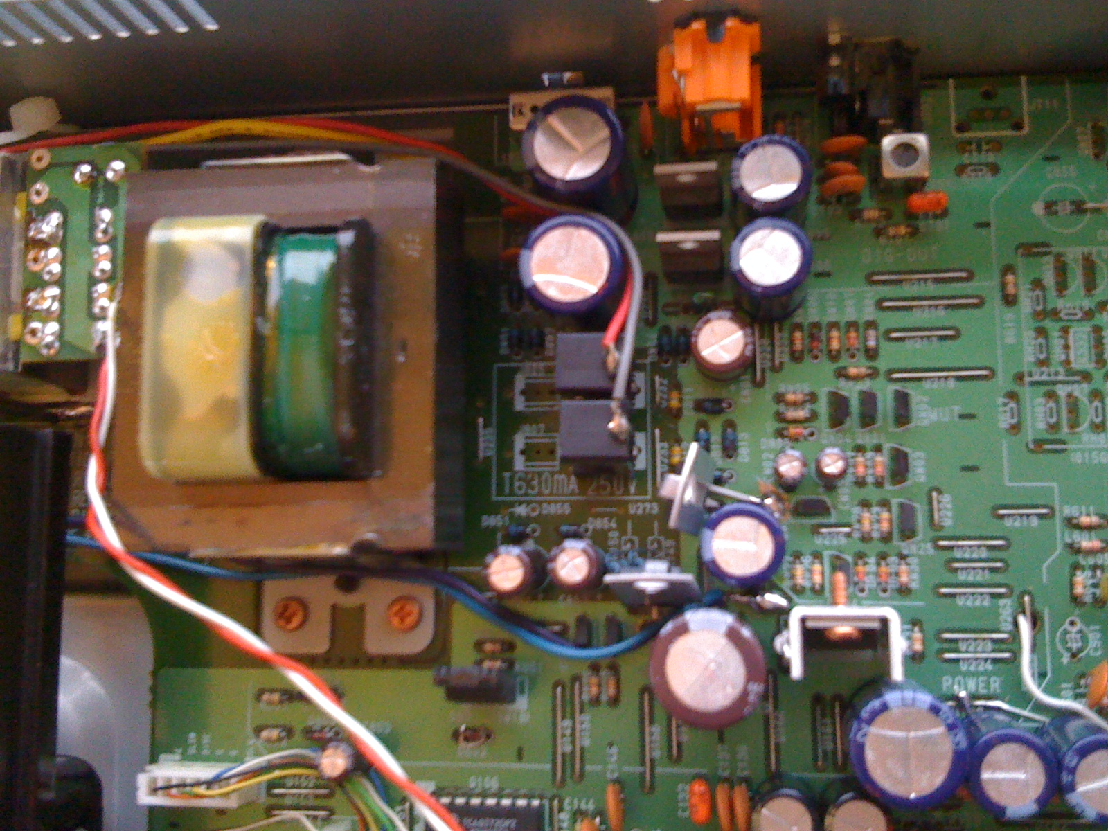

I will change LM 7812/7912 with LM 2940/2990 - 12

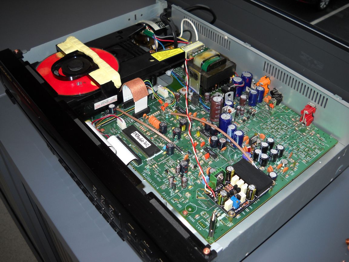

Here is the promised picture, and yes I do fast work more than clean now... by the way the owner does care for sound, not sight 😛

I don't have any pictures of the nr.2 mod, but the idea is to disable the traces of the muting lines and connect them to GND with two capacitors. They literally run all around the analog section, and the digital-out trace is running next to them for quite some distance. They act as antenna's and can pickup noise from the digital trace and pollute the analog section.
You have to study the lay-out a bit to get the idea.
The jumper-wires you see, are running from the opamp outputs straight to the output sockets. So C655 thru 658 are bypassed, I just used one single jumper to do it. I did the same with a CD63mkII, you can see in a better picture here how's it's done. The only thing between the opamps and the output sockets is a 47 ohm resistor.

Your attached picture was really clear 😀

Hi Matthieu
your picture really really clear now
i look that you use 2 brown cable,
one from mechanic to up ic control
other from down ic motor to clock
my question
- can i solder it the cable in CD 63 too ?
- is that digital cable / standard cable ?
- For cable no 1, from where to where ?
- For cable no 2, from where to where ?
- What FO used in the clock for 16,93 ?
Thank you, best regards

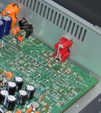

Sometime i thought about solder output caps
Due to discrete schematic, looks like output
cap will be always there. Sometime i plan to
solder output caps from 0.1uf, 0.47uf, 1 uf,
2.2 uf, 3,3 uf or 4,7 uf
a suggest please ?
