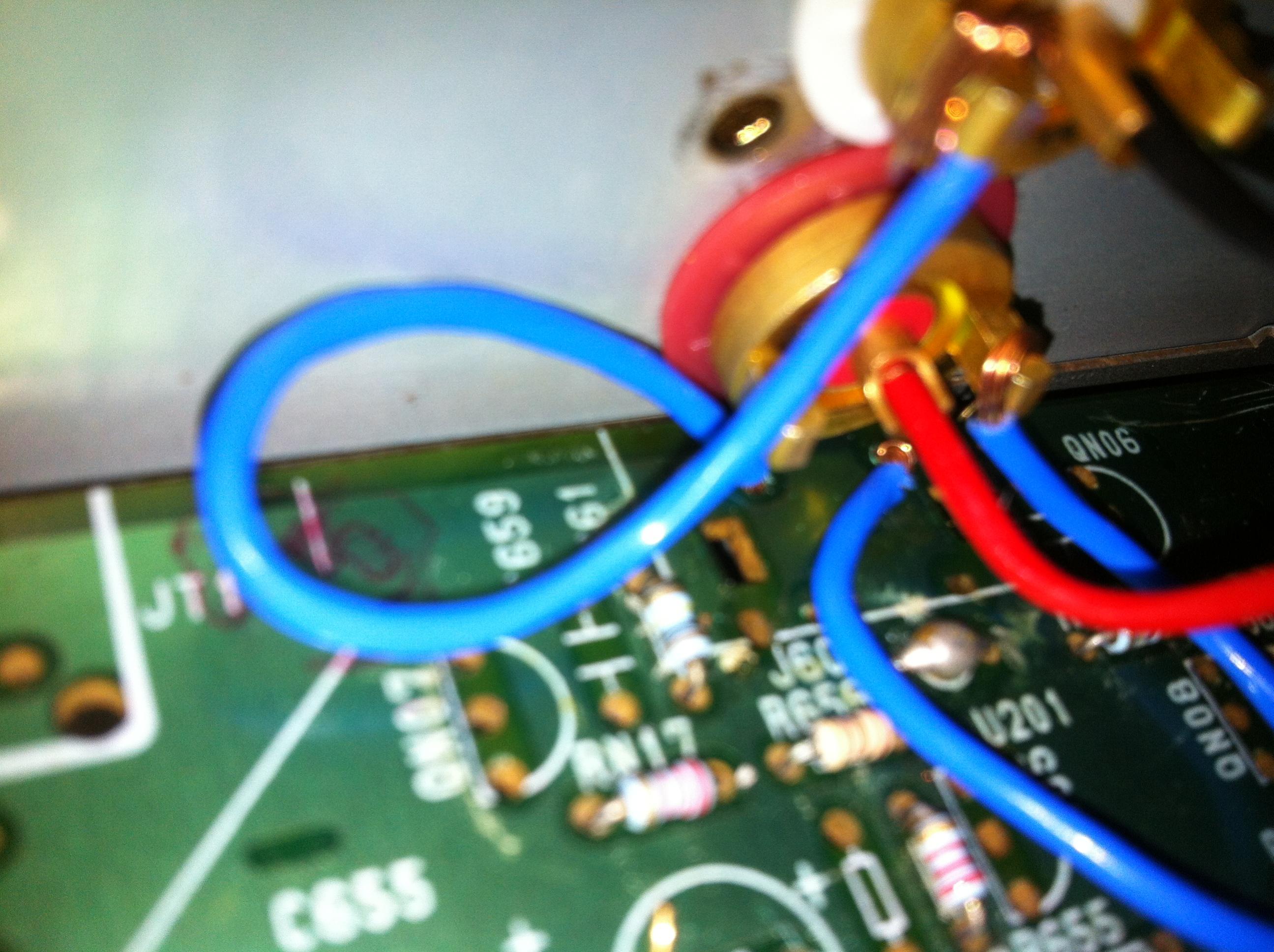

I taken signal output straight away from U210 and U214. But where to ground?

Take gnd from the original point that fed the output phonos. Where are you taking gnd for now? This could be the reason for distorted output??

I didnt take the ground. Can you please tell me the position number fromt he scematic if it is there?

Seriously, if you cannot identify the original output gnd connection, you really shouldn't be poking around in the player.
Why don't you have a look and the PCB and point it out to me and then I'll help!!!!

RCA! The RCA socket ground! Not the IEC. OMG 😱
@badrisuper Hint: The RCA sockets that you removed only had two connections per channel - signal and ground. You've already connected one of them.

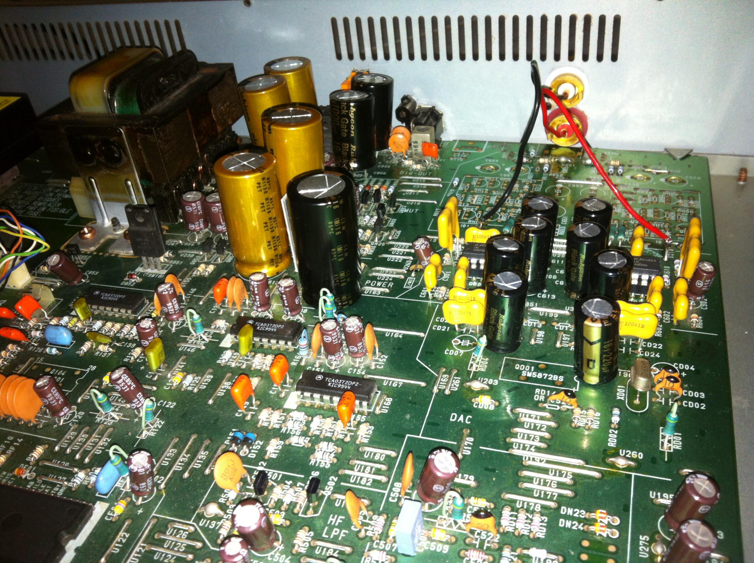

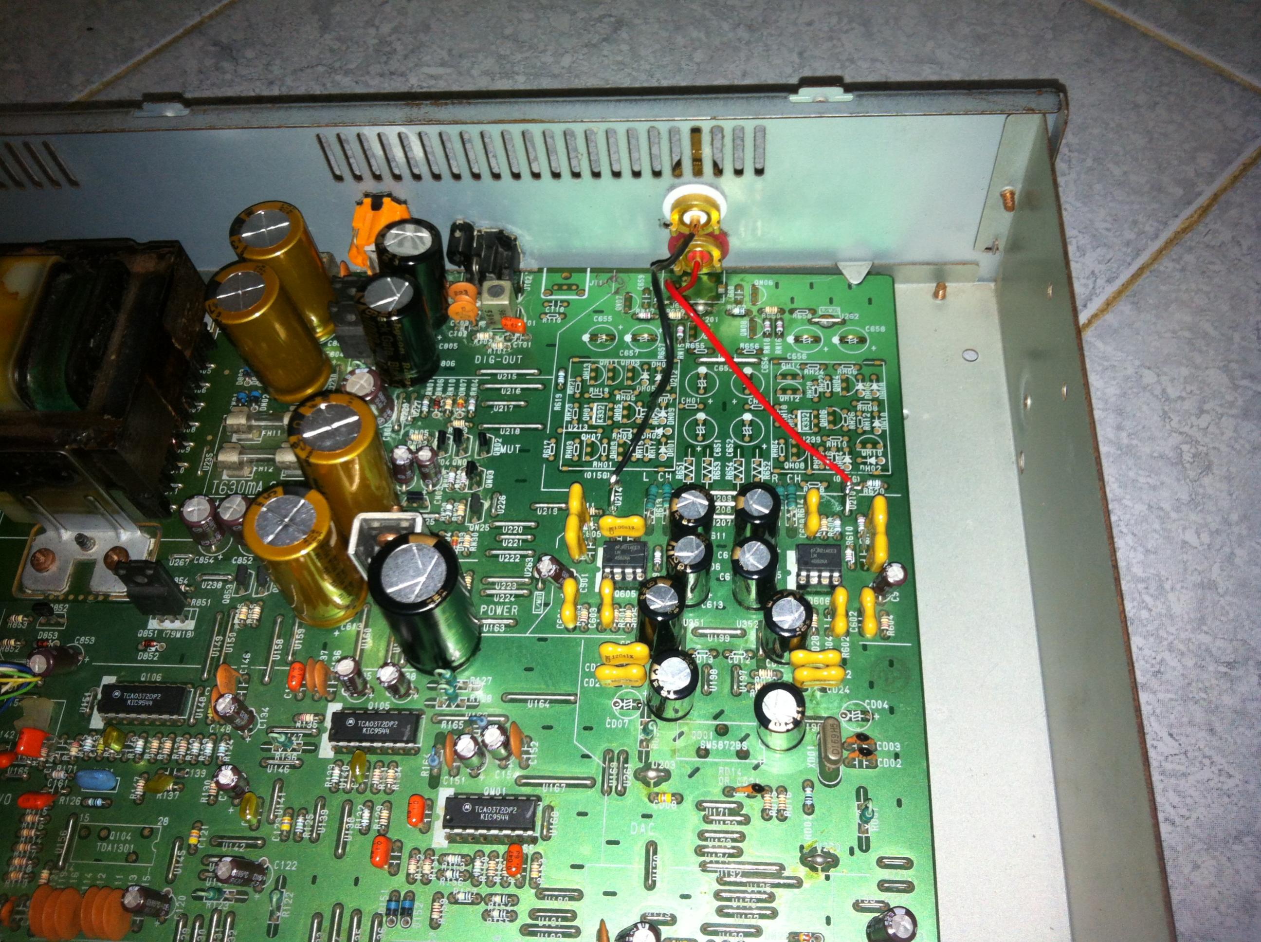

Thanks UV101. Please see the picture. Is it right? And I did read the DC, in right channel 14.2 and in left channel 33.8. Any suggestions.

Get a pair of good quality output caps such as Mundorf Silver/Oil 2.2uF - 4.7uF and run that signal wire through them. I got a matched pair of 3.3uF from Parts Connexion. They will block the DC for you.

I don't have a pic of them to hand, I'm afraid. They're axial caps. The exact value required is based on the input impedance of your amp and desired low frequency rolloff. You can calculate the value you want here: Coupling Capacitor Calculator by V-Cap
My guess is your Russian caps will probably work just fine.

Thanks Ben. Now the distortion gone. And I used Russian capacitor. Not bad, bass is controlled and very good but i feel like i it is little slow. I have to find a suitable cap. Any Suggestion.
