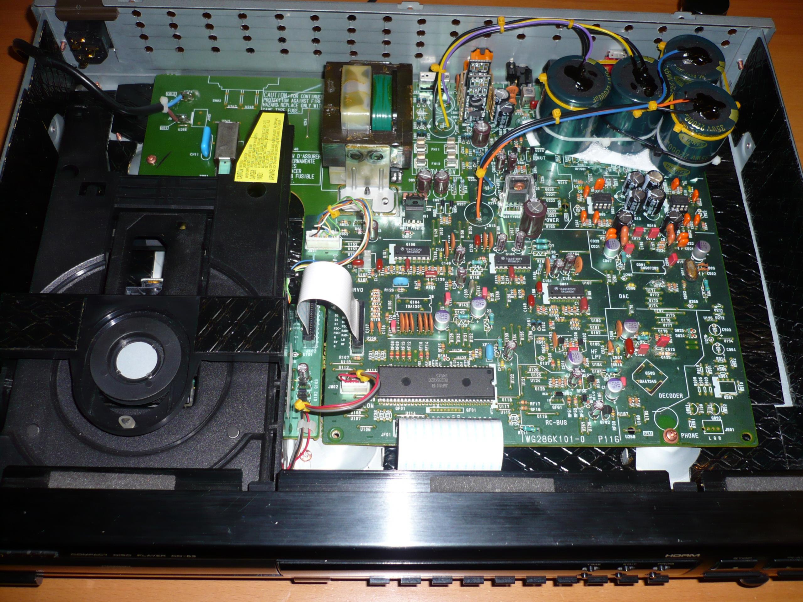

I am in the process of modding my CD63 (not the KI version). I have finished changing the opamps to 4562; changed the analogue rail 7812 and 7912 with + and - sPower;increased the digital and analogue rail caps with 4 X 22,000uF; change critical caps as suggested by Brent (mostly 470uF and good quality 0.047uF). It is now working perfectly. I am now waiting for the 3 Tx to arrive and will figure out how they should be located. I will also add another Tx for the external clock which I will add after completing the PSU part. Then I will add independent supplies to the Decoder, DAC and servo. I forgot to mention that the phone and HDAM have been completely removed.
One thing I like to mention is that I follow the changes that had been made in the Decoder circuitry in the supplementary service manual for KI vesrion. With the new circuit in, the CD drive just could not read the Table of content and the front displace always returned with "DISC". I have to remove everything and use the original circuit and everything was back to normal. I don't know why?
I have uploaded a photo showing what I have done so far. You can see most of the stock caps have been changed and 2 sPowers for the output session are installed. This CD63 was purchased in eBay for £30 inclusive of postage. I have also drilled a number of ventilation holes at the back panel for cooling and the entire case (and cover) is lined with vibration damping sheet. When I have completed changing the 3 Tx and low jitter clock I will upload another photo. Forgot to mention that I have also ordered more than 10 pcs of fast acting diodes which should arrive shortly.I am in the process of modding my CD63 (not the KI version). I have finished changing the opamps to 4562; changed the analogue rail 7812 and 7912 with + and - sPower;increased the digital and analogue rail caps with 4 X 22,000uF; change critical caps as suggested by Brent (mostly 470uF and good quality 0.047uF). It is now working perfectly. I am now waiting for the 3 Tx to arrive and will figure out how they should be located. I will also add another Tx for the external clock which I will add after completing the PSU part. Then I will add independent supplies to the Decoder, DAC and servo. I forgot to mention that the phone and HDAM have been completely removed.
One more thing I want to add is that I am considering to change the 4562 opamps with either Burson opamps or Ray's DOS. The only drawback for DOS is on it size which is a bit too big to fit into the case. Anyway changing to discrete opamps will be the last on the roll and I will make a decision when all the other mods have been completed.
Hey higlander, if I was you I'd find a way to bring those big caps closer to their original positions with shorter leads. If you can clear out the HDAM area then you'll have plenty of room to mount a DOS.
The diameter of the four 22000uF smoothing caps are far too big to be placed anywhere near the rectifiers. I have tried all locations and eventually I have to completely remove the HDAM to freeze some space for them, in particular the headroom. Unfortunately the side slots are not wide enough to accommodate them 🙁 I should have bought some slimmer caps.Hey higlander, if I was you I'd find a way to bring those big caps closer to their original positions with shorter leads. If you can clear out the HDAM area then you'll have plenty of room to mount a DOS.
You may have also noticed that I have completely remove all the components of the phone circuits and I will use this area to fit the low jitter clock.

Like Ben says, those long leads are not good... Especially if it's the rectifier caps. There are mean charging pulses going through those wires; they act as antenna's and will radiate noise into the player and pollute every signal. You should really try to change it.

I know the problem and I am thinking of shielding the long wires to the caps by wrapping it with thin aluminium and then earthed it.Hey higlander,
