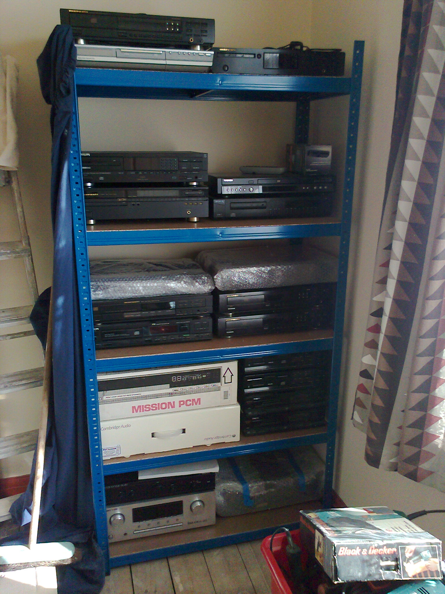

Equipment rack
I bought myself a new equipment rack 🙂
