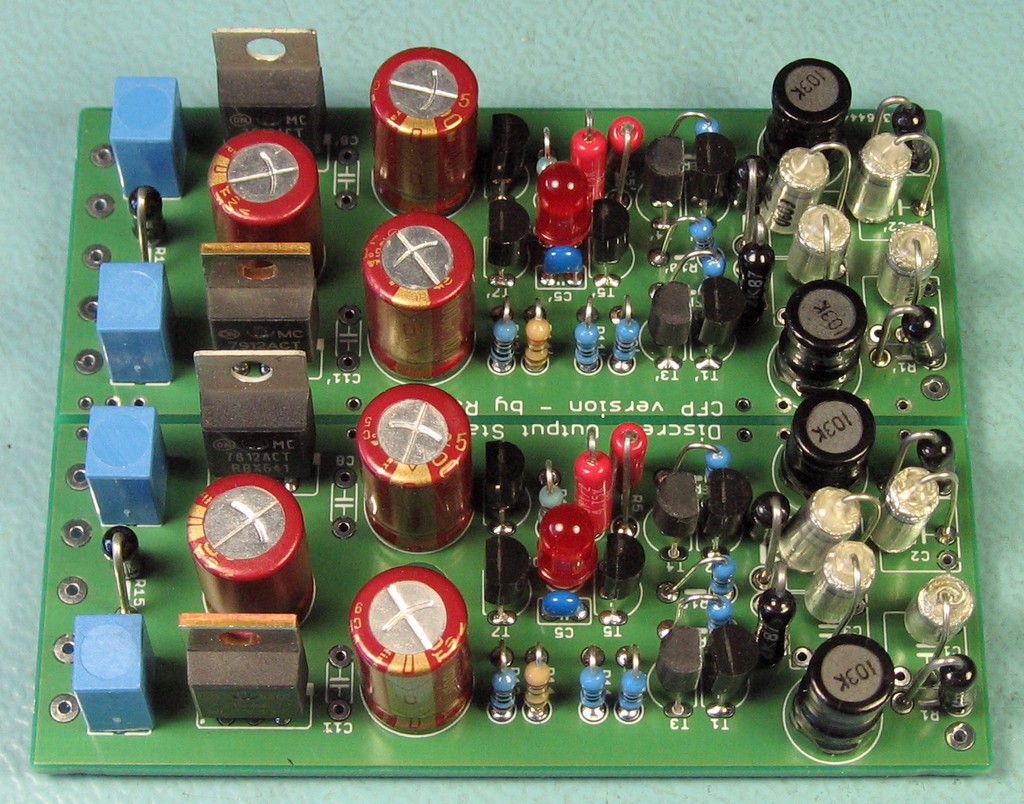

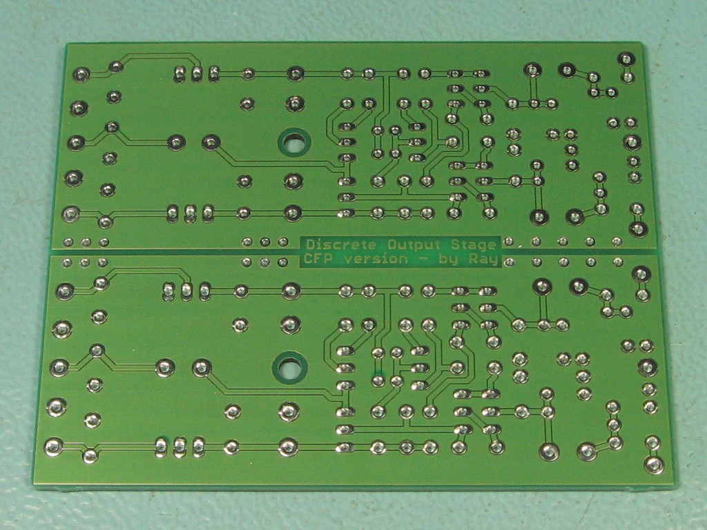

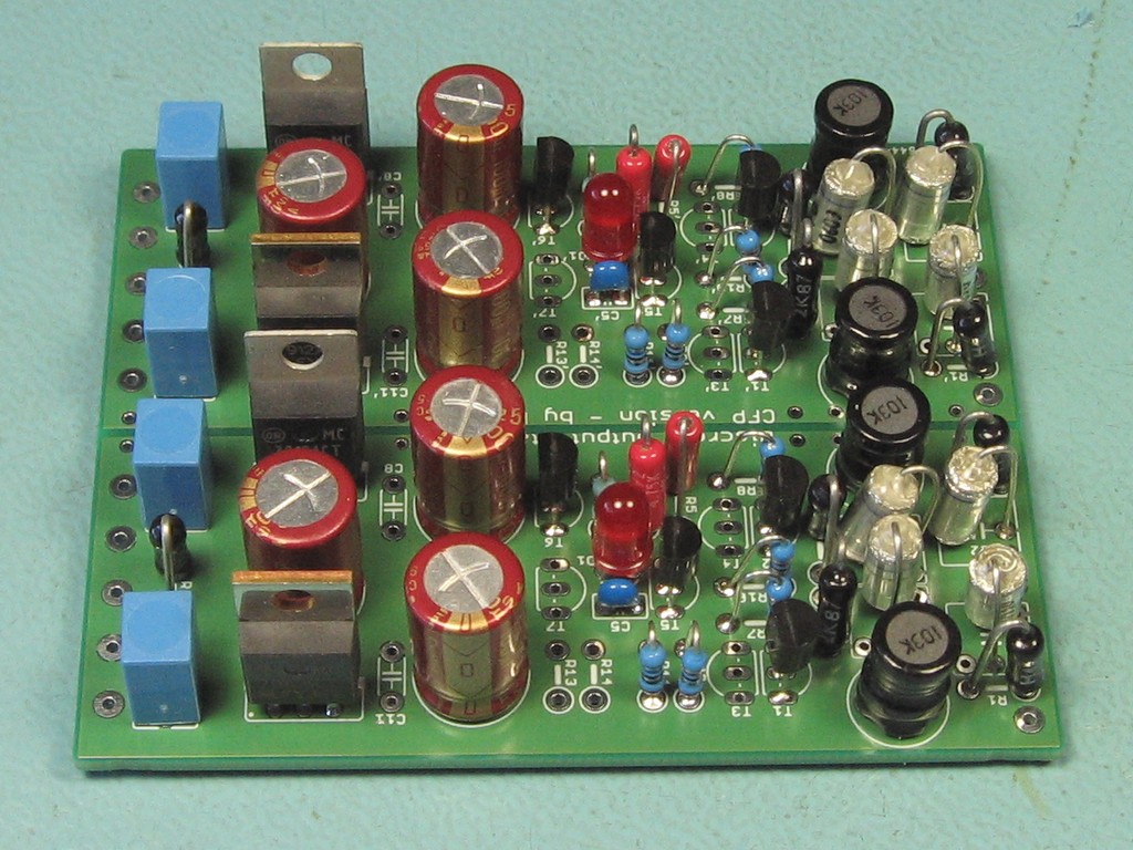

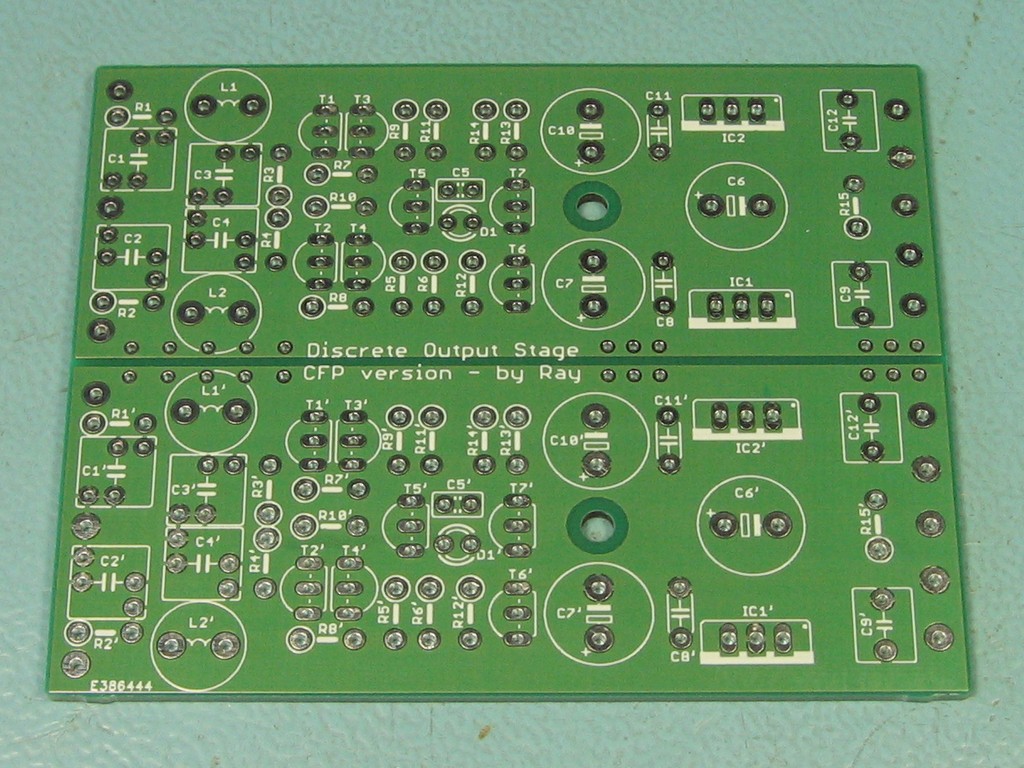

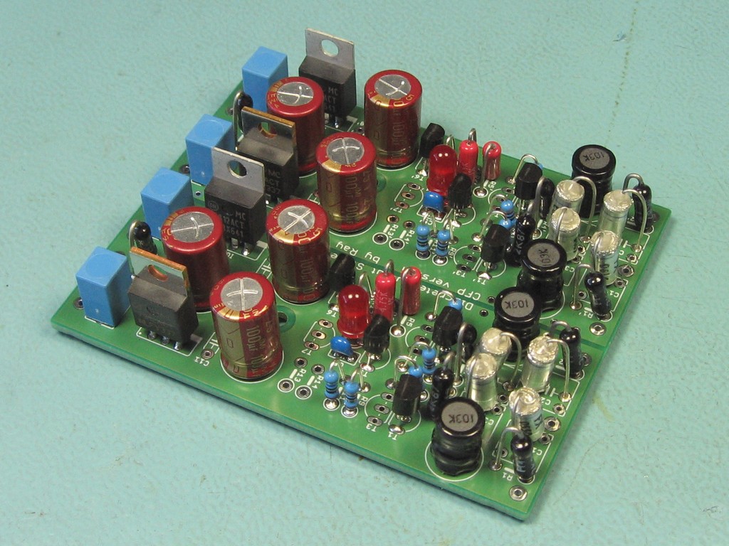

Ok, here are some pictures of the new DOS-CFP board.

The boards look good Ray, you did a thorough job !
Can it work on 15V and when can I order the cfpdos ? :lickface:
Wonderfull Ray !!!
I am already saving some €€ to get one of those.
Great stuff!
Thanks everyone!
Erik, the boards have on-board 12V regulators, so minimum input voltage is +/-15V.
I just updated my DOS-CFP page with the latest schematic and partslist PDF.
Boards are ready to ship now, so if anyone's interested, just send me an e-mail to:
