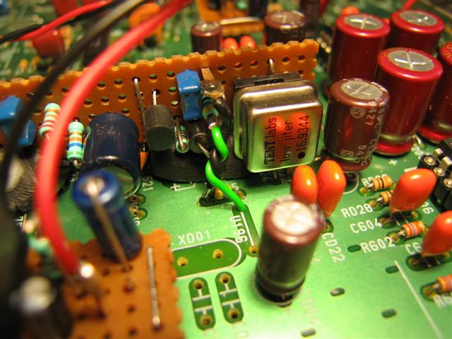

Here's a picture of mine Tent XO, sitting in modelling wax ;-) And it's even the one with the printed spelling error. LOL.
/avr300
avr300 said:Here's a picture of mine Tent XO, sitting in modelling wax ;-)
Nice job, avr. What's your first impression on the sound?

Oh dear, looks like you got one of those cheap chinese rip-off copies...😀.

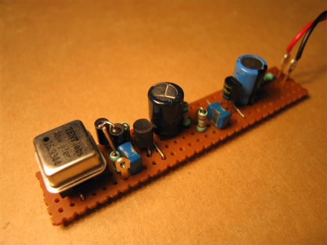

Did you follow the layout for the power supply that is on the tentlabs site?

Ray: More control, more "silent", darker background. Combined with the LT1361 OPAMP, it plays quite decent. But i'm still waiting for my AD8620. Still need more speed and "ongoing".
And yes, it is from the far east ;-) Could end up as a collectors item.
Gy21: Yes, it is the psu layout of Guido's. One more picture of the unit.

Thanks avr300, my excel vero layout is basically the same, also taking 5 strips. I'm just waiting on the xo clock to arrive at the dealer.

As you can se, I just placed mine i a bit of wax. Then I can still take the board out, without anything stucked to the cabinet sides, I guess you can't ;-) The wax has a nice damping as well.
Ane while we are at the topic, should the clock signal be terminated, by a resistor to ground, at DAC end? Right now, I'm just feeding the DAC at pin 28 and ground at nearest groundpoint (see picture http://www.diyaudio.com/forums/showthread.php?postid=892692#post892692).

Hi avr,
On such short runs it's not needed to terminate. The wavelength of the signal is far bigger than the wire. There's a bit more info here .
