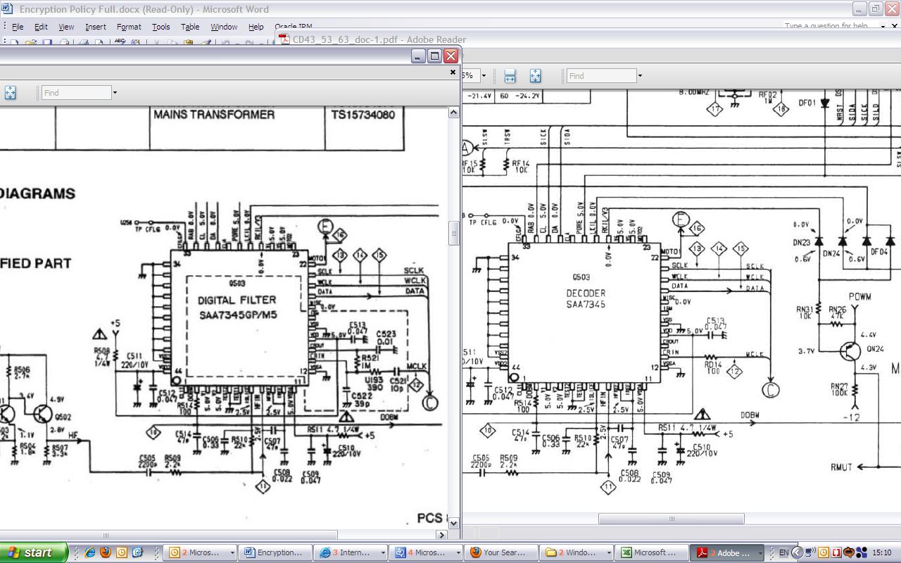

You need to establish if you have the MKII
Check the MKII service manual. You need to connect in front of the 10pF ceramic cap near the dac (dac side of it) to make it work as there a few components in circuit designed to make the decoder think it have an xtal directly connected. The change in circuit was probably to increase stability in the MKII model. Grab the SM supplement from rays pages. it highlights the different circuit on the MKII. It wont work it you clock the clock in pin direct on the decoder on the MKII 🙂
Well done for getting it running again too :drink:
edit: although the 10pF cap is shown close to the decoder in the SM, its actually close to the dac in the player

Bartt as per my previous post, you need all the components in circuit in the MKII
In the MKII, RD14 is a 100r in the space of u193 and C521 is a 10pF in the space near the the DAC marked "RD14 or C521" You need both components between the clock and decoder.
However, its possible that if you lift the decoder pin 14 (CROUT) , you may be able to connect as per the MKI with the clock direct to pin 13. I've not tried this to prove it though.

Yes, exactly right.
EDIT- just to confuse things, you can use a completely seperate clock for the servo but the 16Mhz to the DAC, Decoder and the 2Mhz to the BCKI MUST be from the same source. Its also possible that any logic for dividing the clock signal will need to ensure that the clock remains in phase. You may also need to consider latency through divide circuits 🙂
Do you also need to connect the 16MHz signal to the pin 13 on Q503 (CRIN on the decoder)? And do you do anything with word clock signal (goes from pin 20 on Q503 to pin8 on QD01)?
If you want to clock the decoder direct, you must do as I said in the previous post and include the components in the MKII manual if you have a MKII.
I've not tried this mod on a MKI board but in theory it will work without the additional components.
My theory is this.......
It looks like the MKII was modified to present a load across the CRIN and OUT that looked like an xtal was directly connected. This most probably to make the circuit more stable.
Its possible that if all the components shown as changed in the MKII were removed you can clock direct to the CRIN pin but this is just a theory!!!

Lift the leg of C521 closest the DAC and attach the clock to the cap leg you now have floating above the top side!!!
