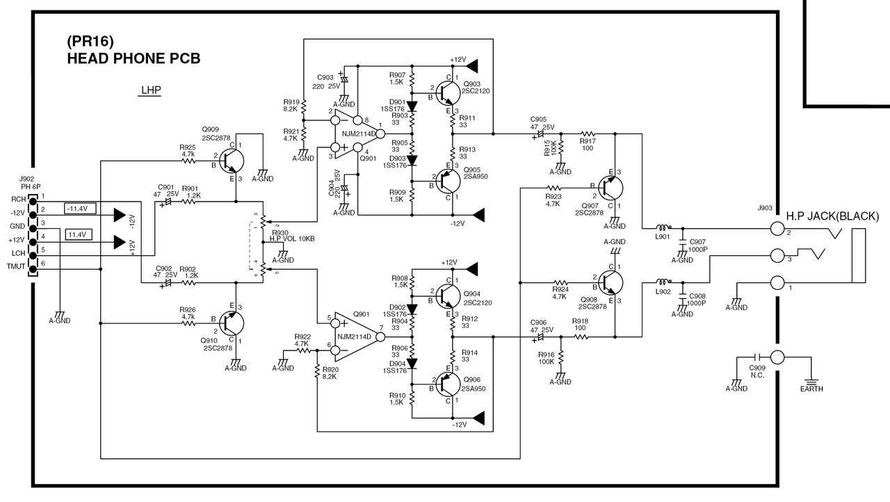

The headphone output is poor because a) headphones let you hear how naff the standard player is and b) the sound goes through an extra op-amp - an extra pants one. You can change the headphone op-amp and it will help matters enormously. This op-amp is, from memory, decoupled by tiny cheap caps, which should also be upgraded. Lastly, a typical op-amp isn't really designed to drive headphones. You need a special buffer or headphone amp to to get the best results. It can certainly be improved a lot and for not much money, but you will need the soldering iron. Mechanical mods will only go so far and don't tackle the worst problems in this and so many other players.

This is a nice little headphone circuit that I built for someone once. It's easy, cheap and already sounds a lot better than the original circuit if you use a decent opamp (AD8620, LME49720). It's from the Marantz SA8400. The extra output stage after the opamp makes sure the headphones are driven with enough current. You can ignore the four muting transistors at the input and output. The circuit in the center is the interesting part.
The only fortunate thing in your player is that the headphone signal doesn't run through the HDAM section. But you'll have to upgrade basically everything else to lift the player towards audio-nirvana 😀.

Soldering iron then ? 🙁
I might think about a headphone amp with a tone control in that case....
The trouble with using a headphone amp with tone controls is that it may change the sound, but it will not improve it. I think you would be better getting a good headphone amp without tone controls and doing the simple mods suggested. This has got to be a better way to go because if you decide to get an amp in the future the mods will still be relevant. Of course there are lots more things that can be done, but the only soldering involved here is two links and the op-amps, the rest is down to snipping bits out if you don't want to de-solder them. Like Simon said, the internal headphone amp is rubish.

Which links are you referring to here, and which bits are we snipping out?
If it was me, I'd swap a couple of crucial caps. The smoothers on the +/- 10v rails for something much larger like 10,000uF Panasonic TSUP's this will smooth out the sound. These are for the servo and +5v rails. I'd also swap the main smoothers for the +/-12v rails for something similar as these are the rails that power the opamps on the output stage and headphones amp. The caps wont fit in the original positions, but you can connect with short wires and mount out of the way. As Simon said, replace the local decoupling caps for all opamps for something like elan SilmicII (based on you description of the sound you are looking smooth out rather than sharpen) and then swap all 3 opamps (2 in the output stage and one for the phones) for something like LM4562's. Also consider replacing the decoupling caps on the DAC with Rubycon ZLG while you have the chassis out!

The links are to by-pass the HDAM (R619/620) The snipping refers to the supply/in/out reistors. The total cost is around £5-10 for a couple of half decent op-amps. LM4562 or whatever. I agree there is a lot more that can be done, but I was trying to encourage the solder shy upgrader!
