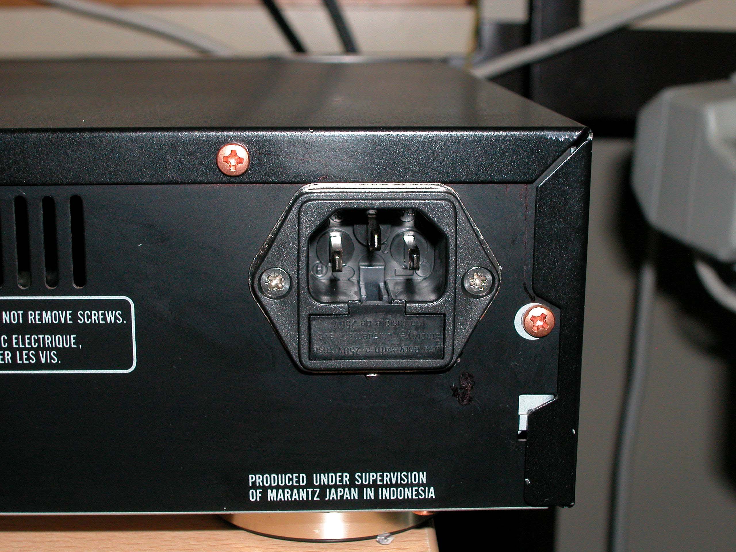

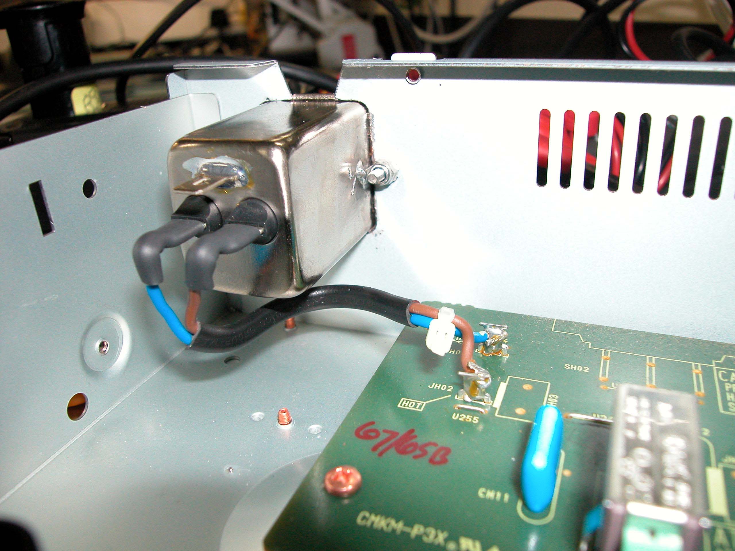

Well took delivery of my CD-67OSE yesterday purchased from Eblag and haven't even had it 24hrs and started modding already with a schaffner mains filter, next on the agenda is a Kwack Clock 7.
Who knows where it will end..............
Tom
