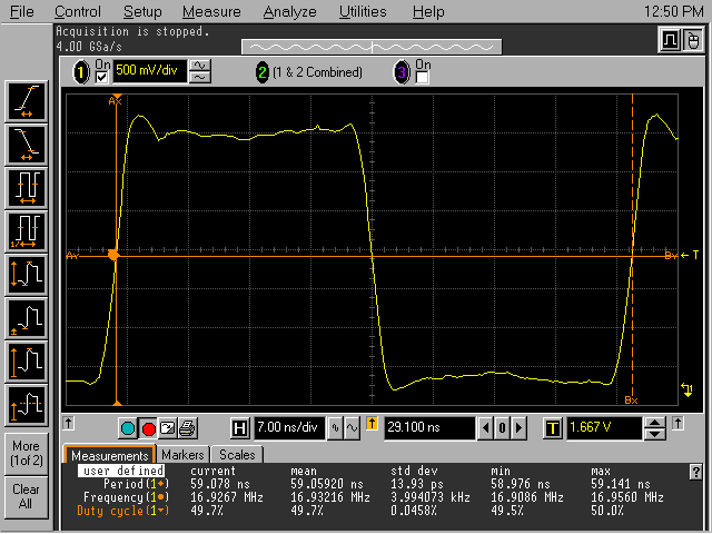

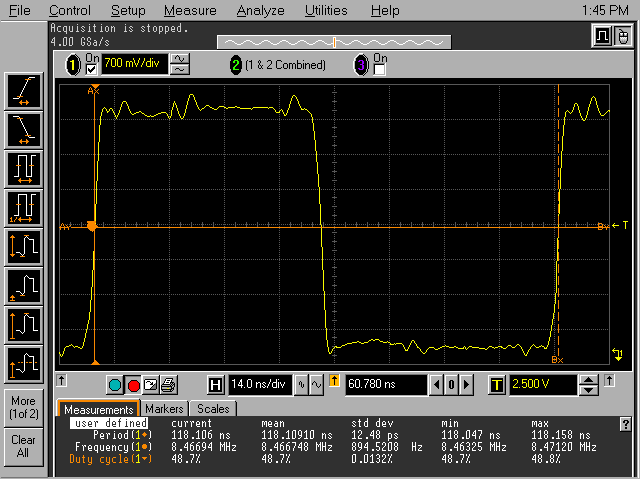

And here are some scope graphs, just some highlights:
33.8688MHz output at point T1: measured 9.0ps jitter. My 24.576MHz Flea does 8.9ps here. Not too shabby! 😎
This is the 16.9344MHz version, with 13.9ps it's a bit higher, but who's complaining? 😀
Nice stable waveform, duty-cycle is nearly 50%.
