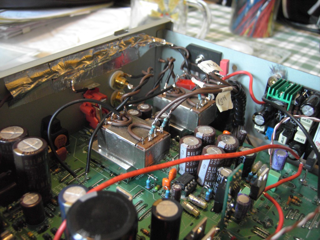

I've been messing with transformer output a little more. I found some resistance (470R) in series with LON, LO, RON and RO helped to reduce the noise but also made the sound more limp with soft bass. 100R was a better compromise.
I have now also tried connecting the + input of the tx to pin 1 (1st op-amp output) of my LM4562 so I have half the filtering and just 1 of 3 active stages and then my line transformers.
This, as expected, provides decent noise levels, a decent bass output and a sound that isn't very harsh, retaining some of the transformer's music making abilities. This is a good compromise, I can see why Audiocom connect those fancy transformers after an op-amp, even though it sounds like a funny thing to do.

Yes, it's a voltage output dac and wants to 'see' a very high impedance as a load for best accuracy.
Bolting a transformer on directly after it requires the dac chip drive the interconnect cable capcitance and the preamp input -something it is really not designed to do.
Yeh, it doesn't seem happy with that proposition. It's a bit like a "passive preamp" in its effects on sonics - smooth but lacking immediacy, full texture, bass dynamics and bite. I like this player now but I think next time I mod one I'll strive for a discrete output stage as it'll be no more expensive really and probably even better.

The transformer I used doesn't change impedance I don't think, it's a 1:1 ratio model so I believe it doesn't change the voltage or impedance much. The op-amp deals with the problems and filters the noise, whilst still allowing a fairly pure sound subjectively. I haven't used the player with just the single op-amp but I don't think it would sound as nice as with the transformer.

I don't think I've advanced anything on this thread by trying it, merely explored one particular avenue a little more. It might satisfy some people's curiosity.
I do think a good simple discrete active stage would better it, but there is simplicity in running a tx after just one op-amp stage. The only real complication is having to drill new holes to mount isolated sockets... though I don't know that anything bad would happen if you didn't bother and just mixed the grounds together. If you connect both outputs to the preamp they'll almost certainly get mixed anyway (they do in my preamp).

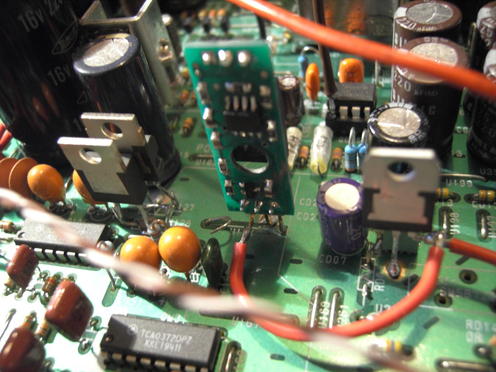

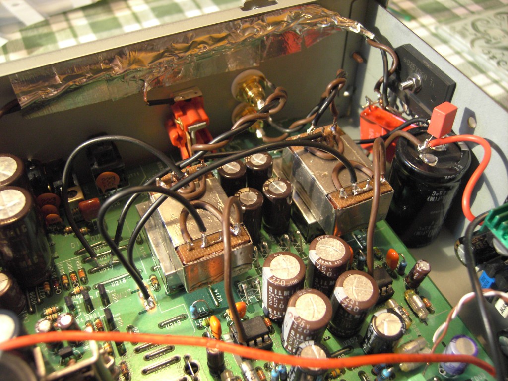

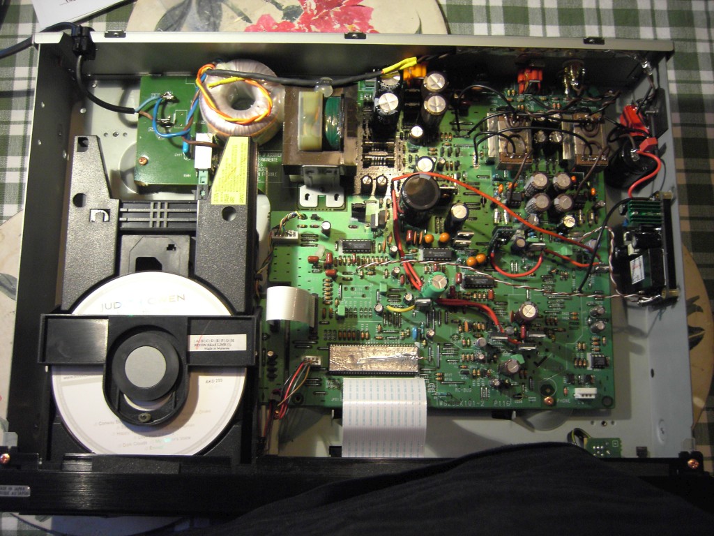

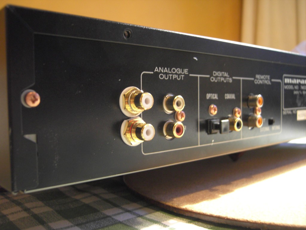

Some pics
Here are a few pics of this one I've just finished. Having 2 sets of output sockets makes it easy to compare one output to the other - instant A/B switching using the source selector.
Also there's a pic showing where I routed the DAC wires (later removed in favour of op-amp connection).
