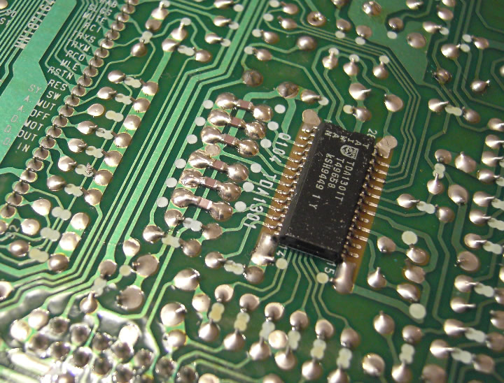

That mod sounds like a fat waste of time. Why not just buy one of the many TDA1543 or TDA1547 players that are available? But then from what I hear about NOS that's also a waste for high-end. It seems like just a quick-fix to get a more listenable sound.
Couldn't agree more, Simon.
Besides which - replacing the '63s (noisy, but not bad) dac with one that has about 13-14bits of resolution at best - just check the 1543 datasheet for dynamic range - seems a bit wilfull. Of course it will sound 'different'...

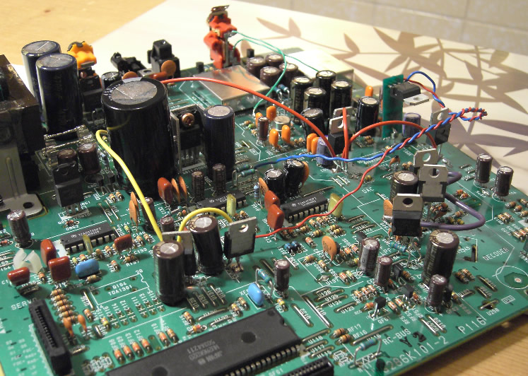

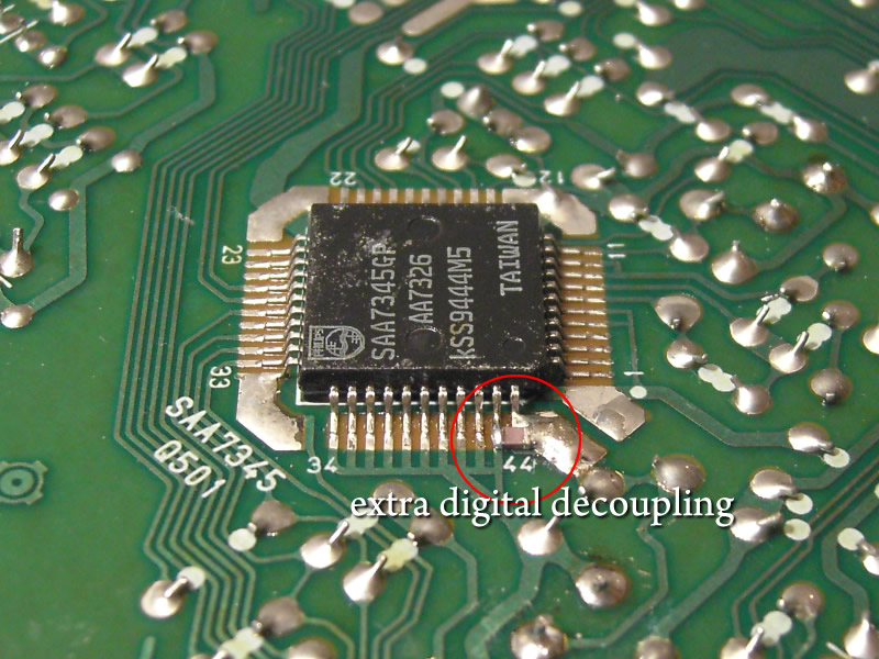

Here are some pics, which may be of interest to anyone doing the typical mods.
COG ceramic 220pF caps on the servo, a similar cap added to one of the decoder's digital rails, and an overview of Steve's CD63.
It really does sound excellent now. The big cap on the +10V rail was probably the single most important mod, but it would still be missing detail, dynamics and lots of sweetness and warmth were it not for the COG ceramics, decoder regs and Black Gates.

Some more pics.
One of them shows more or less where you'll have to drill to put an oversized snap-in electrolytic at C813, another is the output area with "HA" op-amps, Black Gate caps and the obligatory bypassing of fuse resistors and HDAMs. The other pic is the decoder regulators. No need for PCBs here, just connect them straight in! Their power feeds aren't yet connected in this picture.

This CD player is good now, although comparing to my modified Philips CD650 does put things into perspective. On that player the dynamics and image are wide open and the bass is not only something you hear but something that you feel in your gut - even at moderate volume settings... but that is why I like the TDA1541A chip....
