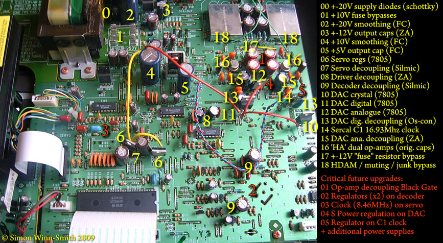

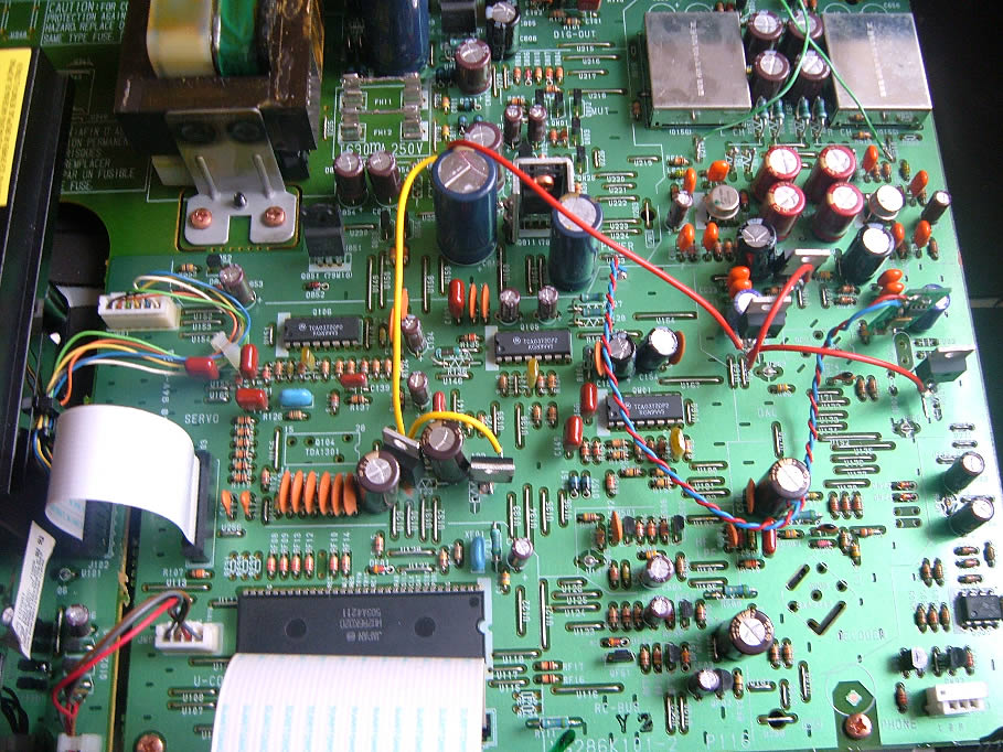

Hi all
I've made a little reg board and today will attempt to fit it😱
Just to check i take the feed from under C803 remove RD01/RD04 and U200 and feed each with an output from a reg..
Where is best for GND?
Cheers Ian
Cheers Ian
Perhaps the easiest way to tap ground is by using a fibreglass pencil to scratch the top of the pcb away and solder straight to that.
I fed the 5V regulators in Steve's player from the +11V rail. This is the one that feeds the original 7805. I did this because it's easy, not because it's necessarily best. We plan to feed at least some of them from an additional psu at a later stage (when all the nice and easy mods are done).
I think you'll be fine with C803, as from memory that is the +20V rail.
RD01-RD04 sounds correct. Have you checked those spots measure +5V as standard using a meter? It's good practice to check even if someone says it's ok.
Attaching a pic of Steve's player as modified by myself in 3 stages.
Simon
Hi Simon
Thanks for the reply, i have checked RD01/04 and U200 all +5v.
Looking at the pic of Steve's player it looks like you have taken feed from U236 (just behind C813) The voltage there is +12v
I dont have a fibreglass pencil so was thinking i could use the solder blob U275 its located in the defunked headphone section.
Yes, that voltage is 12V. I may label it 10V as that's what the service manual calls it.
Using a solder blob (U275 should do - just check it has 0ohms / continuity with the output sockets to be safe) for your regulator grounding will work just fine.
Simon
