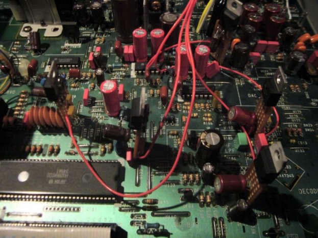

I undid some mods that made my player sound slow and flat, they were simple mods removing extra psus from dac and filter.
Now the disk wont spin, eject works, put a disk in and nothing. Im sure the ribbon connector is fine as it looks very firm and passes continuity test.

I just took a guess and pressed stop and play while powering it on, I think I found the service mode. If I press play I get err02? I have no service manual but on the 6000 it means focus error. The laser on this is new. Does anyone know what this means on a cd67 se?

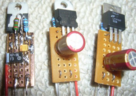

Anyway, I builg regs with like 8000uF of capacitance with pre regs and one reg for dac digital, analog and decoder. It really wasnt so nice, granted they were 7812 and 7912. I have gone back to the original psu with new panasonic fc decoupling caps and Oscons for digital.
I may try new regs in the future but with less capacitance and maybe use lm317, they do sound better. I might make some little boards, they are damn usefull regs.

LM337 - 3-Terminal Adjustable Negative Regulator (Used for -12v reg)
LM317 - 3-Terminal Adjustable Regulator (Used for +12v reg)
i want to ask if i put this regulator those cap beside the regulator need to change larger value or stock also no problem due my cap are not arrived yet thanks
oh no, its doing it again. So it seems its to do with the mechanical mechanism? Can anyone shed some light?
I tried this again and it did nothing. I tried service mode again. It comes up with P01, if I press the next track button it goes to P02 and the laser is at the edge of the disc and its moving up and down trying to focus, but its too far from the disc, the red laser is on. It then goes back to err02.

Luke said:oh no, its doing it again. So it seems its to do with the mechanical mechanism? Can anyone shed some light?
I had a similar situation and after much trial and error, I found the problem was with the ribbon.
Although it measure ok and looked firmly in place, sometimes it looses contact with the socket.
After cleaning and much trying, the player started to play again.... when it did, I left it turning overnight and now it is fixed.
Hope this helps

Luke said:I may try new regs in the future but with less capacitance and maybe use lm317, they do sound better. I might make some little boards, they are damn usefull regs.
Anyone made boards of the discreet I/V? [/B]
Lee has offered to make a PCB for me! Think I'll Go for it I too lazy and don't have exposure unit anymore (Also hate ferric chloride) Perhaps he could do a run and make 20 > 50 and sell them on his site.
