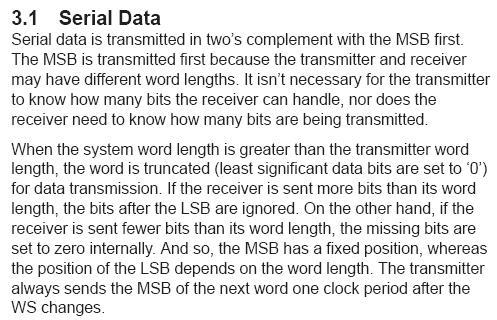

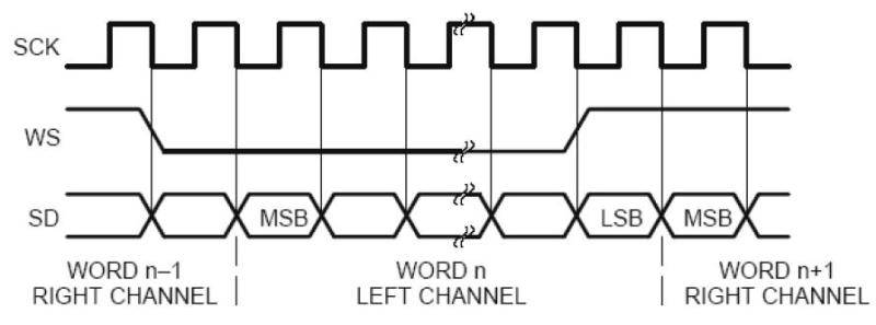

Hi Ray,
This baffled me too, from the Wolfson WM8741.
(Read text in picture first).
The first line makes sense because you need two words - one for each channel - per LRCLK period.
So that would mean (LRCLK = fs) that 2x16 bit words = 32 BCLK periods mimimum = 32fs.
But then LRCLK must be high for the minimum number of BCLK periods and then low for the minimum number which totals 64 BCLK periods to one LRCLK.
Russ White (he of Twisted Pear) told me that the modern DACs need 64fs bit clocks.
(I did notice that the only I2S mode supported in hardware mode for this DAC is 24-bit words anyway, so it would have to be used in software mode to access I2S 16-bit, but that's another can of worms.)

Don't mix up the length of the SIGNAL, which is 16 bits, and the length of the FORMAT it is transported in. The word lenght of I2S is 32 BCK cycles, so for two words per sample (L and R) you get 64*Fs. The signal length can be 16 or 24 bit, most converters automatically detect this. It's MSB first, so if the rest are zero's, that's not a problem.
Why the SAA decoders output 24 bit word length, I don't know. But if the DAC just waits for LRCK (WS) to change, it won't be a problem.
