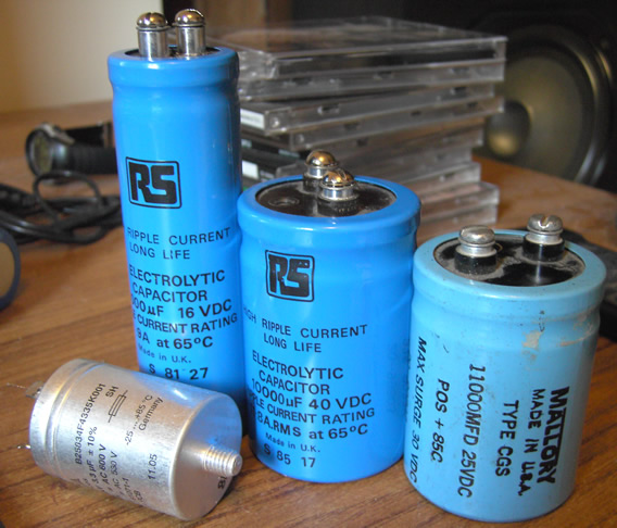

Hi all,
I was pokin' around the shed looking for my elusive Super Reg just now. I didn't find it, but look at what I did find (below). I want to somehow use these in my CD63 😀
15000uF 16v
10000uF 40v
11000uF 25v
Two of them boast ripple currents of 11.8A and 9A. Is that good? They are very chunky caps!

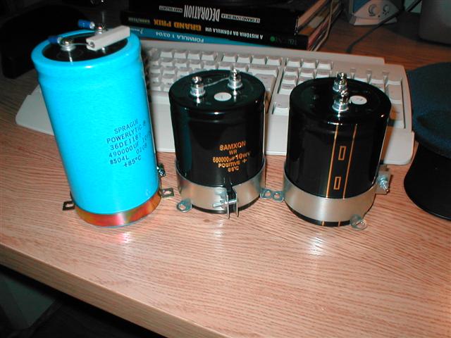

RCruz said:
Now you are talking !!!
I also have some big caps I would like to use in the future.....
490000uF 10V Sprague Powerlytic
560000uF 10V Samxon WR
The first one is double the size of the latter and specs are unreal.
LOL, mine are mere krill to your blue whale (in aquatic terms). The problem with yours is they're low voltage so probably have to go after a regulator, which may be unhappy with the extremely low ESR. Do you have pics? :happy1:
