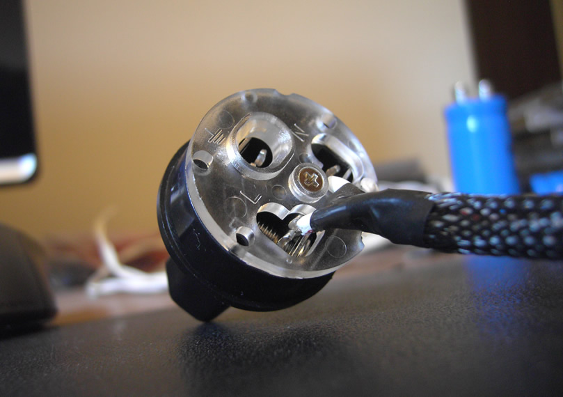

I had to console myself with making a couple of power leads for my amps.

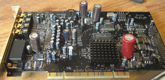

And I modified my sound card yesterday, which has brought it on a lot! 😀

Wath did you do to your sound card ?
Your cable looks neat.. How does it sound ?
Would you share the secrets ? I am a cable fanatic also..

Seems to have opened the sound up a little and improved the dynamics. It's done no harm!
Recipe:
Cheap Chinese silver plated Wattgate clone from Ebay:
http://cgi.ebay.co.uk/ws/eBayISAPI....m=270248168281&ssPageName=STRK:MEWN:IT&ih=017
Chord Odyssey speaker cable provides the wiring. Thick silver plated copper, standard twisted pair geometry, teflon insulation. It's not cheap stuff but I had a couple of pieces lying around, so used them, hence the different length leads.
Whatever 3 pin power plugs I had (one cheapie, one MK Tough Plug). Both to be upgraded to silver-plated Tough Plugs that I've seen around. Copper fuse shorting will go in there too (my equipment and extension are fused and my house is on MCBs and an RCD, so don't bother telling me off).
Wow, I'm banging on, sorry. Very off-topic.
Anyway, I go with the theory of lowering the impedance improves the sound, and if you can make it look cool with nylon braid and blue plugs that's a bonus.

jimh0612 said:
The conductors could be stripped out and woven similar to KImber, I think I've seen something like that done with wire wrap wire? (if that makes sense??)
I did it with, I think 54, strands of CAT5. It took many hours, gave me terrible blisters and ended up too short to reach the speakers. Made a stunning but impractical power cable. I mean stunning in the sense it was an OBVIOUS change! Not heard such a change in power cables since.
Thomo said:
As long as you use solid-core, it'll be very good. To make an uber-cable though, I think all the messing about and time to strip it down and weave your own cable might not be worth it.
Agreed, I'm sure it can make a good-sounding cable but at great cost to your fingers, time and sanity. The proper stuff will also be inflexible and nigh on impossible to terminate.
Just buy something like Kimber 4VS second hand from Ebay or do the simple CAT5. The PR and VS ranges use polyethylene, which I believe is a good dialectric, not having the odd "colour" of PTFE/teflon. TBH changing your speaker cable from so-so to very good will only make the same sort of difference as a cap or two in your CD player, so don't go overboard unless the source is very tweaked.
Hi Ricardo,
I just put some nicer caps on it, copying from others, altho with whatever caps were around waiting to be used.
Silmic on 5v reg for op-amps, Silmics on the DAC, Panasonic FC on DSP chip (I think that's what that is), Cerafine on incoming 12v. C1 clock and LM op-amps to add soon I hope.
The caps have helped a LOAD but the sound is still thin and lacking in ambience compared to my modified CD63KI. Of course 😀
Simon
