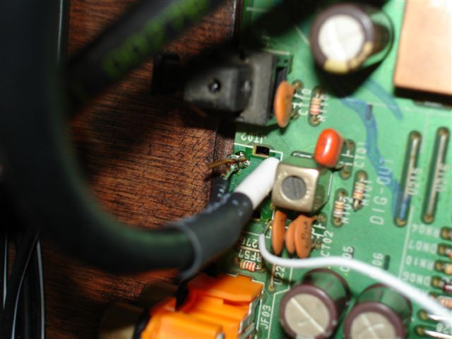

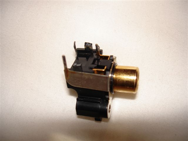

Further to my earlier post, I have rehoused my CD63 in a wooden case (thread following upon completion) with a DIY NOS DAC.
I have taken the spdif signal direct from the board (having removed the PCB mounted socket. I have taken the positive signal from the rear peg (fitted by myself) and the return from the front one. I have not used the other rear connection, which appears to be designed to be grounded to the chassis, but I have attached a lead to it if needed.
I cannot get a lock on my DAC (which works from an alternative spdif signal). Can someone start me off on my debugging route please?
TIA.
Michael
