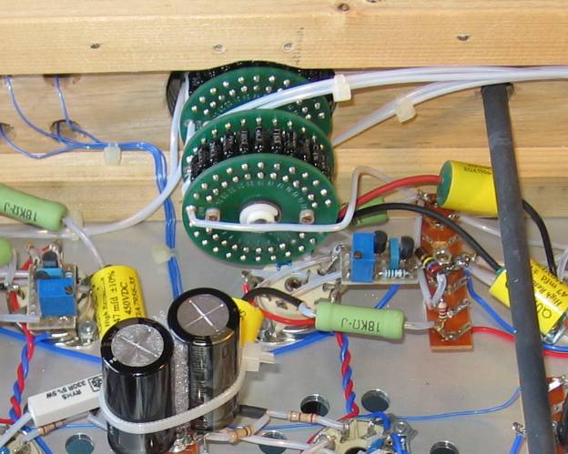

SimontY said:Ray,
Shoot me! I made an educated guess with the attenuater. I've tried a few pots and found so little difference I assume they can't sound all that different to a couple of resistors. Maybe I was being too simplistic.
No problem, mate 😉
The difference is the way all the pots are built: more or less the same setup with a wiper that 'scrapes' across a conductive track. A stepper-switch is a whole different approach: a (hopefully) high-end switch with gold plated contacts and only two cool resistors that make up a voltage divider. Sounds quite nice if I say so myself 😎
Ray

Hi Ray6h5c said:
Hi Jim,
The main reason for that is the Holcos are metal film and the Kiwames carbon film; doesn't necessarily have anything to do with the brand.
Ray

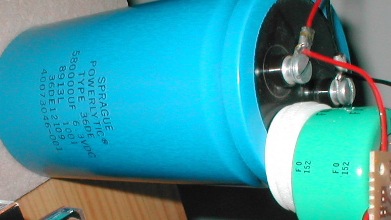

Just replaced the digital psu reg from 7805 1,0A 20W to LM340AT-5,0 NSC (412-703) Bipolar linear Voltage regulator type😛ositive Fixed +5v 1,0A.
This produces more deep bass with control... really good to feed my BIG Caps (580000uF Sprague powerlytic+470000uF NEC supercap+3600pF ERO KP1832 5% 1.2kv+2700pF NSF Styrofoam + 3u3 AVX Tantalum).
BIG difference..... Thank you for the precise info 🙂wiz:

RCruz said:really good to feed my BIG Caps (580000uF Sprague powerlytic+470000uF NEC supercap+3600pF ERO KP1832 5% 1.2kv+2700pF NSF Styrofoam + 3u3 AVX Tantalum).
Do you really need 1 farad of capacitance? I never thought I'd say this but... that sounds like overkill!

Well, since the choice is between 2W or 5W, it shouldn't be that difficult 😉. I get them from Percy Audio or Partsconnexion, both in the U.S.
SimontY said:Do you really need 1 farad of capacitance? I never thought I'd say this but... that sounds like overkill!![]()
Glad to hear your sound is still coming along!
Simon
Nah, it's that extra 2700pF that does it 😀
Ray
This regulator was really important.... I did not realize it before.
The BIG caps follow imediately and these where my first mod and the reason why I found this excelent Forum.
The BIG caps alone, give the player an enormous power in the bass and extreme extencion in the trebble (without distortion).
Adding the Schottkys and the new Reg did the Magic.... I am hearing good sound again...
Thanks to you all..!
Ricardo

RCruz said:Hi
In went the 470uH in the place of R122 123 508 511 around the servo and the decoder and........ LOTS of Low bass..![]()
Incredible.... can anyone comment on that ?? Maybe it is related with the Big Caps 😀
Ricardo
See the pic below... I mean BIG
