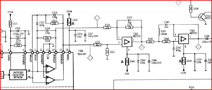

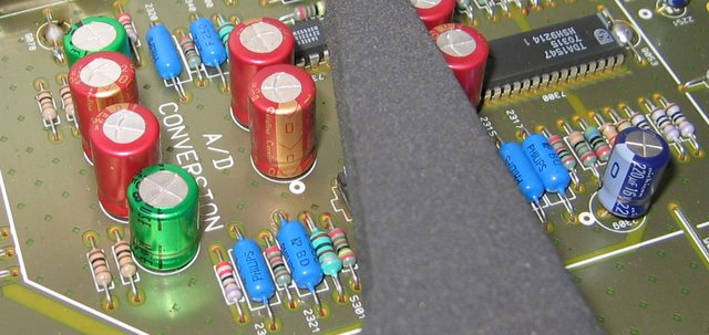

Busy playing on my new baby - a DAC7 Philips CD950 with CDM9/44 mech. Pretty cool in standard trim but there will be a Flea flying 'round soon.
So it's long time ago since I have heard the CD63.
avr300 said:Busy playing on my new baby - a DAC7 Philips CD950 with CDM9/44 mech. Pretty cool in standard trim but there will be a Flea flying 'round soon.
Hey, this DAC has external connections to the DAC's output pins
Excellent candidate for a passive filter + discrete output stage
Ray
Ray
Yes, it's made like this.

Are you going to try a passive filter for that Bitstream DAC, avr?
What decoder/filter does the 950 use?
Ray
Ups, sorry - assumptions is the worst thing.
Well, 1A each
SAA7350 -> TDA1547 and this http://www.diyaudio.com/forums/showthread.php?postid=1189840#post1189840
I really need to get hold of an extra for reference, either another 950 or a 930 before touching this - but it's not easy.
Don't hijack your own threat, Ray - must be what's referred to as threat-jitter.
Well, 1A each
