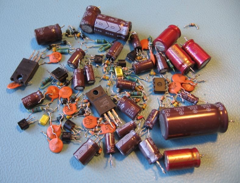

For those who want to konw how much work has to be according to Ray's list, even if many parts are missing ( some removed caps, you'll have to add some surface caps to bypass some other and more... ).

Malefoda said:For those who want to konw how much work has to be according to Ray's list, even if many parts are missing ( some removed caps, you'll have to add some surface caps to bypass some other and more... ).
And merry Xmas folks !!
Looks familiar 😀
Ray

marcusdeming said:
Hi Ray,
I see that alot of the orange colour bobs are removed. Are they the ones that are at the opamps area? What can we expect from removing them?
Those orange ones are ceramic. They do not belong in the signal path. Replace with silvered mica, polystyrene, teflon or polypropylene. You can expect a big improvement lol
If yours is SE or KI you won't have those in the output filter, they'll be mylar.
Simon
