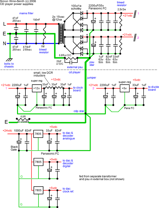

With this article fresh in mind does anyone have any opinions on the usefulness of making the ground line on the regulator boards extra thick? I assume the lower the resistance the less the problem. I could add a copper wire along all of it and solder it all up with lots of solder, reducing the "parasitic resistance" of the ground paths to something very low. That should reduce the noise.
Hi.
I think the lesson is that the regulator should be as close to the load as possible with the return to a star earth.
Andy
Hi Simon,
post 4589,
the caps before the regs and the reg 0v should each have their own grounding connections. That applies to ALL the regs including the 3 at the bottom.
It's all down to seeing that the rectifier and following smoothing caps are part of the charging circuit and that they need their own return loops to keep the buzzing out of the clean stages.
It helps if the smoothing caps and the rectifiers are kept in close proximity and with a very low loop area in the flow and return wires.
Similarly the transformer to rectifier cabling should also have a small loop area for the flow and return wires.
Is the cdp in it's own metal case? If so then the "E" should have a permanent connection to chassis. Again the RCAs should be isolated from chassis.
I see a note beside the 6r8. If you really want to experiment then add a switch in parallel to the disconnecting networks. This is often called an earth lift switch in commercial gear. I do not recommend you leave the switch closed. But feel free to experiment with it. Leaving two earth lift switches closed (whether in sources or pre-amp or power-amp) will create a hum loop and you will hear it. TRY IT and tell us.
Simon, The best ground wire you can possibly use is a flat braid as the main earth, usually you can achieve this by striping the outer braid of some RG58 coax for instance, slide a sleeve over it for electrical protection, and take it to your prefered earth. The resistance may look the same, however, to RF & noise, the resistance and inductance is a little better.
For strip board, you may fancy "weaving" along one strip so a wire is present on the top of the board, say spaced 3 holes apart, you then have access to the ground wire on both sides if its usefull. Comes in handy when experimenting.
If you are carefull, and neat enough you can also make a ground plane on top of strip board with the stick on copper sheild, just pop a neat hole sufficient in size so as not to short anything out for component legs, alternativly, just "wack" some ground strips in blank places if there is any room. Experiment as sometimes any extra capacitance may have undesired effects.

Thanks for the tips! I might have a go with that super ground wire at some point, but I'm not going to redo all the old ones.
I did a little unplugging last night and it seems my hum is coming from within the power amp itself, mainly. The cd player's noise could do with being reduced though.
Sounding good though 😀
Simon
Nice.
I did some more work today....
1 - removed grounds from each wire that feeds the reg boards from the external psu
2 - soldered a thick wire from the external psu ground star to the cd player's ground star
3 - added a disconnecting network of 8.2R and 22nF (in parallel) in line with the star to safety earth in the external psu
4 - cut the ground on each main reg board before the reg and made another return to a mini star point on the reg boards
5 - soldered good ground wires from each reg board to the cdp star
So, to clarify, there's now one "master" ground connection, which is the only ground wire between the cdp and external psu.
Objectively, noise appears to have reduced a little, although there is still a slight squeal and some broadband noise. There is hum, which seems to be a power amp problem (no difference with cdp connected or not).
Subjectively, the music sounds fantastic. Even more dynamic with a lower noise floor.
Black Gates to go in soon!
Simon
