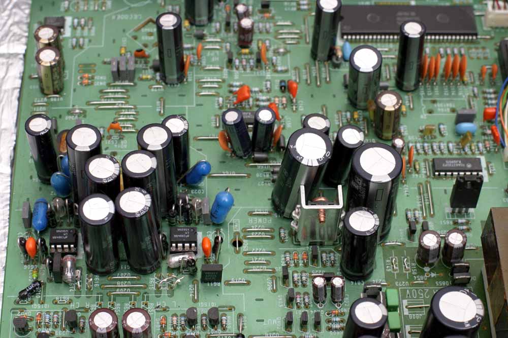

While I had the camera and strobe out to take naked pictures of my GFP-750 preamp mod, I snapped a couple of my CD63! Its a shot from the rear.
I used large value Panasonic FA electrolytics, and replaced just about every part from the dac to outputs and the HDAM is jumpered around. The decoder to dac resistors are Caddock mk132 in those boxes. The other boxes around the opamps are Vishay S102 resistors, also a bulk foil. The other resistors are Holco H4, and the capacitors are polystyrene. In the lower right, you can see Harris Hyperfast rectifiers and stock regulators. The clock is stock with a healthy power supply bypass. There are some ferrite beads on jumpers to decouple power and some ground
A front view would show a lovely pair ... of MKP capacitors standing up. They are hidden in the "V" of electrolytics. They are my DAC analog supply bypasses and at .47uf, were a huge improvement over .1uf caps I had tried before.
I'm open to suggestions on new exploits. Perhaps around the servo and RF amp sections? I'd like to keep the complications down and not add extra circuits. Mostly I want to keep it working!
Good work there! How about some Black Gate caps, even just one for the DAC analogue?
How about silver mica or polystyrene caps and precision resistors around the servo and RF and HF amps? This is lined up as one of my next mods for sure.
You could shield the logic and driver chips, and perhaps do some coax runs.
Beyond that you really need to add some separate regs to make it super-duper, and reclock it.
Simon
I would remove the head phone section if you dont listen to head phones, a nice waste of silmics otherwise.
Also you need a good clock and then work on seperate regs.Thats when the player really starts to push the realms of what this player can do.
