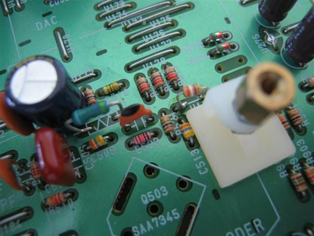

Well i killed my cd53🙁 Just finished all the mods to the analog stage and power supply. Put the player bvack together and it was playing fine and sound truly amazing the best ive heard digital sound! But aparently a peice of a lead that i cut stuck to the botom of the board and when i moved the player it short something out, first the laser was buzzing and hopping around like crazy and said error 12 then it just deid and keeps blowing fuese🙁 Anyone have a player they want to sell me cheap?? I actually just need the main board, I have a case from my 53 and the 63se I had years ago. At least i have lotsa extra parts, I now have two spare transports and trannies! but Im pissed cuz I had it sounding so damn good and a stupid little mistake and i freid it🙁 Im looking for another on ebay and theres a few 63 and 67 but they are a little pricey. Any other players that are good modding candidates?? Ive heard the Rotel rdc865 or 965bx are quite good, i think ther Dac is a saa7323?
Sorry for your misfortune...

imperfectcircle said:... aparently a peice of a lead that i cut stuck to the botom of the board and when i moved the player it short something out, first the laser was buzzing and hopping around like crazy and said error 12 then it just deid and keeps blowing fuese🙁
Just two thoughts ....
You've put beads on the 4.7 ohm / 0.25W resistors. Make shure they are isolated from the ground plane.
If not causing the trouble, next:
Remove the 4.7/0.25 resistors one by one to isolate the short. Go from there for repairs.
Jaap

It's even worse. On the 63 the schematics and the actually layout round the decoder is a mess. The scematics is correct according to the datasheets. Pin14 CROUT is connected via i 1M resistor to Pin13 - like they had planned a local resonator for the decoder. My silkscreen says RD14 or C521 - and there is a ceramic cap in this place.
U192 is factory replaced with a res. 390R
It's the same my CD53 and in my 63SE.
I'll lift the 1M and RD14/C521 and connect my Flea to this point.
Am I overlooking something here (just before I'll start soldering).

Well, without the 1M between pin 13 and 14 and the C523 from pin 14 to gnd, it won't spin. So there IS an incorrect between the schematics and the "real world" - because the schematics won't run!

avr300 said:The board layout in the manual corresponds to the schematics, pin 14 is NC - but not to the board in my hand.
In figure 26 (page 32) there are three oscillator circuits. It seems Marantz cut the costs of the extra parts by using the main clock. I noticed there exist several versions of the SAA7345. It might explain the 'freewheeling' RD14/C521 at the DAC for freedom of choice, possibly to correct a problem regarding input capacitance. See page 28 of SAA7345 datasheet for details on CRin/CRout.
Jaap
Yes, have seen it, but I just don't get why it won't run without the components leading to pin14 which is output 😕
1M + C523 to gnd - then it's happy. Not else.
