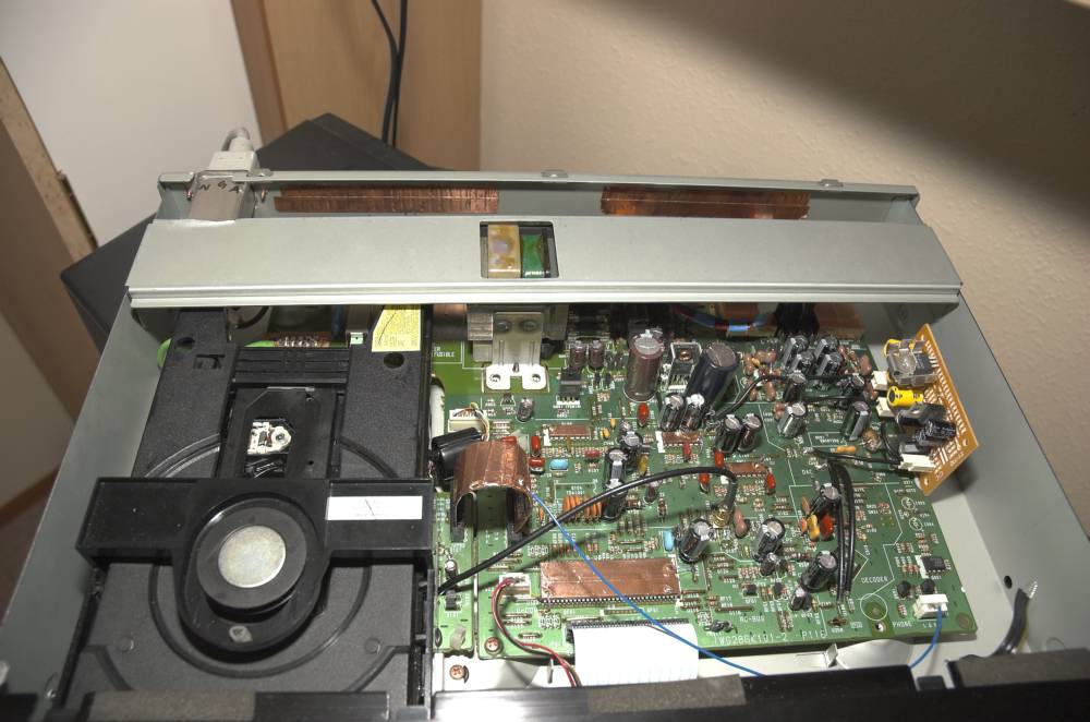

Re: Re: CD63 Logic Problem??
Hi Ray,
Thanks for your suggestions🙂. I'd love to have said that this was the cause, but I did not take out either C521 or U193 🙁. They are still original values.... all I did was replace the PCB track with coax. I cut the PCB track from U193 to C521 and put the coax in place. Any ideas as to what else it may be? 🙁
Thanks very much Brent.... something to check this evening 🙂 ...so there's still hope
I'll keep you guys posted...this one really has me stumped!
Cheers Guys,
Champi

6h5c said:Hi Champi,
Thanks for your kind words. I'm glad you enjoy this thread and got to modding your player again.
However, the latest event is less fortunate of course....
When you swapped the clock line for coax, did you take out C521 and couple the pins directly and put the coax in instead? The reason I ask is because when I was looking at it in my CD67 I noticed a DC component of about half the supply voltage on the clock-input of the SAA. That's the main reason Marantz put a 470R resistor in series with this line. In a CD63 I modded a while ago there was a 390R resistor in place of U193 and a series input cap.
Bottom line is: could it be this DC component has destroyed something? I noticed a fair amount of DC current flowing when I tried to lower the 470R resistor.
Ray.
Hi Ray,
rowemeister said:
Hi
Glad you like the mods. 😉
Your problem is not caused by the crystal.
To me its micro processor related. Check the 5V to the processor.
You may have a crack or dry joint in the pcb and this missing V rail or gnd is causing problems.
Brent
Cheers Guys,
Champi
