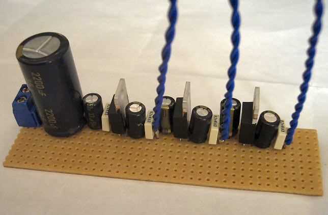

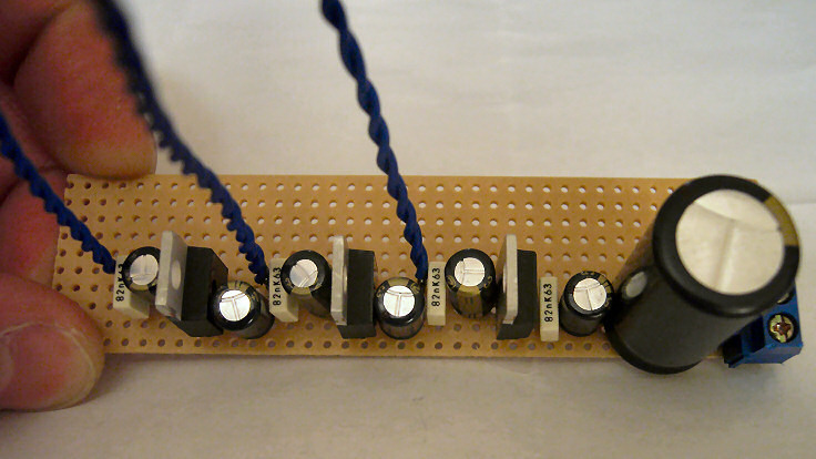

SimontY said:Run of the mill type thing to power the DAC: 3 x 7805, 2200uF/35v Pana FC, then 33uF FC before AND after each reg, and 82nF polyester after each reg.
Simon /enjoying the 25 degree heat!!![]()

rowemeister said:Hope it sounds good
Lucky boy .. to have all that nice test equipment !
Of course, you have a psu dedicated to the chip with star earth connection ?
