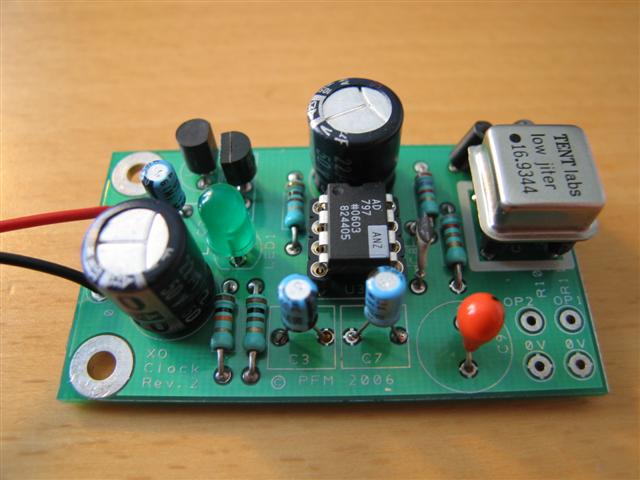

avr300 said:Ready to play!
It's fitted and the machine is up and running. But I have NO reference yet.
just play some music you're familiar with.
preferably accoustic tracks.
most important thing is, enjoy the music😀
allan
