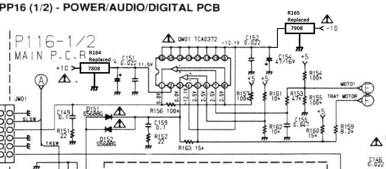

Hey guys,i wonder if i can remove R149/150,R127/128 from my cd63...i have allready short the fuses as "higlander" suggested.Do i gain anything in sound quality or what the benefits are.Do i have to remove those resistors or short them?
I love questions like this...........whilst I realise this thread is a bit long just to read through, its not a particularly intelligent question!!!
Read the 1st few post and there is a list of things to do which is still in most part a very good list. If you ask about things from this list you will get advise here from the guys. Also, download the service manual and find the resistors you are talking about the you will start to learn.
All 4 resistors are in the +/-10v supply to 2 or the 3 driver IC chips. The resistors that carry power to the 3rd driver IC are R164 & R165.
If you remove the resistors, there will be no power to the sled motor, laser, focus and radial so none of those will work!!!
If you short them out, then all of the devices will be directly sharing the same supply. The idea of the resistors is that in addition to some current protection, they help to keep the noise down on the rail for each device. A better way to do it is to use an inductor..................see Rays list, the pattern repeats on every psu rail to every device in the player.
An even better way to do it is to regulate the 10v feed at 8v and use a pair of separate regs (7808/7809)on each driver IC but that's a bit more tricky to implement until you know what you're doing but its well worth it 🙂

UV101,thank you for the info,but i did look on the service manual and the differences between 63 and 63mkii...so R149,150,164,165, are shorted with jumper wire.Am i missing something here??
OK I see where you are coming from as they are listed as mods in the KI version.
R149&150 are the inline feed resistors for Q106 which is the driver IC for laser Focus and Radial. Short them out and you will have the same as a KI.
R164&165 are the inline feed resistors for QM01 which is the driver IC for the spin motor and sled. Short them out and you will have the same as a KI.
The point of the resistors is explained in my previous post but they will serve to current limit supply to those IC's. Remove them and you remove as restriction in the current path which may allow the device to respond quicker to any changes. Like all things, there are 2 side to every story. Here its demand vs. noise separation on the rails.
I believe they are used originally for circuit protection and as such I'd just short them out.........
......as I said before you could also look at separate regulation 🙂
Something like this.....repeat for the other driver IC's
