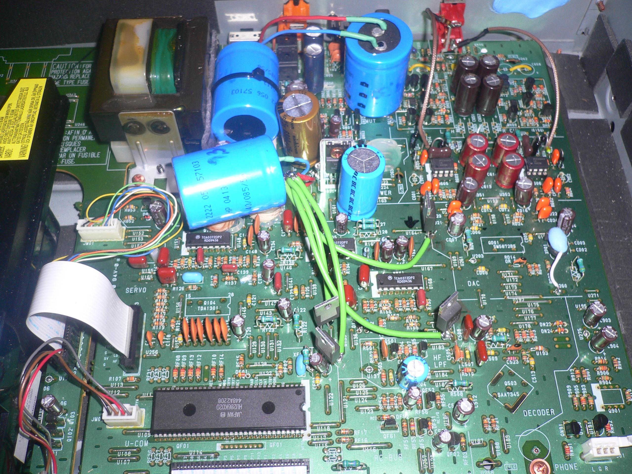

low level information increased but not as much as i want too.Any suggestions?
For starters, I'd say consider doing the following in this order:

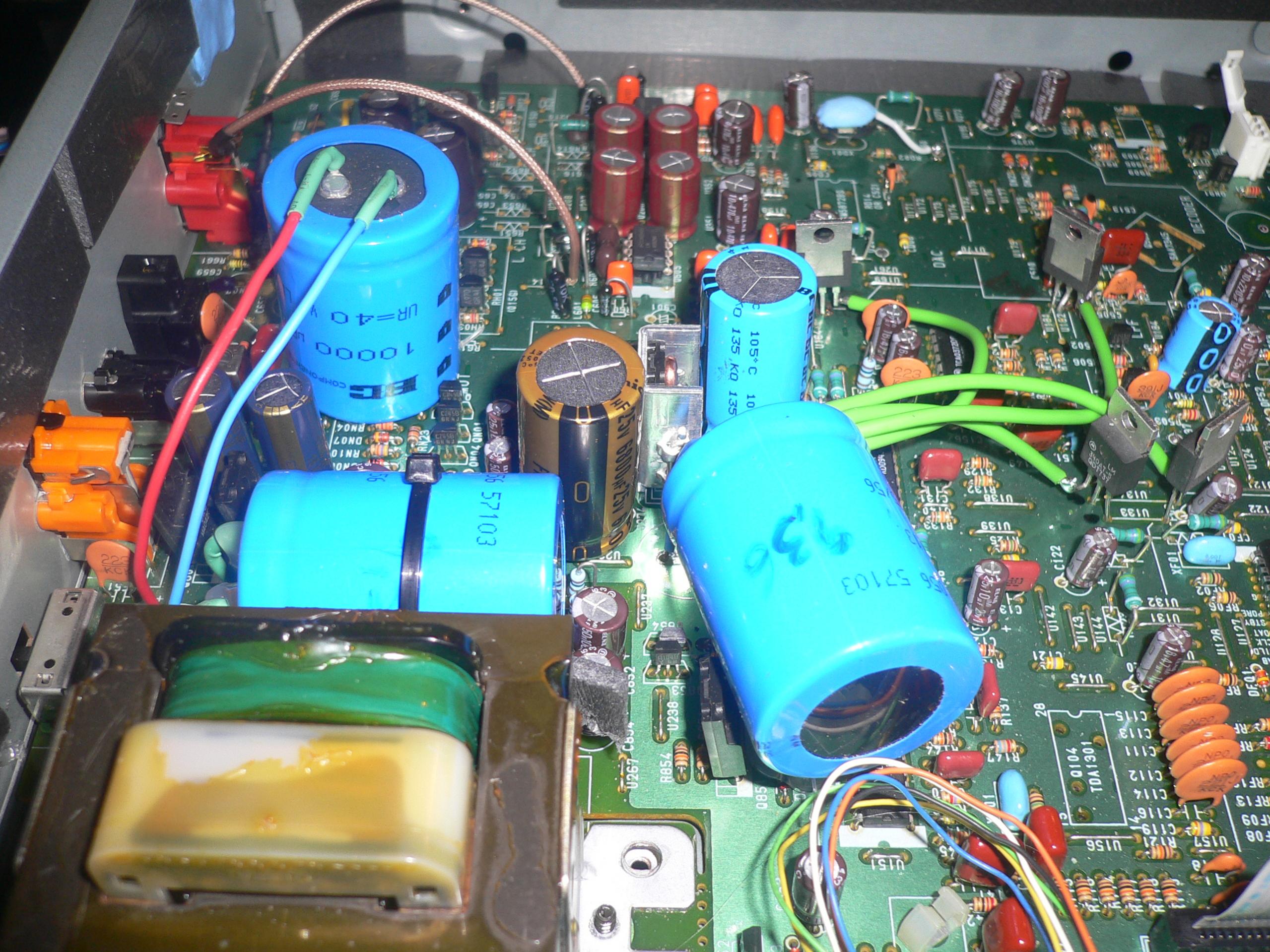

- Try to eliminate those long leads to your output stage smoothing caps, or at least get them shorter and of equal length. Have a look at the Mundorf AG / Fidelity Audio SI caps, which are compact and fit right on the board.
- Replace your standard transformer with 3 separate toroids for servo/5v, output and display. Details are abound in this thread, but you want at least 50VA for the servo.
- Regulate your driver ICs (wait until after the servo supply is changed so you can use 7X12s, or else you'll end up doing it twice like me!)
- Install low jitter clocks for DAC and servo with their own isolated power supplies.

Ben,those leds you are talking about are the brown ones?If yes,those are because of bypass the hdams so the caps been there are just left there.
Because budget is limited...if i do all these mods you suggest,which is going to be the result?I am asking because if all these mods(must cost quite a bit)and if kind of analogue musicality and been there in the event is the target,over the hyper analytical and accuracy of cd-63,i simply switch to my TDA1541 players.
We are not talking for better base or deeper base or empasize something over the other with these mods for the 63.
The big question is if it can be musical and analogue like as TDA.

P.S mundorf ag 22000uf 25v are the same diameter as the bc ones i have on now.If 10000 25v,yes they are 25mm and fit better on board.

I meant you have long wires leading to your output stage smoothing caps, which I believe will reduce their effectiveness. I imagine different length leads for positive and negative supply could potentially cause an irregular output waveform. The 22,000uF Mundorfs are short enough vertically that they can be positioned where the original caps went with leads of 1cm or less.
I haven't heard a TDA specifically, but I listen to a lot of vinyl so I think I know what you are searching for when you say you want 'analogue', particularly as I am also familiar with the harsh, unbalanced sound that the CD63 can make due to voltage sag.
The transformers shouldn't set you back much at all in the scheme of things, and the 7812/7912 regulators for the driver ICs are almost nothing. For your trouble you will get deeper, fuller bass, but also less over-emphasis of treble and associated listening fatigue.

Ben,i listen to vinyl mainly too.My record colection is over 4000 vinys and the oposite for cd's about 100.So the cd-63 is a project just for fun without me having expectations to sound as the vinyl.It never will,not just the cd-63 but any digital player.I am sorry to be hard but this is reality.
So back to the 63...you think that with bigger transformer JUST for the servo and op-ap's (i am willing to keep the 63 owns one for display)..it is possible isn't it?And you think that this harsh and nasty over analytical sound will go?

Hmm... I can't promise it, not knowing what you are hearing. I sometime A/B between the same albums playing simultaneously on my CD63 and turntable by swapping inputs. The difference in resolution and dynamic capability is clear, but there is no harshness. I've had that before, but that was because of 'bugs' in my mods at that time that were later resolved.
You swapped op-amps to LM4562, right? Did you tag a small (0.1uF) film cap across the power pins for stability?
You added regs direct to the chip supplies? Do you have adequate post-reg local decoupling? (e.g. 470uF).
What kind of op-amp power caps are you using? I found that rolling those made a big difference. Black Gate N were my favourites there, but they are out of production now. If you enjoy building things, there's always the DOS!
If you're willing to invest the time to go forward (or back - there's no shame there) then I think you have a chance to achieve a level of performance that will surprise you and won't always make you want to turn it off and switch to vinyl.
Yes they are 4562 and no i haven't 0.1uf across power pins...is that important?
Yes i did.
No i haven't apart the ones are allready on board on same track rail and they aren't 470uf nor they are all exist.
Today i try some ERO 100UF 35V 125 degrees celcious to see how it go.Not heard theM yet.BG not available any more plus silly prices.What is the DOS?

- LM4562 cap - I think it might be necessary for stability, dependent on other factors. I don't recall running without one for long. It goes diagonally between the +\- pins (4 and 8?). Under the board works.
- Op-amp power caps - I'm not familiar with ERO, but this is a very critical position for choice of cap. I wouldn't worry too much about a high temperature rating in this application, just nice audio caps. I think the KI used Cerafines there, or was it Silmics?
- DAC power decoupling is also a critical position for choice of cap. A lot of people use Sanyo OSCONs on the digital. I use BG NX. The DAC analogue supply decoupling is also very influential on the sound. The power supply to those pins directly affects the output. I prefer BG FK there. I think Rubycon ZA are a popular choice? (Help me out, guys)
I would say it's pretty vital to have good quality, decent sized caps after those regulators. Definitely get that sorted before looking at changing transformers around, as they just slow you down. You won't make the player sound worse by giving the DAC and op-amps a smoother supply with bigger and better caps).

Ben,mine had cerafine and i say to give a try on other brand.I use to had cerafine's on a kathode of a tube and the sound was harsh and thin.I did replace them with BC Philips and i see the ...light.Ok,different position different aplication...but who knows.
I don't have rubycon's at hand,i only have some BG FK 100uf and 220uf 16 and 50volt.They are not good for the regulators..... aren't they, plus that the 220uf are huge.So i better order some Rubycon zla form ebay then.
BG FK 16v 220uF would probably be great for op-amp power or DAC analogue decoupling.
Check the voltage on the op-amps though - might need to be higher.
Ben,BG 220uf are 50v rating they are huge and i only have 3 pieces.BG 100uf 16v i have 4 pieces.Which ones to use?
I would probably put two 220uF BGs on DAC analogue decoupling and the four 100uF on the op-amps. Maybe wait for a second opinion though... I'm not sure if 16v is enough headroom.
If you don't have a cap after any of your regs then I recommend putting one in.

Put 0.1 100v red wima cap on 4,8 pin of lm4562, left it burn in over knight.Well this morning it was the worst sound i have heard from cd-63.Sound became much smaller and dool.
Also change the red decupling cerafines for the op-amps with other brands....test with the wima on and without wima's.My opinion...DON'T touch the cerafines...i haven't try BG yet.Will see.

The 16V caps might be a bit thight. the rail voltage is usually 15 to 17 volts in cd players in general. If I were you, I'd buy a couple of 25V (or higher) caps to de-couple the opamps or lower the rail voltage to 12V.I would probably put two 220uF BGs on DAC analogue decoupling and the four 100uF on the op-amps. Maybe wait for a second opinion though... I'm not sure if 16v is enough headroom.

Using the 220uf caps on the analog de-coupling of the DAC is a good idea imho.

Try Rubycon 470uF ZLG or ZLH they are cheap and good smoothing caps for opamps. Also change the orange caps (120pF) with MKPs. They make a difference.Also change the red decupling cerafines for the op-amps with other brands....test with the wima on and without wima's.My opinion...DON'T touch the cerafines...i haven't try BG yet.Will see.
That doesn't seem right to me. I know I always go to this, but maybe you have a bad joint or broken pad somewhere that is getting disturbed when you remove the board.
I don't think that cap should've produced that result.
Please someone with LM4562 back me up.
