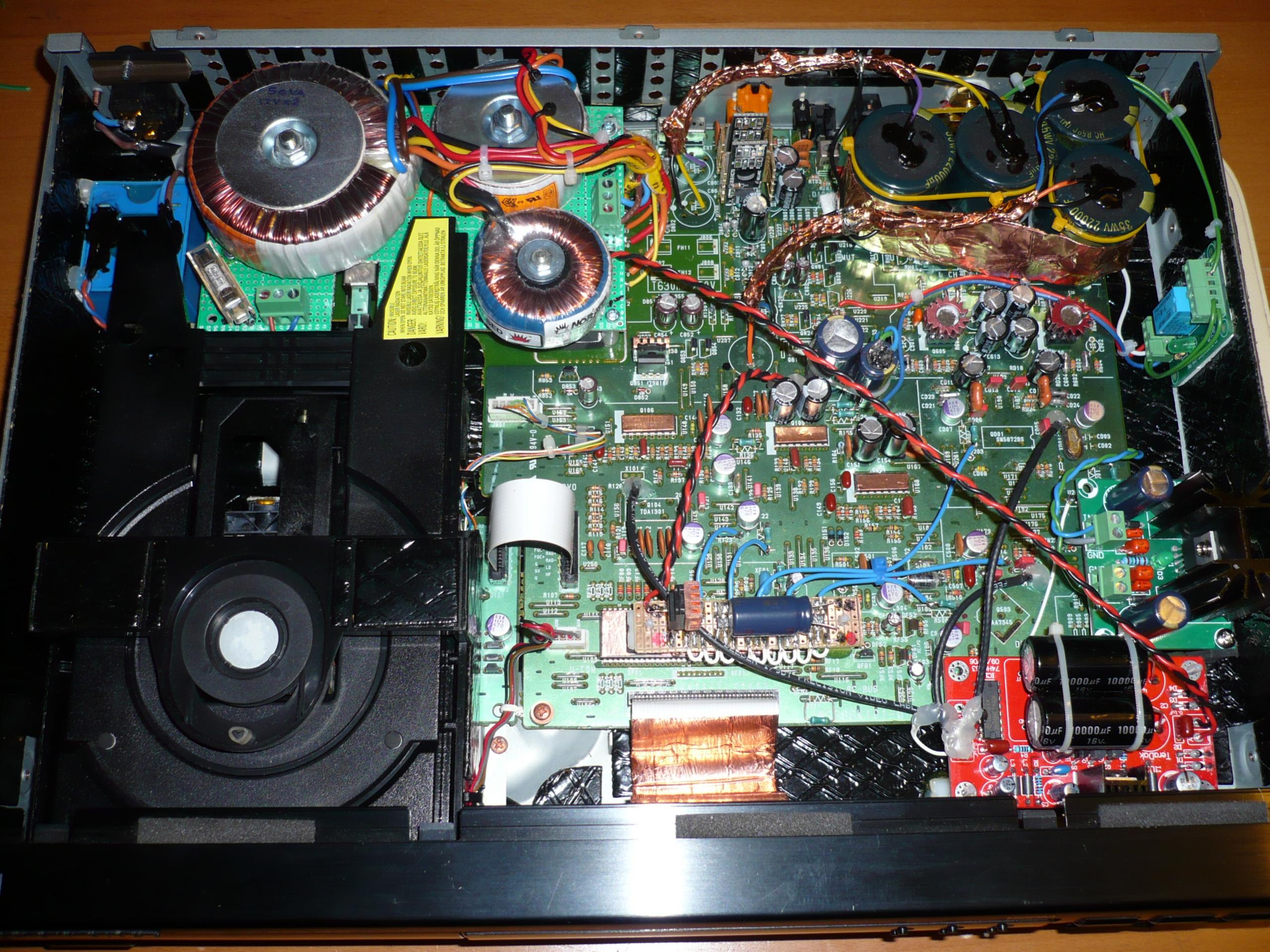

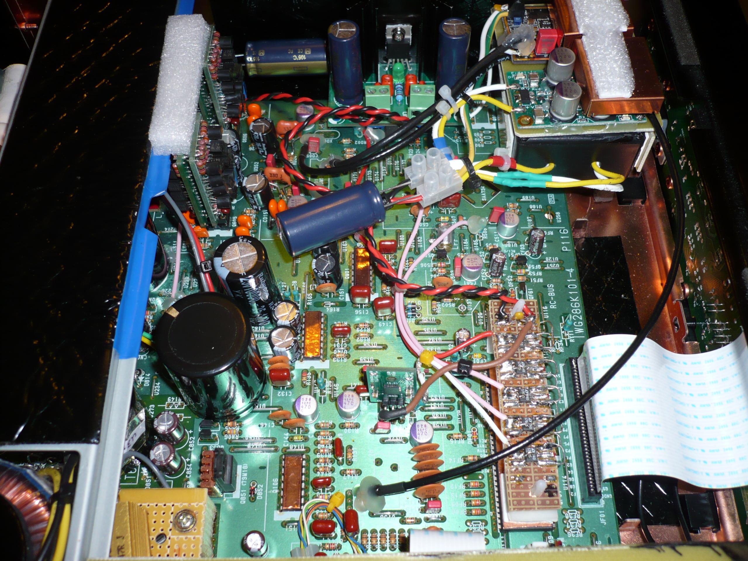

Last week I offered to tidy up one of my friend's CD63 that I had modded for him with budgeted components (this CD63 was the 1st mod I had made so the layout was not that good :eek:).
The first photo shows the initial layout while the 2nd one is the layout after I have made some adjustment to it. I also took the opportunity to change some of the caps for my friend. The SQ is smoother than before :p and my friend is really happy with it :D.

The HA opamps do run hotter and I've thought about using heatsinks to cool them a bit. Can't see it changing the sound though.
Looking at the player, you've done a fair bit of psu work but nothing in the output stage other than opamps. Change the orange drops to polystyrene and run the Bessel filter. Its worth doing :)
*my bad! I can see you worked in that area in the 2nd picture ;)

Yes you do have good eye sight. I did not do much as my friend has limited budgets :p. All the caps are my spare components.
Actually the opamps do not run hot they are about 50 C after long time running. As you said putting heat sinks on will not improve SQ but my friend requested me to put them on for peace of mind. They are my spare heat sinks.
I told my friend he could sell this CD63 and I will mod a better one for him using better components if he got more budget ;)
