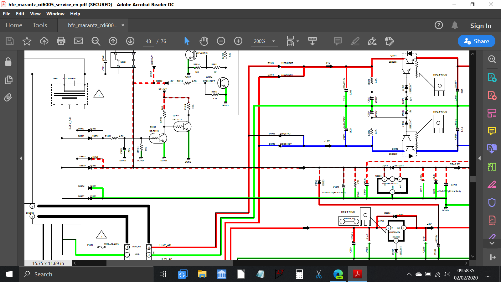

The CD6005 looks very similar.

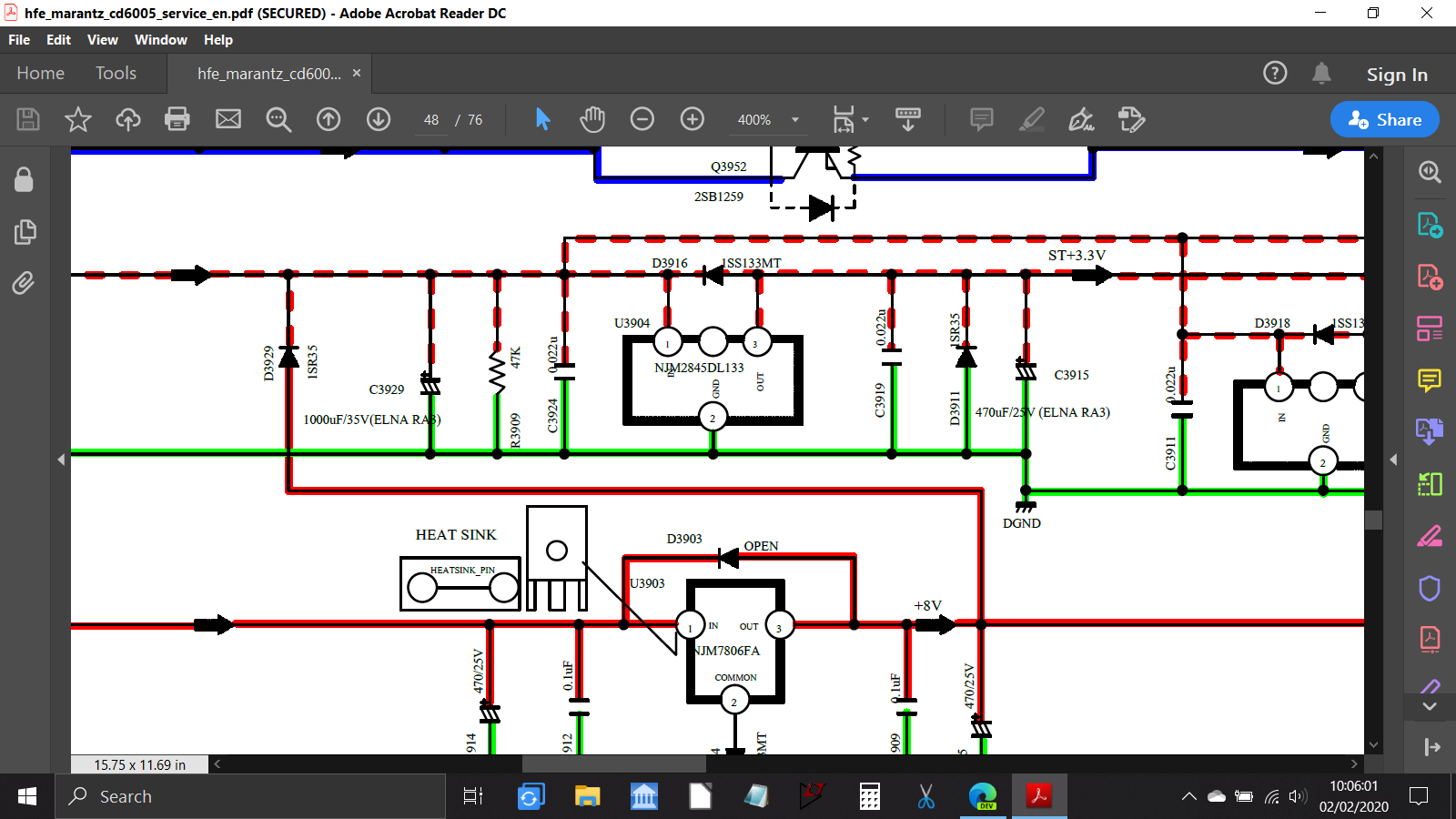

If you look at the diagram it shows that the rail from the standby transformer is over ridden via D3929. In other words when the main rails are up this diode conducts and takes over reducing load on the little transformer.
Is that diode OK and not leaky?
Check also C3929 and C3924.

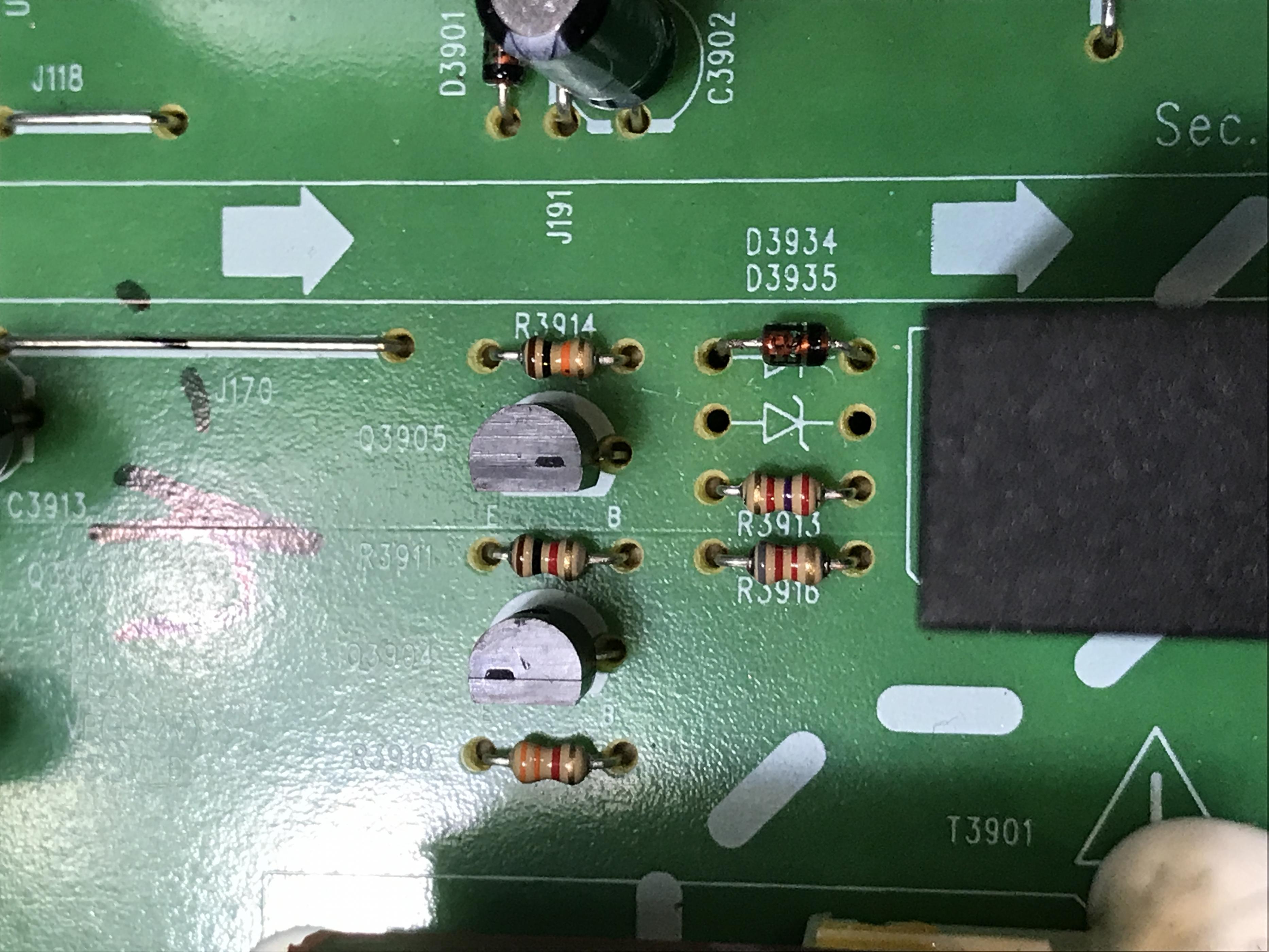

the 4 bridge diodes are good ,the relay diode there looks to be a diode and a zenner diode (D3934/D3935) but they both seem to test the same ? , when i said it works ok i meant the big transformer works ok , i didnt try to power the player on , i cant seem to find D3929 on my board .
the C3929 / C3924 , it is ok to have a lower esr than the charts say ? .

Low ESR is fine and mostly considered better.

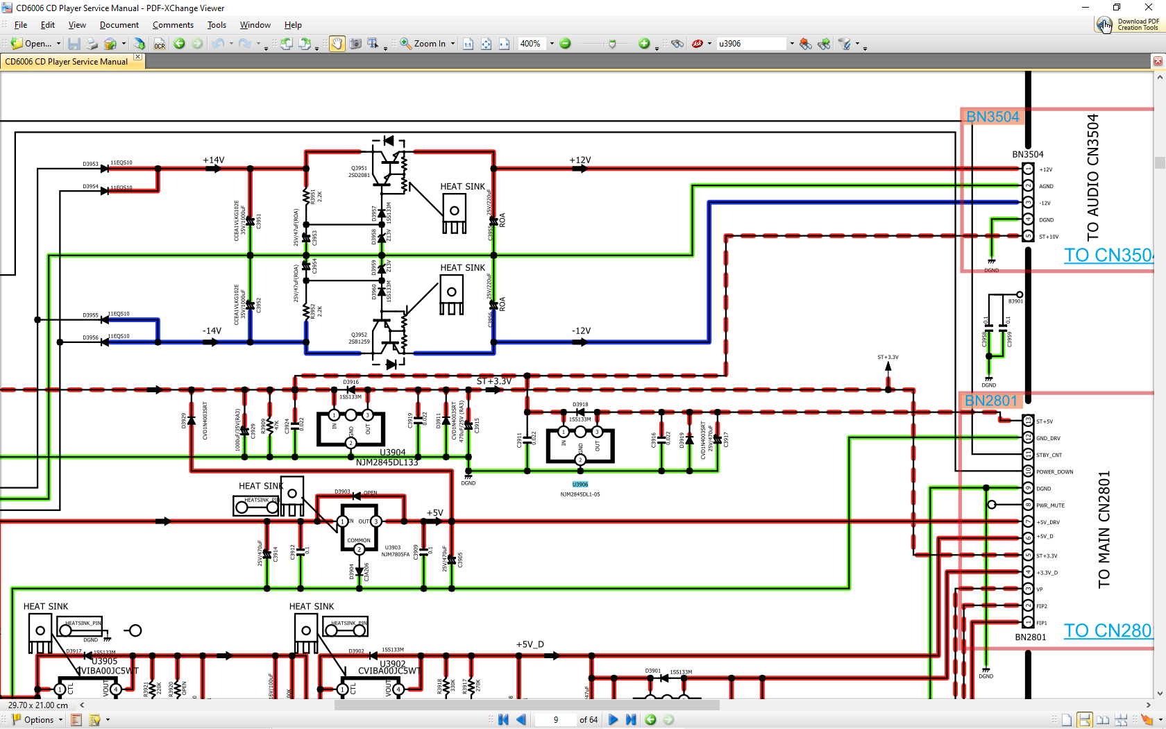

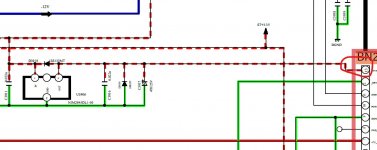

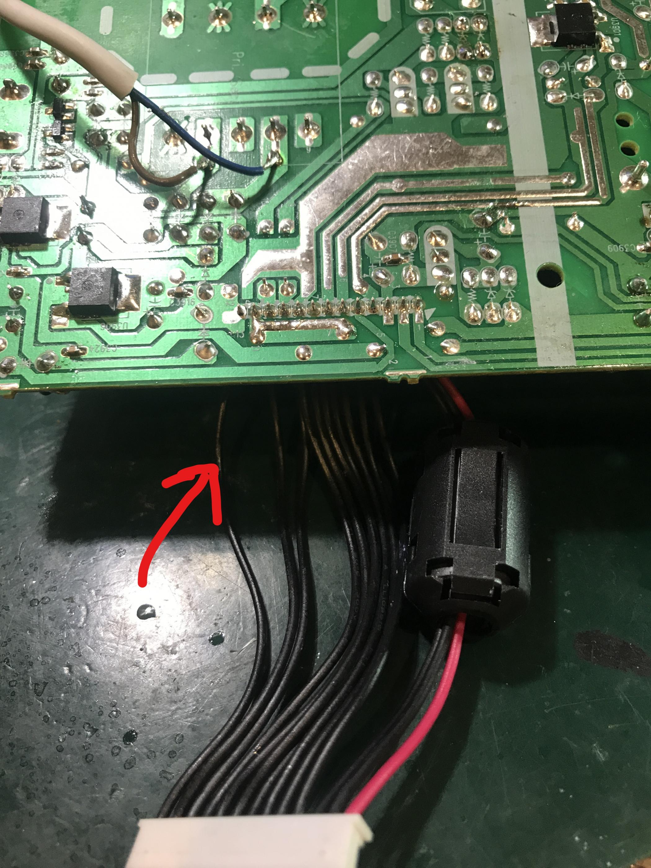

So if we assume the diagrams to be similar it looks like U3906 is an 'all time' 5 Volt supply.
You now need to isolate pin 13 on the multiway plug (check yours is similar though) and see if the 5 volt rail come up... or not. If it does then we have to look at everything fed off that line, if it doesn't then the reg or one of its immediate components could be faulty.
Process of elimination I'm afraid.

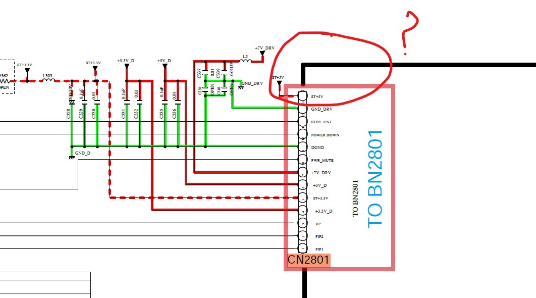

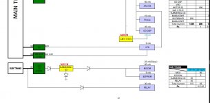

I'll have to leave this for today but the weird thing is that the circuit diagram doesn't seem to show where the 5 volt line goes...
The block diagram also seems to omit this 5 volt supply.
You might need to do a bit of physical tracing of where the line goes.
looks the same .
It does, but if you look at where it goes then it seems to vanish. Look at the block diagram as well.
when you say isolate pin 13 , how would i do that ?
Same way as you did the transformer... I think you figured it out
