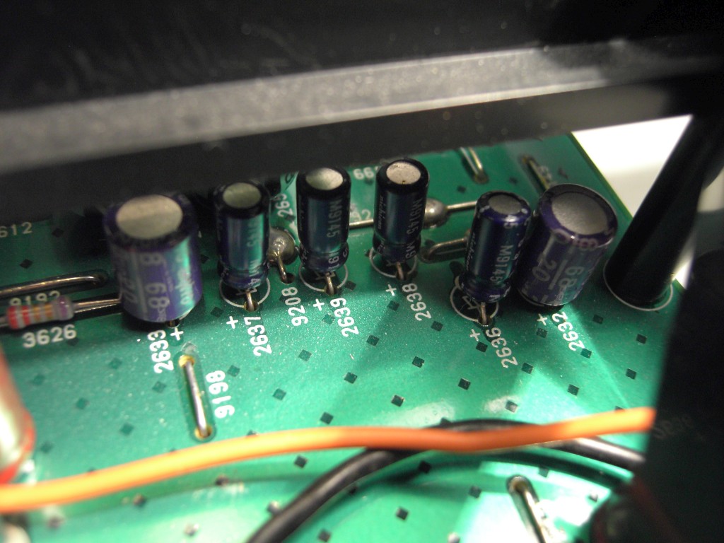

I then took out the 39pF caps from the DAC outputs. Huge result - loads clearer from top to bottom. The treble is now quite clear and the detail levels have jumped up! A superb and free tweak.

I've done the V-ref caps. Changed from nasty 10uF ones to 68uF Os-con SA. Seems better but I've not listened to the player much lately so I'm guessing here.

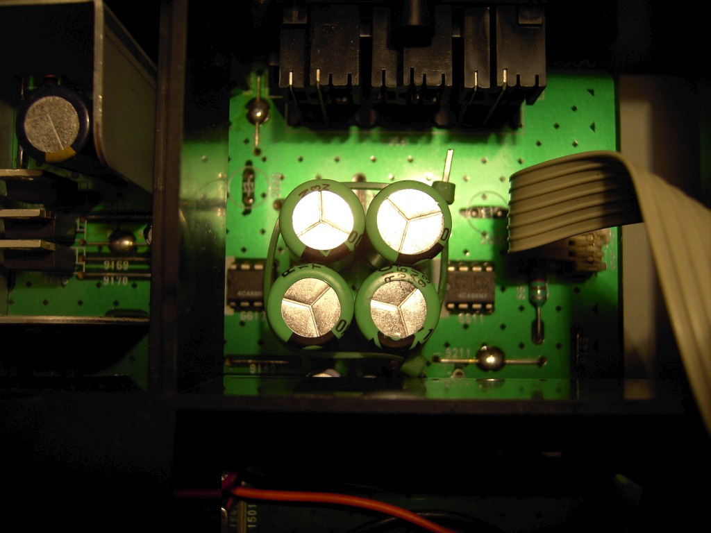

With the iron warm thought I'd also do the op-amp decouplers. They were 100uF caps. I've gone for cheap 1000uF/35V caps to see how that works. But now I've seen a couple more I want to change...

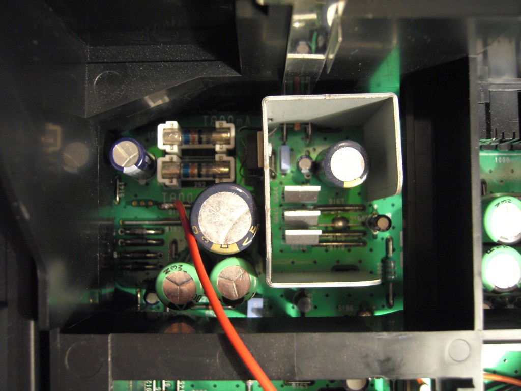

...as suspected the +-15V supply is smoothed before the regs by miserly little 100uF caps! Scrooge himself wouldn't go as low as this would he? I put 1000uF there.
Sounds better again, for sure 🙂

I've put schottky diodes in place for the +-15V power supply (output stage). This brightened things up but gave me a slightly brittle effect. I think that's what shottkies can do unfortunately, you take the rough with the smooth.

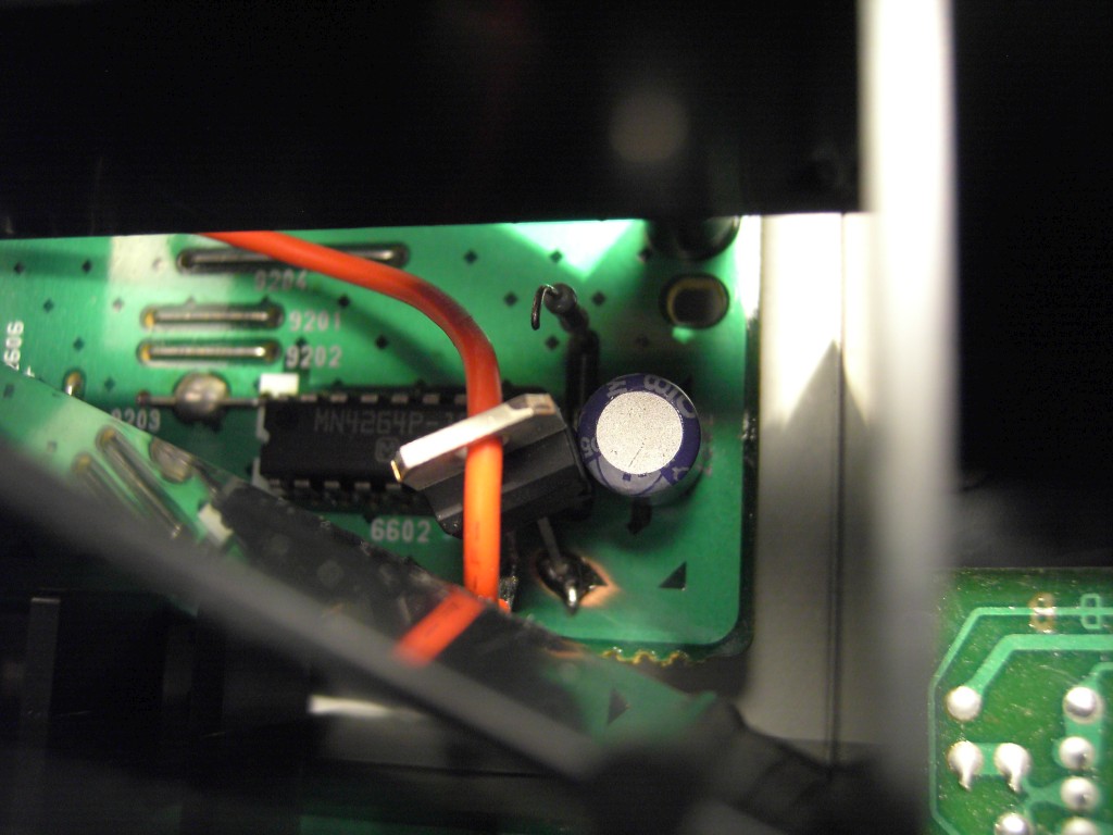

In need of further quality I decided to put the RAM chip on its own regulator - just a 7805. This seems to have cleaned things up quite nicely! The treble, in particular, is quite a bit better.
I'll get some pics soon. I may stop here as it now sounds quite decent.

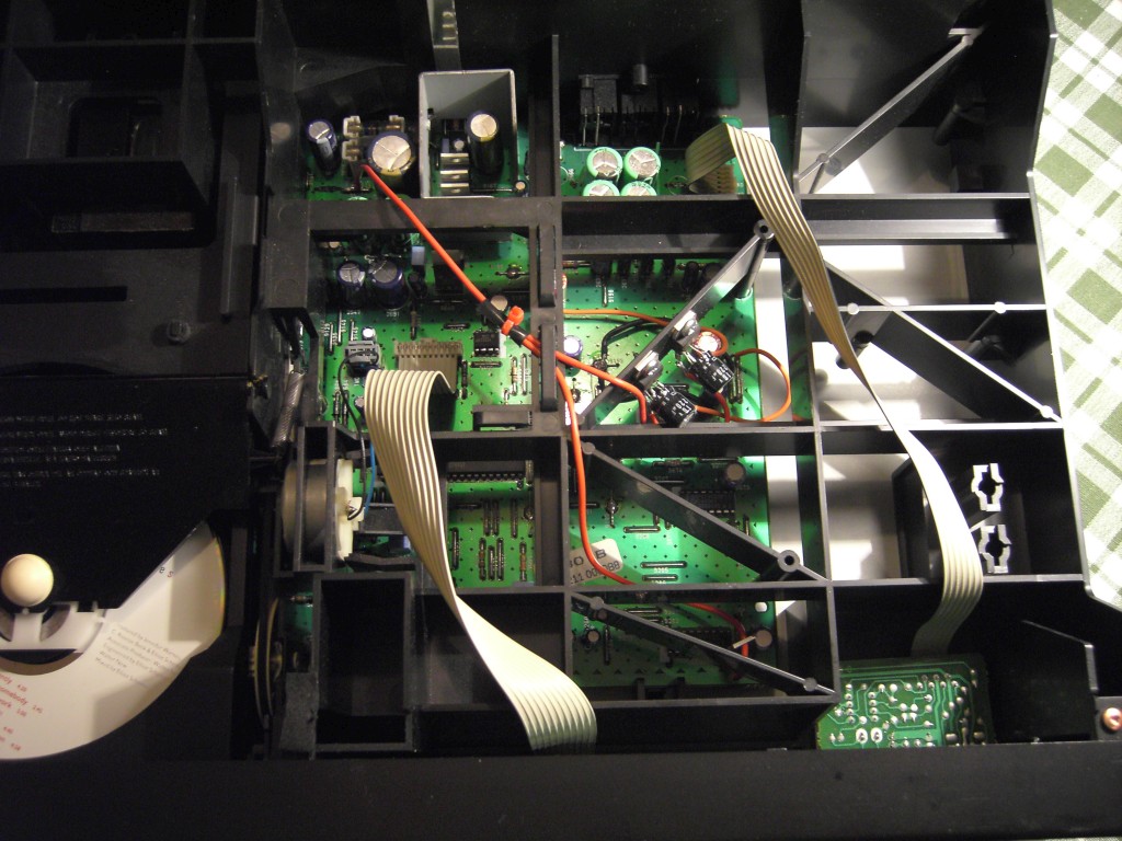

A few pics 🙂
Just a few final shots before I sell this player on. It does sound good now, but I'm sure it could use a nice clock and better power supplies.

I don't know about the sonic effects of improving the RAM chip supply because I didn't do a cap there in isolation. I may have done a reg and IIRC it got smoother but I don't well remember right now!
Removing the 39pF caps was DEFINITELY very positive.
