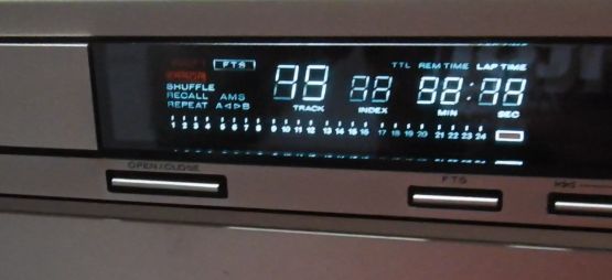

He then sent it to me with a note saying that other than the belts, he wanted me to fix the display which "used to work fine, but with all this handling of the player during the belt replacement attempt - it no longer does. All the segments are now lit". He does not recall doing anything specific that might have caused it.
it looks like this:
I have replaced the belts and the player now works OK but the display is still stuffed.
I am afraid to keep the player on for too long, because I have no idea if I will not blow it completely, given it has 30% more voltage supply than it should.
In addition, it is very hard to work on, because there is this "Feature Board" in front of the display and all the cables are short, so it is hard to measure anything.
Anyone has any experience with this or any ideas what went wrong?

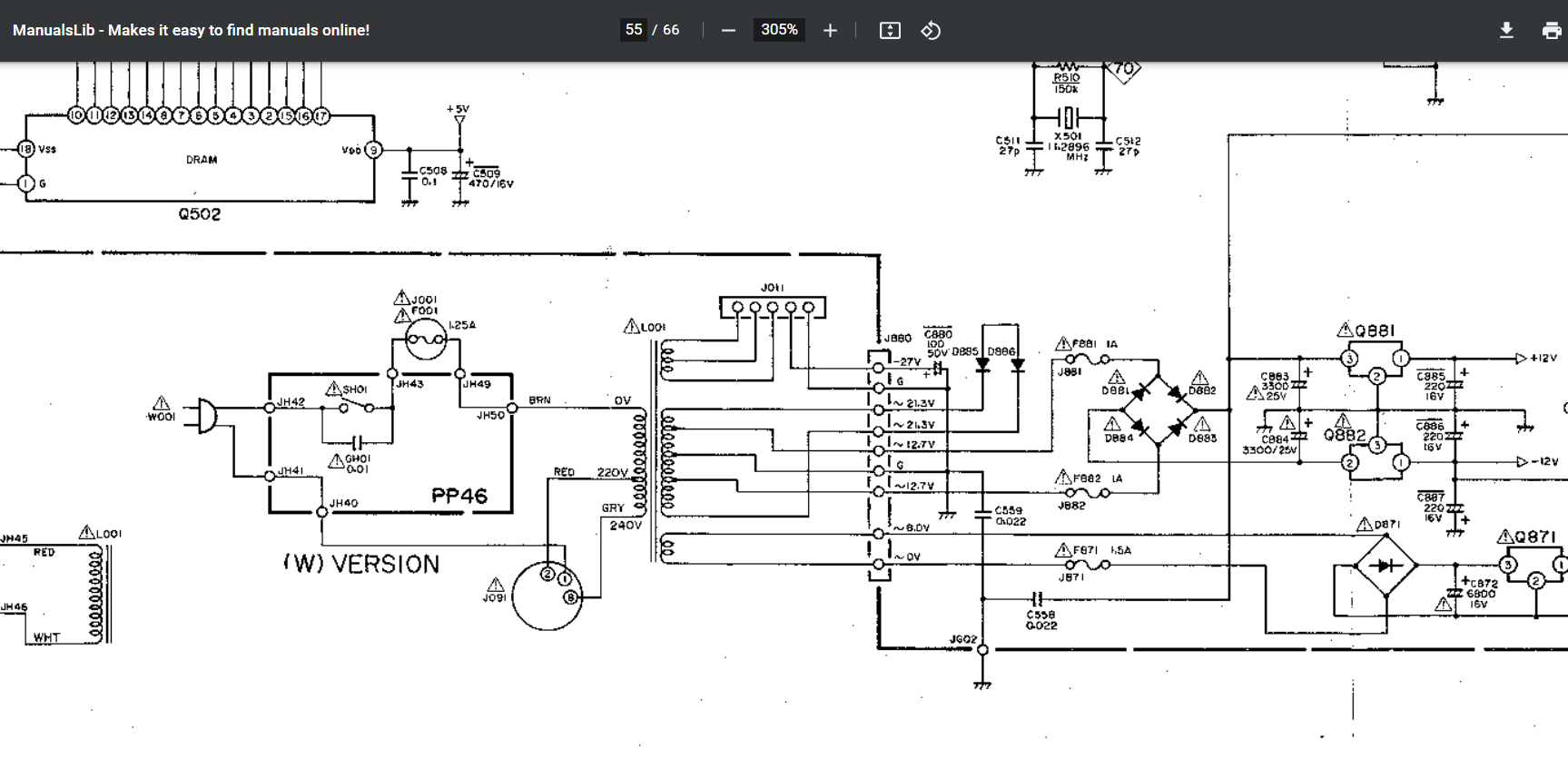

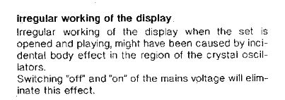

The service manual warns about the display issues and suggests... resetting it by turning it on and off and checking oscillator frequencies (all appear to be OK).

Looks like its may actually supposed to be -27v, etc.
Well, I did think about it and I did see the -27V on the other part of the diagram which you added.
But I could not find this C880 100µF / 50V capacitor anywhere on the main board. This is one of those differences between the diagrams and the unit I have.
From the (disconnected) transformer, I get 20V AC and it ends up to be -27V after rectification and with the help of smoothing capacitor.
But if the supply voltages are good (-27V and 3.2V AC) the problem then would have to be... grounding?

I've only quickly skimmed through this but it does all sound like a man made fault. It's hard to make out in a picture but your display looks to have a possible valid info present such as '14' showing at the right. The other segments look to all be lit because of incorrect biasing... but pictures can be deceiving I know,
Make sure that the filament is floated correctly to the negative 27v supply, that is done by the Zener and resistor at the lower bottom right in your first image. Make sure the Zener and that other diode are OK. They are typically around 4.5 to 6 volts apart (the Zener voltage) if my memory is correct.
The segments on a VFD normally light when the appropriate pins are pulled toward ground (zero volts) and they are off when taken to the same voltage as the negative supply.
