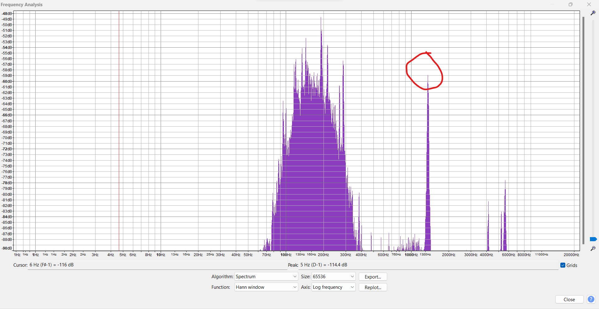

It sounds like the radial drive motor (the swing arm) that you can hear. Its hard to judge just how loud it is in reality but the Philips RAFOC does make those kind of noises and particularly when jumping tracks such as going to the last track on a disc. In normal play mode it should not be obvious though.
This is what you are are hearing (this is your player) and the noise is centred around 1300Hz

1300Hz, that's twice 650Hz and isn't 650Hz the frequency deliberately injected into the radial servo, with the tracking error waveform also at 650 Hz. I think that is what you are hearing

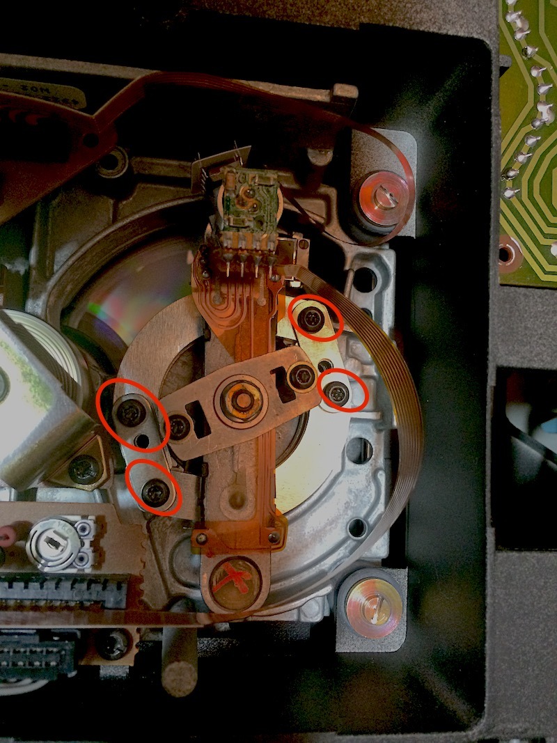

Hi, i had the same problem with a CD204 , fix it by tighten up bolts on the CDM-1

Its a mechanical resonance from the swing arm pivoted coil. There is a cap parallel to the output for demodulating the servo output which gets weak. The cap has been changed in value of the production run. You need to increase the value slightly as well as the filtering choke in series. Some players didn't have the coil, only the cap. Its a bipolar electrolytic. Don't remember the size.
